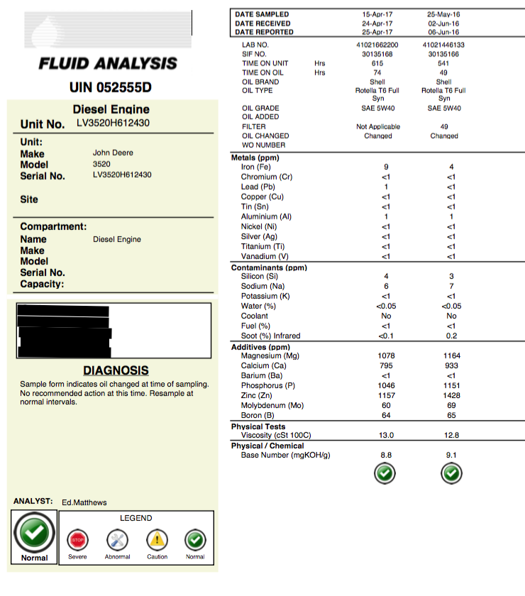

I felt the same way about leaving ANY kind of oil in for a year. So I took a couple oil samples and realized the additive package is very much alive and well. I feel good about it now but I'll continue to take annual samples for a couple more years and see how things average out.
i think the 74 hour sample was in something like 11 months but it will give you an idea how the additives held up.
