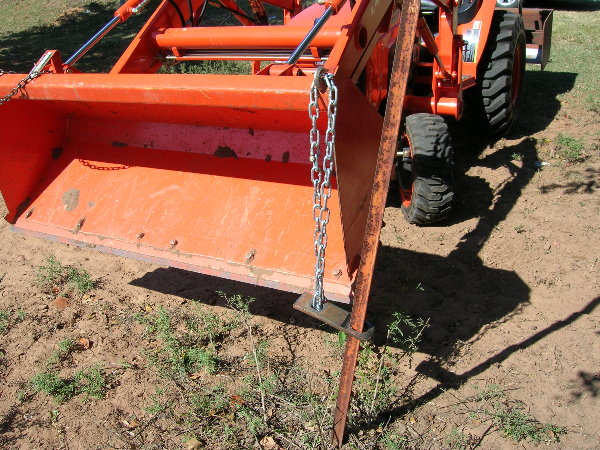

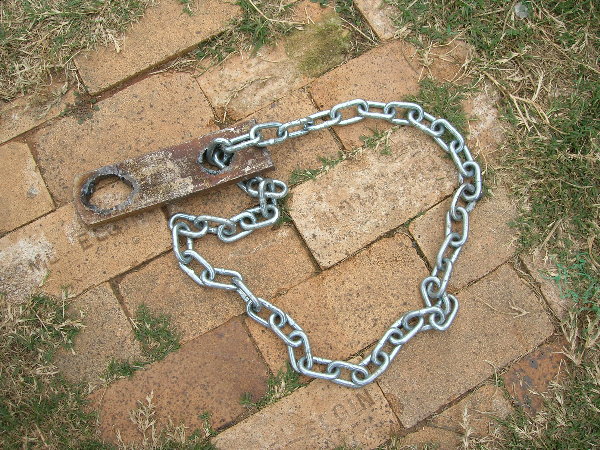

I made myself a T-post puller today to use with my tractor. It worked like a charm so I thought I would share it. I'm sure I'm not the first to think of it, but it might help someone.
I just slide it over the post about half way down and hook the chain to my bucket hook, then lift.
It is about 3/8 inch thick. I made it from an old trailer hitch that I had in my metal pile.

Great idea. I bet if you elongated the large hole and put a slight bend inthe middle you may be able to laso it on the post using the bucket. Then use one straight length of chain instead of a loop.

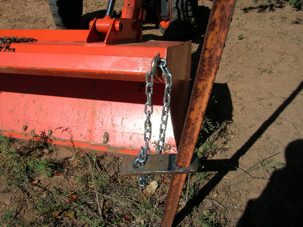

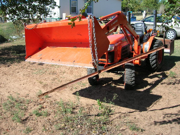

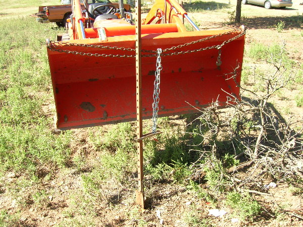

Ok, here are some action photos. I just put the bucket down beside the post, slide the gizmo over it, and lift.
Some of those posts in hard clay want to tilt the tractor a bit, so since I don't have a center hook yet, I just looped it through the chain (see last photo) to center the resistance.

I have done about the same thing except I use a very short length of chain and hook to center of curled bucket.
