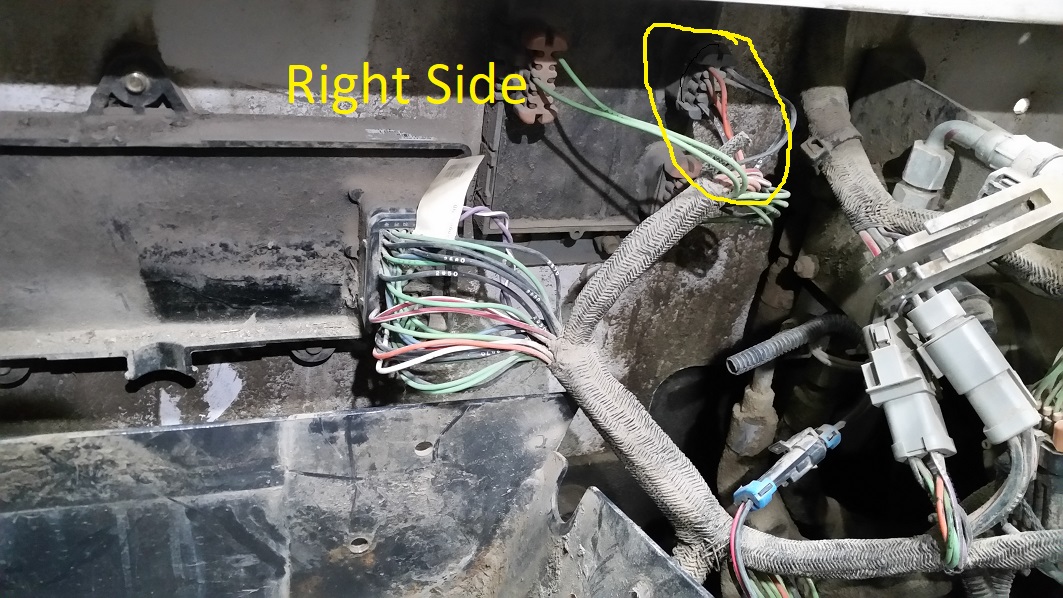

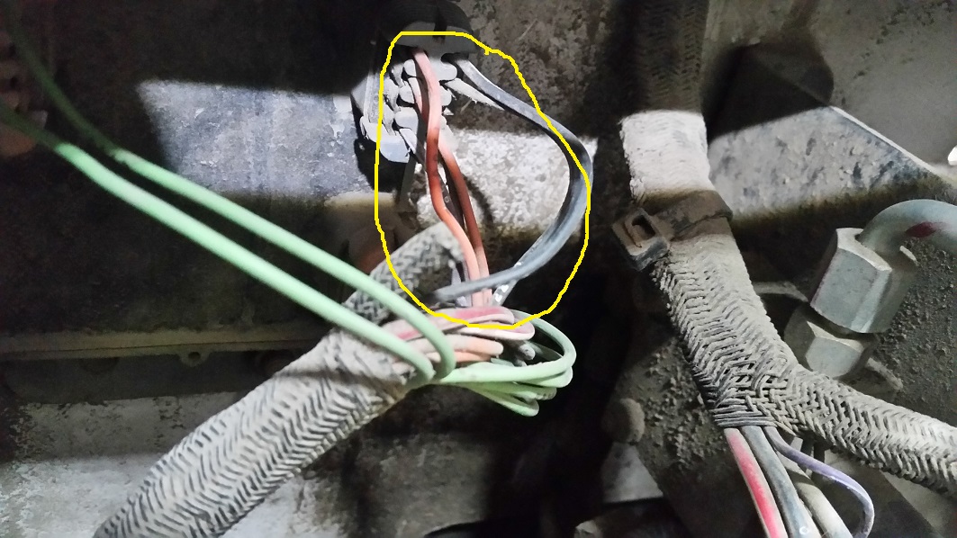

   / T190 Code 32-65 foot and hand controls won't unlock
I know the fuse box in front of the seat has one of the fuses. Where is the other one located?
   / T190 Code 32-65 foot and hand controls won't unlock #6
They are all in the fuse box. Fuse #10 is the 10amp attachemnt and fuse #12 is the 25 amp ACS.
   / T190 Code 32-65 foot and hand controls won't unlock #7
The #1500 is orange and can be found on the right side of the unit(T250). There are lots of comments on the web about the wire number but is hard to find the location. Hope this helps for the future. #1500 Wire wideview.jpg
