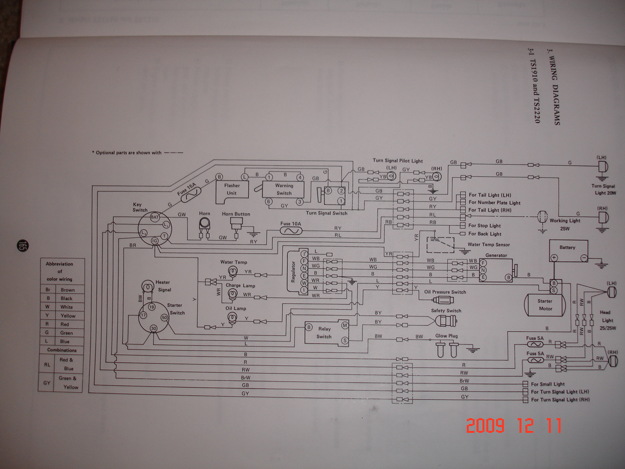

Dec 10, 2009 / T2200 wiring diagram #1 B Brianfg New member Joined Dec 10, 2009 Messages 3 TS2200 wiring diagram I am in need of a wiring diagram for an Iseki TS2200, can anybody help ? Last edited: Dec 10, 2009
Dec 11, 2009 / T2200 wiring diagram #2 L larso1 Gold Member Joined Sep 30, 2002 Messages 414 Location So. Colorado Tractor Iseki TS1610F 4x4 Here's a diagram for a TS2220. Should be close to what you need, if not exactly. You may need to zoom in a bit to get the detail tho. Attachments DSC02889.JPG 562.2 KB · Views: 3,113

Dec 12, 2009 / T2200 wiring diagram #3 DennisArrow Platinum Member Joined Jul 4, 2003 Messages 766 Location Sugar Valley, Ga Tractor Iseki TL 2300, Kubota RTV, Kubota B7610 Have you looked up at the inside of the hood?.........My TL2300 has it there.......Good luck......Dennis

Dec 12, 2009 / T2200 wiring diagram Thread Starter #4 OP B Brianfg New member Joined Dec 10, 2009 Messages 3 Thank you, It was there all the time. Only 1 problem, its in japanese
