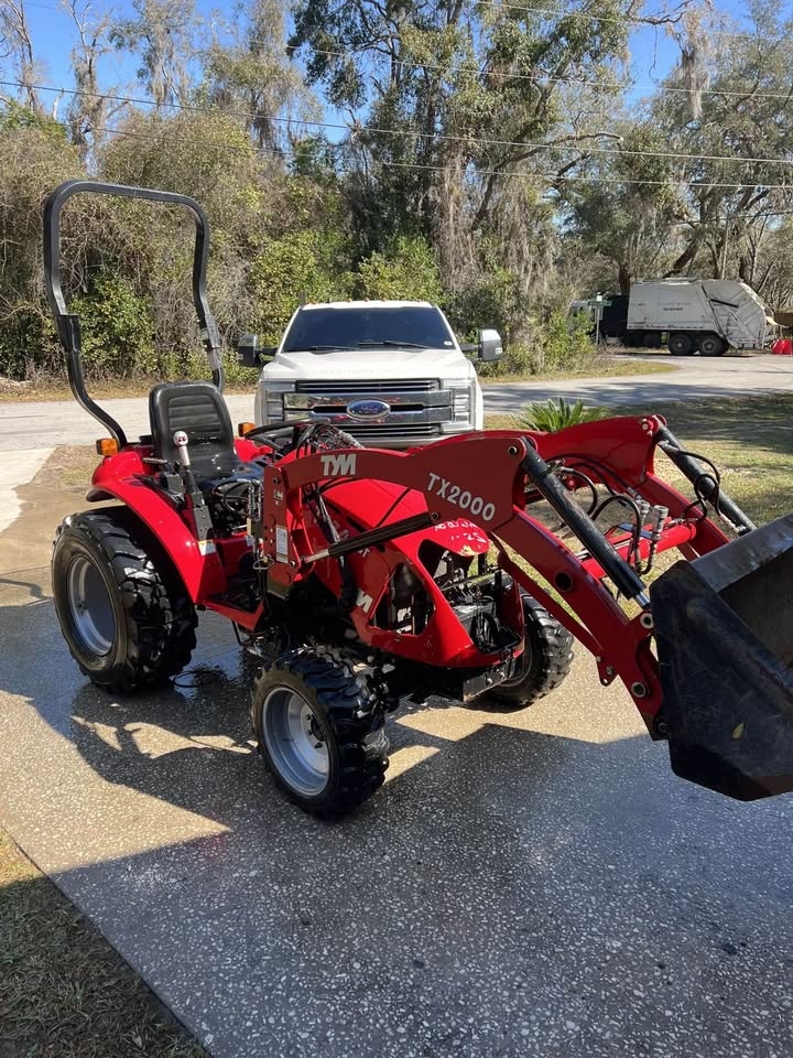

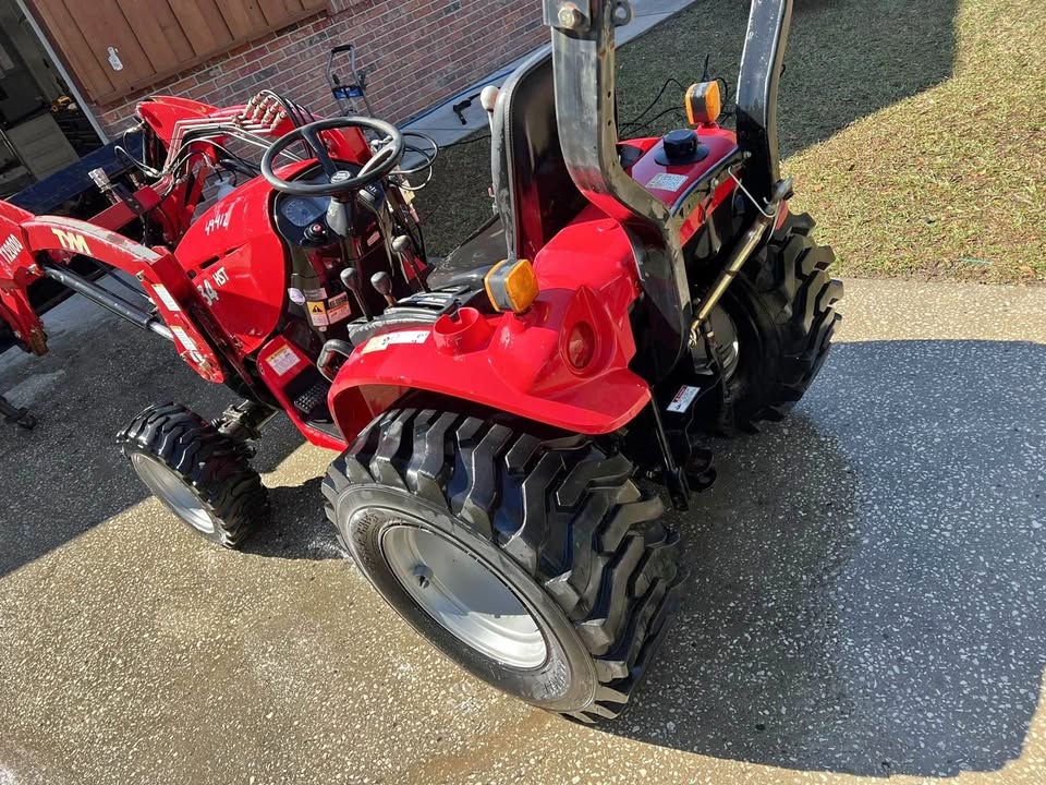

I see on Tractor Data that the T254 has less lifting power, weighs less.
T264 is s/a T234 but all have different engine, Yanmar, Mits, Kukje.
Same tires size.
My thinking is buy a used one for more then half the price of new with same features as T264, 1907lbs, 1380lb FEL, Mits motor.
Only concern is 6.7 total flow is this enough for 3rd function.
8k for a 2017 T234 with 285hrs makes sense to me, am I missing something?
   / T234 Parts & Service manuals #14
It'll take a 3rd function with no problem, just keep lift capacity in mind. If you're looking to put a grapple on it- be sure to put some protection on the front! You don't need a rogue stick or branch punching into something important. Also, a lightweight grapple will preserve more of your lifting capacity.
