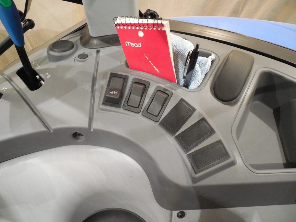

Hey Guys,
Have any of you found a source for switches that fit our tractor? I've been looking
and it looks like the only way to get one is buy another windshield wiper switch and
black out the picture.
Thanks
   / T4.75 Accy Switches
#2
I finally found some that were close at Granger, I'll report back when I get them.
OK,
Been a little under the weather but we wrapped up the tractor this week, the switches I got from Granger
fit the T4.75 perfect, nice tight fit and no trimming.
EATON Rocker Switch, Contact Form':' SPST, Number of Connections':' 2, Terminals':' .25" Quick Connect Tab - 21EV19'|'84K23N1V2 - Grainger
Here is a shot of them installed.
   / T4.75 Accy Switches #4
What are those switches operating? Extra lights?
I am using them to control the camera's power. I've got a high and low mounted cameras
on the rear of the tractor.
That switch with the little tractor on it is the factory 4 wheel drive switch.
   / T4.75 Accy Switches #6
I was curious as I have a t4 as well, nice additions for sure. Thx
