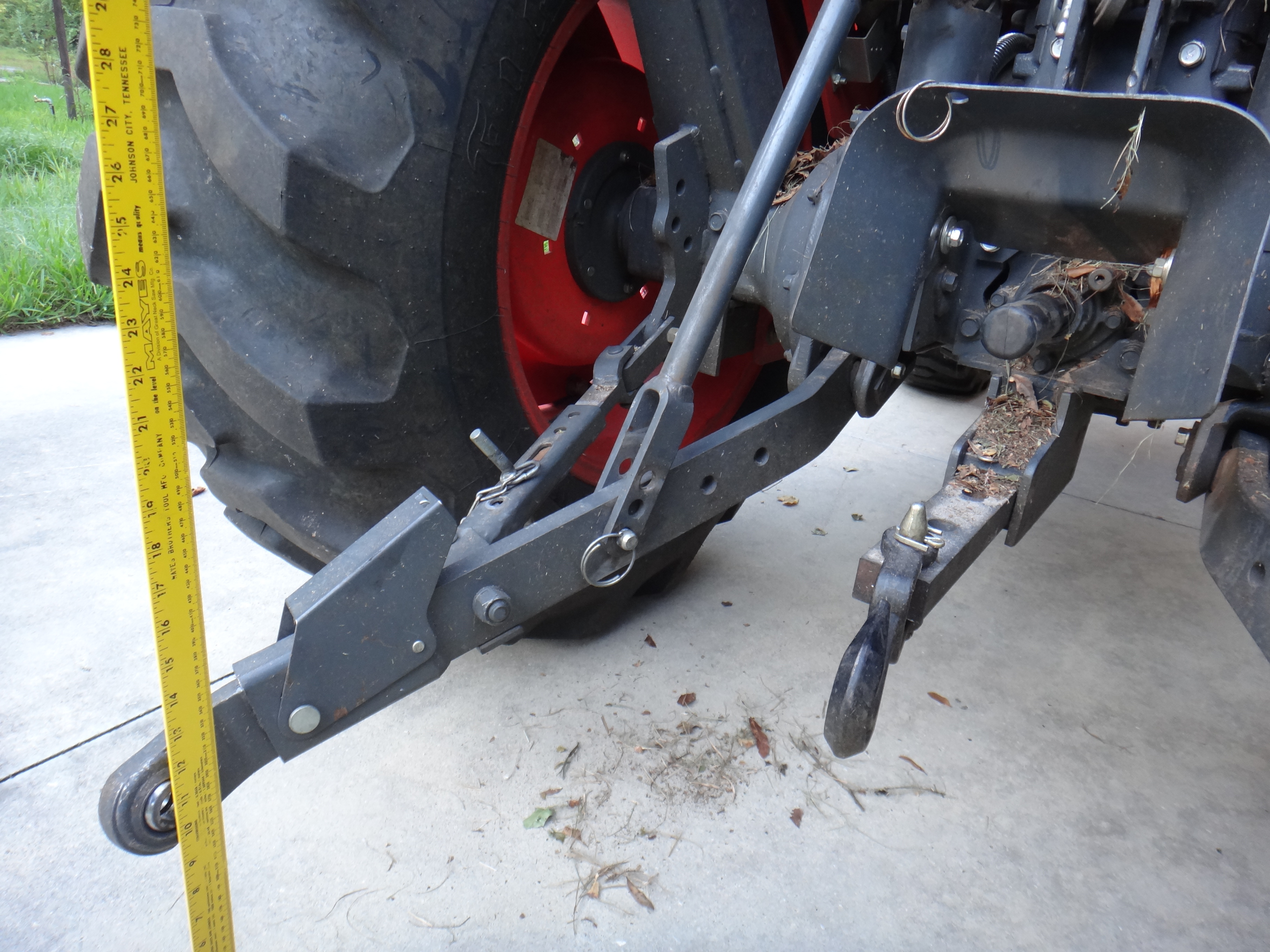

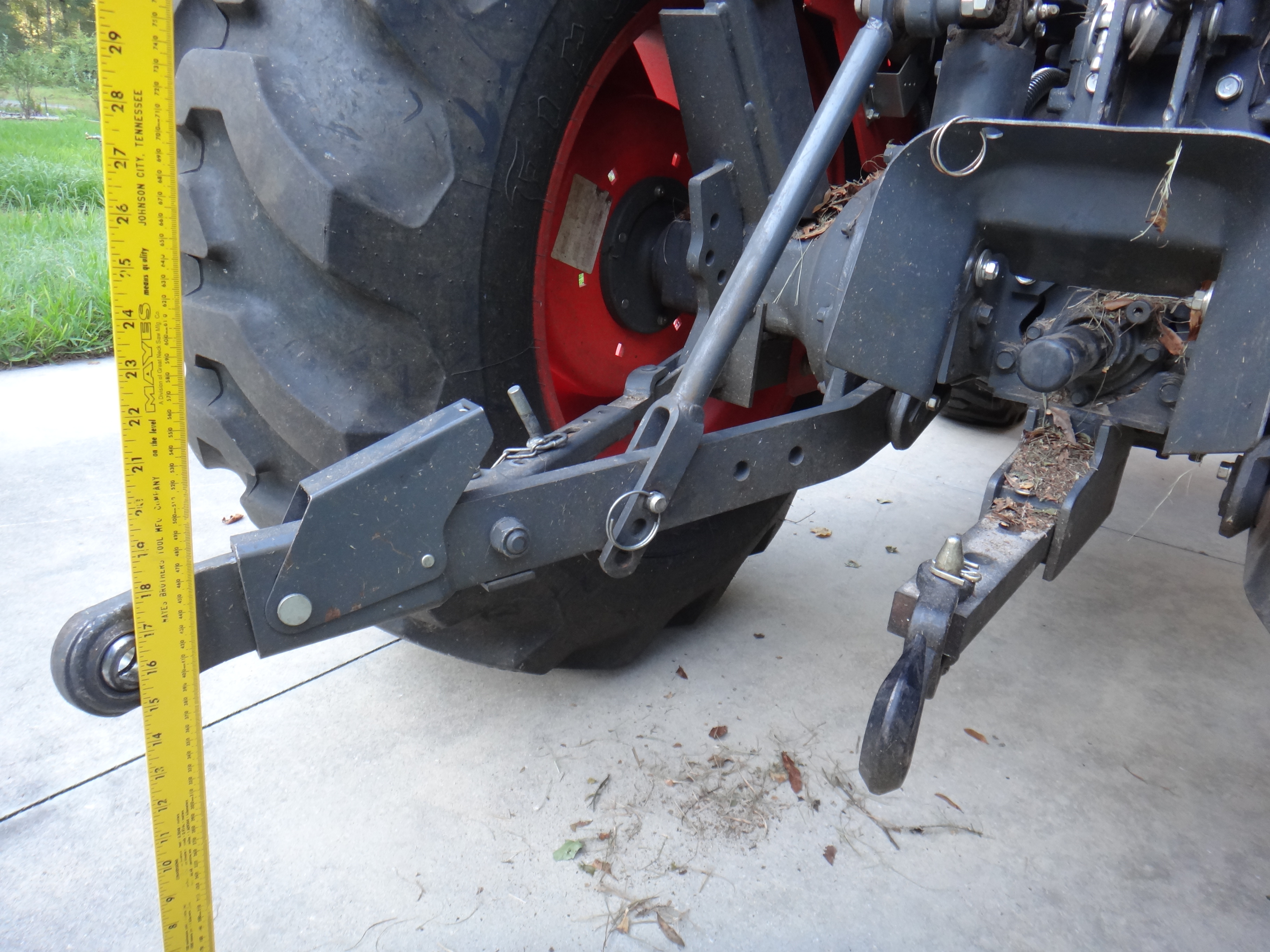

Also has anyone adjusted the 3 pt lift height, with our snowblower on the quick attach I only have 7" clearance
where the DX60 with the same setup was over 12" raised?
Move the pin adjustment on the right and left side Lifting Rod stirrups from one of the lower holes to one of the higher holes.
HIGHER HOLE = HIGHER LIFT.
See photos.
As far as the lift height is concerned change the inboard end of top link position attachment point on the tractor.
Good idea too. Another "move the pin to new holes" adjustment. Changing inboard Top Link position also changes gross sensitivity of your Draft Control, if installed.
