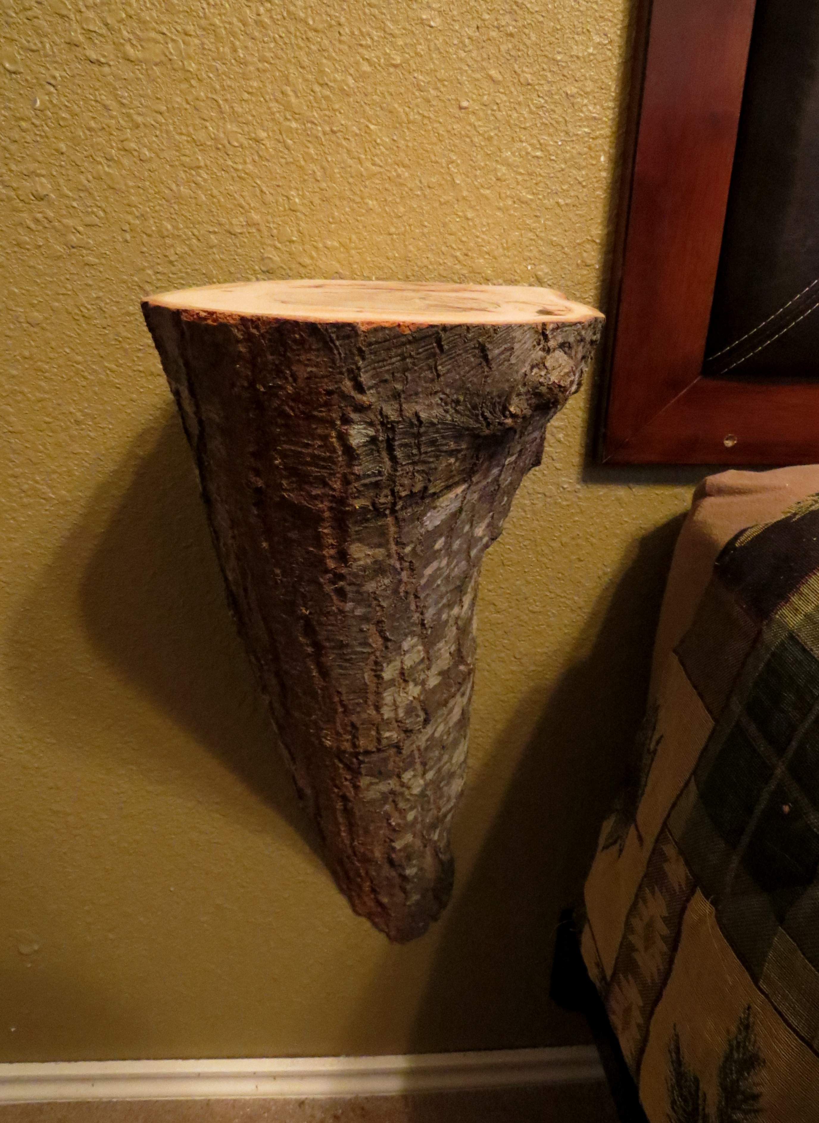

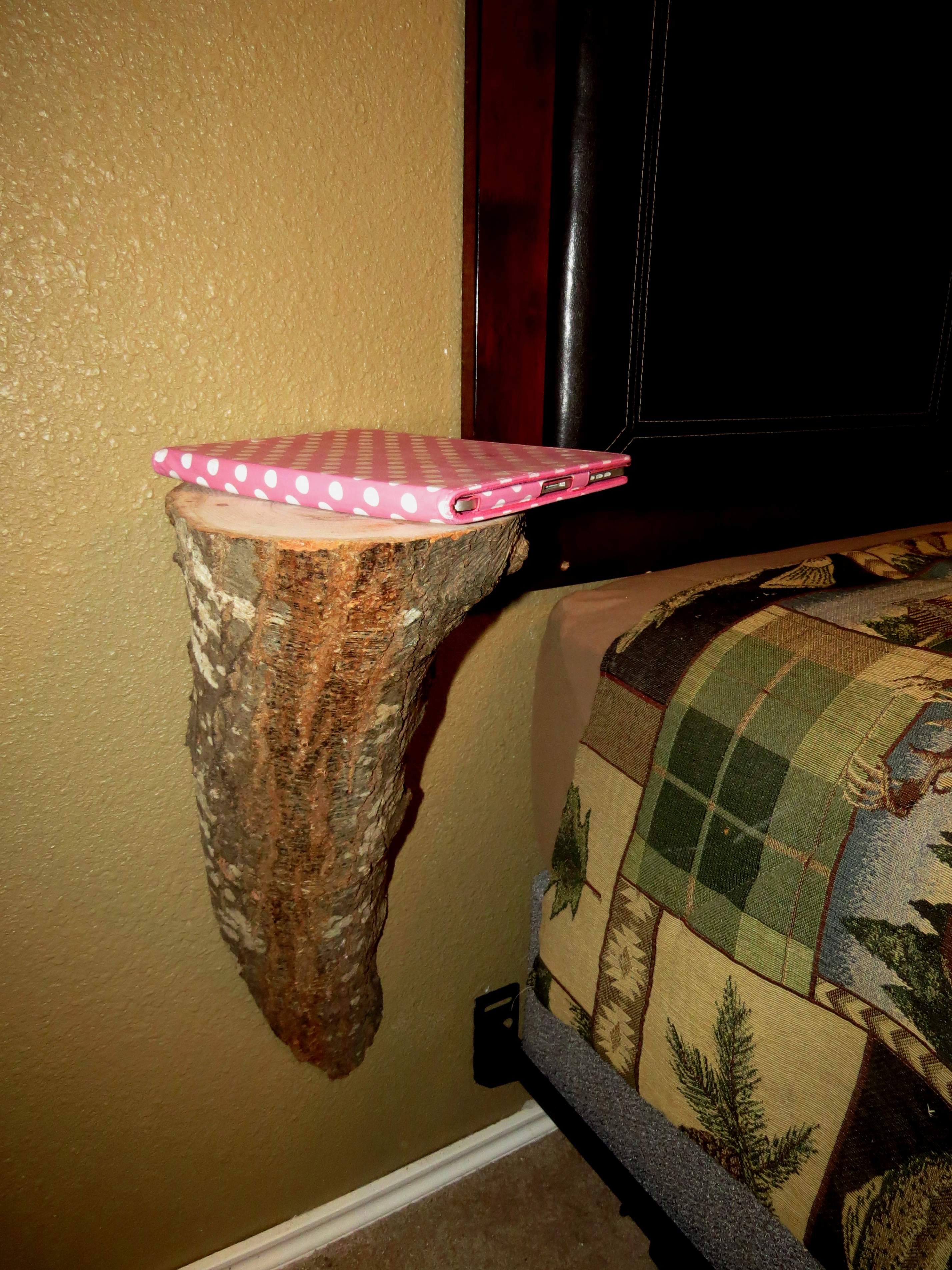

I've been working on clearing my fence line and some of the oaks that have come out are good firewood. I don't need any more firewood, so I have a stack of oak trees that will eventually get cut up into firewood. While looking over the trees, I saw that where they forked, one branch would go off at an angle and get smaller quickly. I used that part for the bottom of the table and the thicker portion of the fork for the top. I just laid a framing square on top of the log to get it lined up, drew the lines on the long and then cut it with my chainsaw.
Once we decided how high up she wanted it next to the bed, I measured down from the top an inch and a half to where the first bracket was. The stud was off to the side a couple inches from center. I screwed in two #8 sheetmetal screws into the stud 12 inches below each other. I used a forstner bit to drill out the shelf so the screw head would fit behind the piece of metal I used for a hook. That's held in place with two 1 1/2 inch screws.
Karen was very surprised because I didn't tell her I was going to do this. I just told her I was going to make her a shelf along the side of the bed since it was too small of a place for a table. When I showed it to her, she said she thought I was cutting firewood. Once in place, she was very excited.
It was her idea to leave the bark on. I figure it will come off fairly soon and I don't know of how to keep it on. The log has been in the pile about 3 months at most. I didn't do anything to seal it or finish it off other then sanding it smooth on the top. My thinking is to wait and see how the bark does, then sand, stain and seal the whole thing a year from now when the bark falls off.
The top is about 10 inches wide and 15 inches deep. It's round, so that's just the widest points. It's big enough for her Ipad, and a glass of water.
