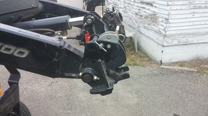

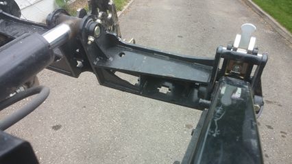

I splurged have one!!
760 with frt.
very well constructed
easy to mount offsets bucket about 3 or4 inches weight is 45 50 lbs. Jerry is a superb welder unit works great pics to follow as time allows.
   / tach n go on a sc2400 or 2450 #7
Great, Post some pictures when you get some. Going to order anything else from them? Also where are they located?
Jerry is located in Nelsonville Wisconsin
It is a pricey but very nice piece of equipment it works with two pins that you pull on the side flip a spring loaded lever then reinsert the pins in the other holes, set bucket down curl it down and back away. I did not buy the forks from him as I wanted mine to be adjustable and I already have a set that fit on the 3 point.
The old joke with the little kid looking at a guy grinding saying "My Grampa says if you got to grind your welds you aren't a welder your a grinder" was brought to mind when I got this look at the pic's Jerry is MOST definatly a welder some really nice ones on here.
there are slots in the front that allow you to slide a chain thru and lock the links also a receiver hitch built into the center

If you notice in the above pics you put the original pins from the loader arms back in when putting the tach-n-go on. He sends a second set of pins with to put in the bucket they are solid and not have no grease zirks in them as there is no movement other than when you hook and unhook.
