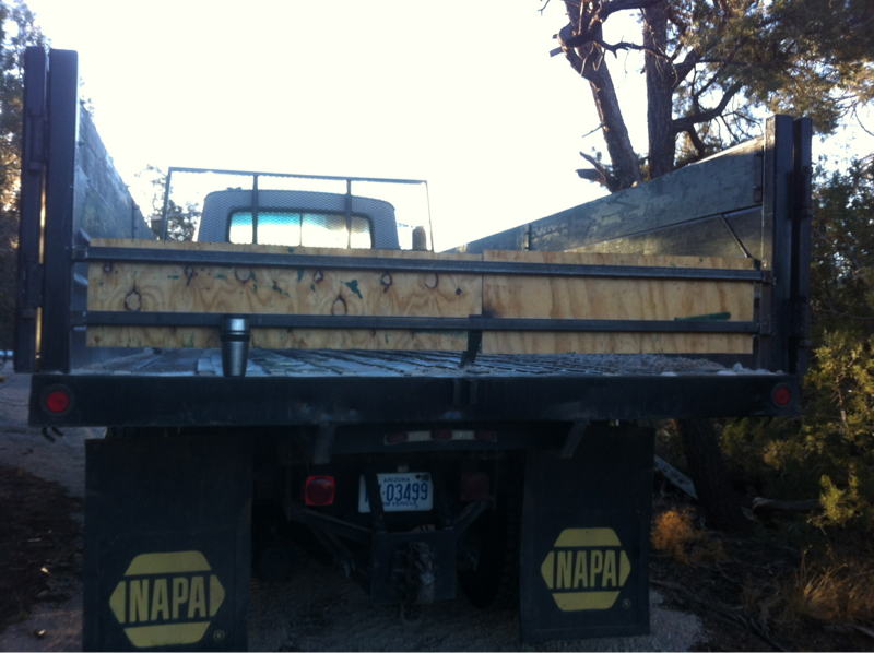

I have a friend that has an open bodied truck with removable sideboards...there is no tailgate he just uses 2x 10's across the back for hauling gravel...
I have some 1/4 diamond plate and am thinking of fabricating a chain adjustable tailgate that will allow him to spread crusher run...does this sound feasible?
Anyone done anything like this? I know I can have another (commercial) hauler bring me the gravel and spread it but they charge too much IMO...
open to ideas or suggestions...

I welded some brackets on the sides of mine so that I could do the same. My tailgates open sideways.

I guess I don't understand the original purpose?
If the truck is just a flatbed with 'buckboards' how do you plan to dump/spread it?
Even if you make a tailgate with chains you'd still have no real way of 'spreading' it unless you could shift the load to the rear which is usually accomplished by raising the dump bed as you move along.

The truck has a dump bed...just not the typical "dump truck" superstructure w/ top pivot gate...
The buckboards are made up with 2x12's...will also need to increase the height of them...

Anything that you can put across the back to make a fixed width opening will work. The width of the opening will be more or less how thick the gravel is spread depending on how fast you drive. What BoFuller has looks like it should work well. One other thing to consider is if the truck has the right type of hoist to dump while moving. You need to have either a PTO hoist with separate PTO/Hydraulic controls, or an electric hoist. The type with the PTO/hydraulics controlled by one knob would be very difficult to use to spread gravel.

An other option for occasional use would be to raise & fasten the bottom 2x12 a 2x4's height off the floor. then while loading/hauling fill the gap with a 2x4. Remove the 2x4, start spreading while raising the bed. It may not give you a super smooth spread but will save you the time & material for building a tailgate you may only use once in a while. (Be sure to re-enforce the 2x12s to take the weight of the rock when you lift the bed.)
