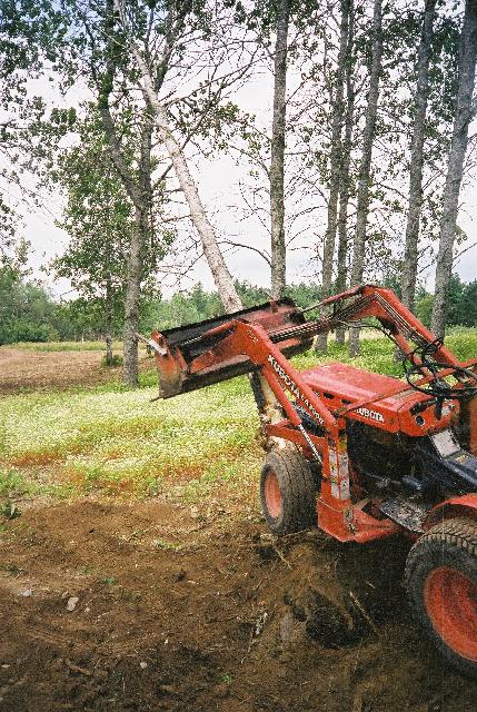

In the past when I would cut down a tree, where I wanted to control where it fell. I would use chains, my come-along to pull it tin the right direction before i began cutting.
Now I have the Kubota B3030HSDC tractor with a FEL. I just wonder what you guys think of giving the tree a push with the bucket high to get it moving in the right direction. I mean there is still some risk.

I'd say there's more than some risk. It is very dangerous, thats not to say I haven't done it when I got one hung up, but I can assure you the pucker factor is huge.
   / Taking down trees with tractor help #3
The bottom of the tree could come back into the tractor. Most of the time I ride the bucket (safety police don't kill me) as high as possible. I then wrap the chain and go back down. Get plenty of chain hooked up so it will clear with lots of extra room. Pull back slightly till the tension is out. As someone starts cutting use the curl function to pull on it. As the tree starts to really fall put it in reverse and go with it.
No way.
It could kill you pretty easy, the leaning tree can snap over the top of the tracotr. But most of us will never die, so that argument will fall on deaf ears.
If it leans the wrong way, it can be much havier than it looks, and your tractor will not be able to push it. This at best leaves you at a stalemate. How are you going to rescue your tractor?
What if the tree snaps at the base & comes over on your tractor?
Let's say it falls over the right way when you push it. The base often (enough) will whip back past the stump as the top snags on something. Or, the tree comes down & the butt end whips up into the air. Either of these can mess up the front grill or loader of your tractor.
I know nothing will happen to you or me ever; but, what about your tractor? Do you really want to mess it up?
You can get a chain/ cable longer than the tree is tall. (My great-unkle lost his leg to trying to pull a short limb off a tree with a short chain. They cut 1/2 the limb, pulled, and din't know the tree trunk was rotten. Whole tree fell over, top knocked him off the tractor and under the steel tractor wheel. Ground his leg off.) Always make sure the chain/ cable is long enough.
Then pull the tree over much as you did with the come along.
Don't push it with the loader bucket.

I did this - once.
Not only did the tree not fall where I wanted it (a 24" invasive Norway maple flattened a perfectly good fence) but a branch broke off on the way down, first impaling the plastic hood on my 4320 and then knocking me on my thick skull.
My head healed. The damaged hood I'm keeping as a reminder.

The safety police will tell you to never do this, but like others I have done this before. Usually it works better with a bigger machine then a CUT as you can get higher up on the tree to create more leverage. I would not do this on anything that is leaning in the oposite direction you want it to fall due to leverage. A better way would be to use a high strength cable, I have used 1/2 inch cable with a heavy duty snatch block chained to another tree or other immovable object in the direction you want it to go. Cable to tree as high up as you can go running the cable down through the snatch block then to your tractor. put a strain on the cable with the tractor while having someone notch the tree in the direction you want it to go then make the back cut. The key is to keep tension on the calbe at all times once the notch is cut. If you don't you have no control.
