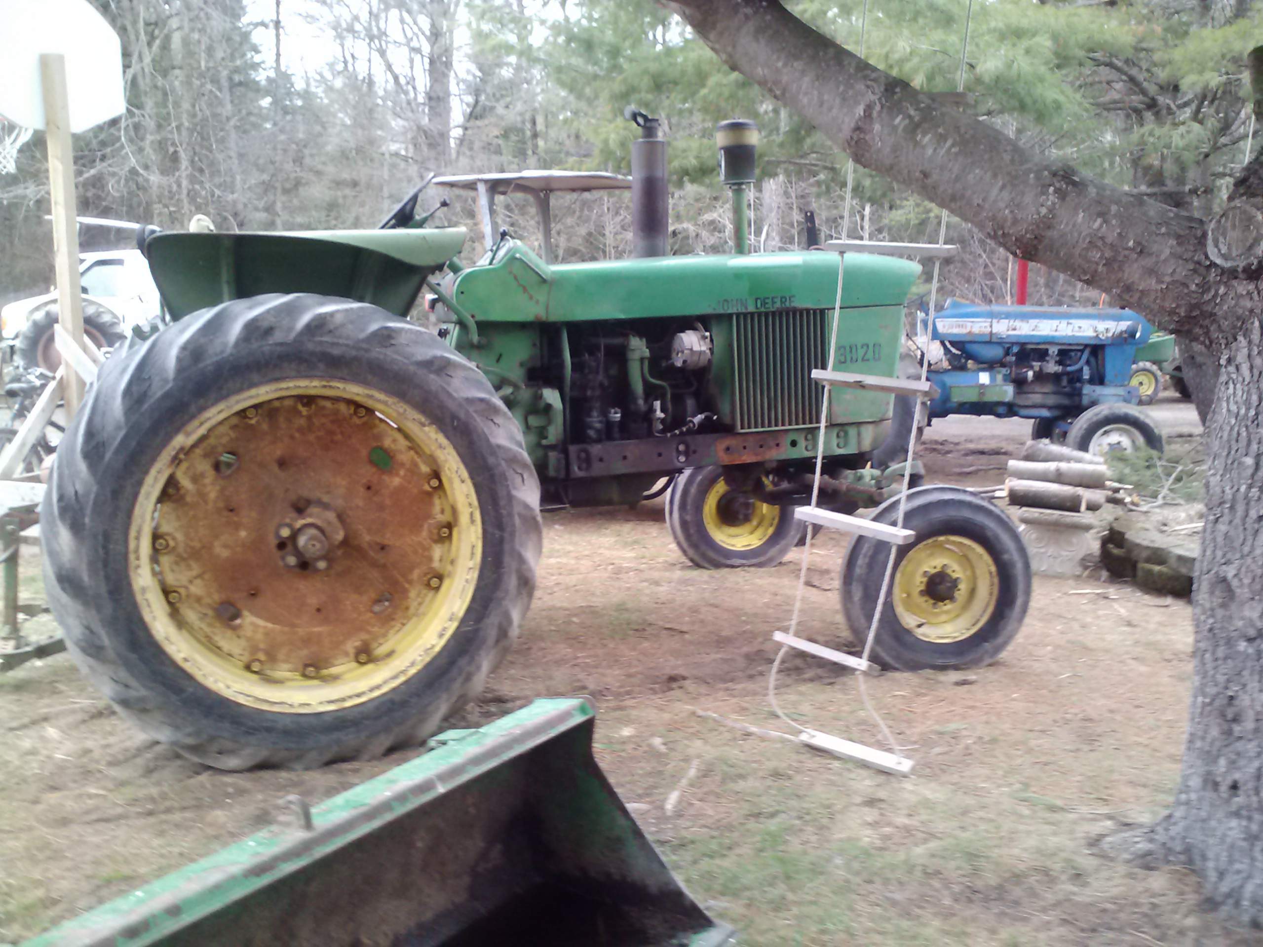

Was looking for a 60 to 70 hp tractor for our small haying operation, didn't really need the hp, just the weight. I have a couple of smaller tractors but they are working to their limit with the haybine and I can't haul a wagon behind the baler. They will be used for raking and tedding. I found 2 local that were in my budget (I don't want to borrow money).
First was a 3020 JD diesel, jungle shift, hours not known, working condition from a friend of the family. If I had one complaint it would be rear tires were poor. He's had it a few years, motor is pretty tight, everything works as it should. 2 rear remotes, filled rears, weights on front. $3000 cash

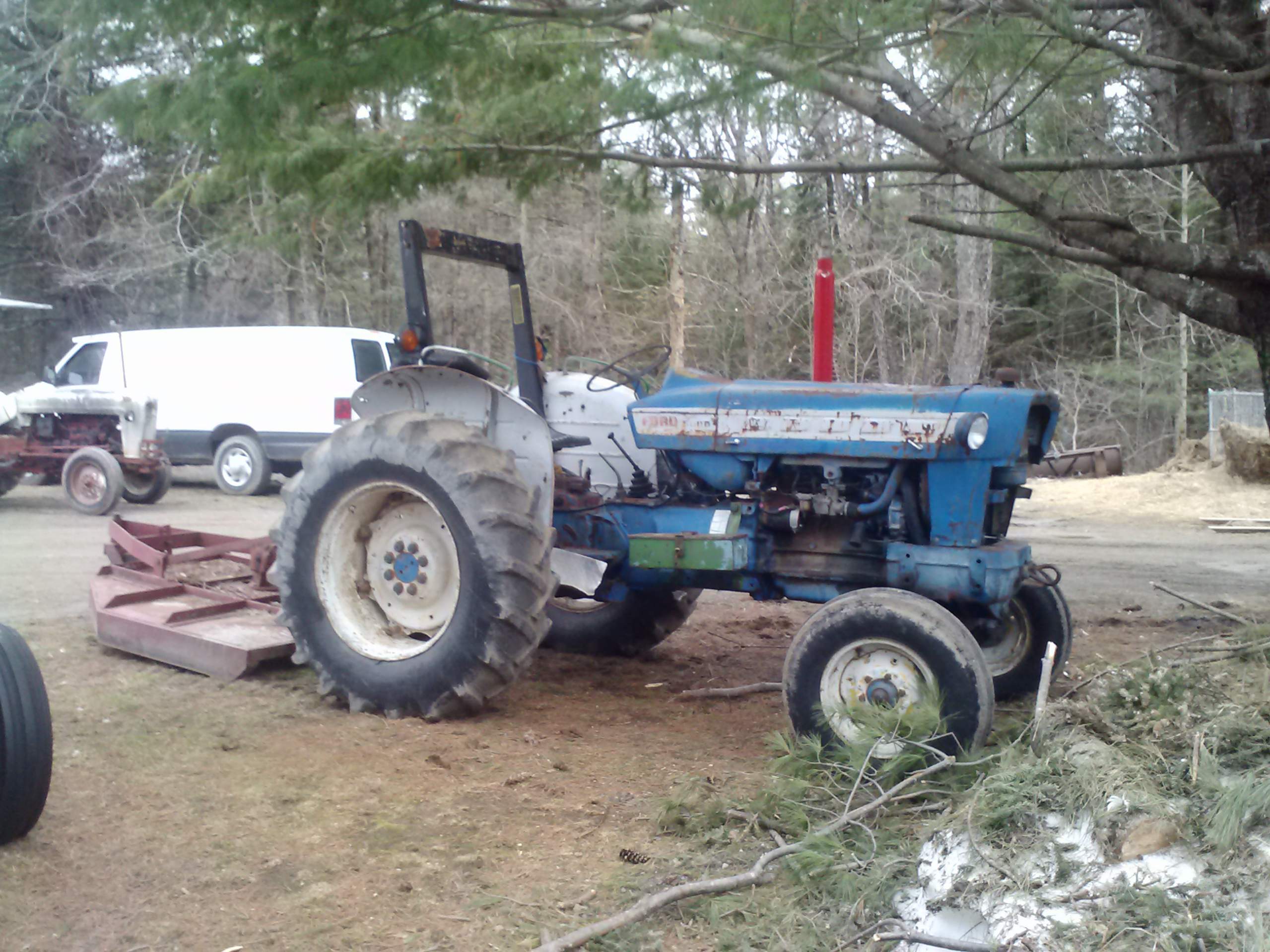

Second one was a 5000 Ford Gas, 8 speed standard shift, I never did check the hours. Decent tires, motor sounds good, everything works. 1 rear remote, filled rears, and 6' bush hog. $3500

Both are well respected tractors. I would say you done real good.
The Deere diesel sounds like a bargain even with worn tires, but better yet you know some of its history too. Really for haying massive amounts of tread on tires are rarely needed so if the tire casings themselves are good then I would not fear using em as is. I would like to find me a decent Deere like that for that bargain price of money. If I had to get nit pickey I do not personally care for the exhaust sound of the 3020's with certain mufflers as they can sound goofy but a muffler change would likely fix that. Also the crankshaft counterbalancers can be an issue if not serviced properly on rebuilds and some parts for the balancer can be scarce, but other than that I think this will be a fine haying tractor.
The Ford is a fine tractor too. Rock solid simple yet timeless design. Many consider the 5000 model the best tractor Ford ever built. Although most prefer the diesel; I would not fear the gasser. The gasser will likely never have the block cavitation problems that the Ford diesels of that era were known for.

Looks someone already may have changed that muffler on that 3020 looking to improve the goofy exhaust tone they sometimes do have or simply opted for a cheaper replacement when needed. I was thinking all 3020's had oval mufflers but I could be wrong on that. If it sounds good though I would keep that muffler.
No chance that Deere is a 3010 is there? Round muffler, repainted stenciled decals that are not orig would have me checking the original serial tag to confirm as well as some casting numbers to insure that a hybrid tractor has not been made which would not be a huge deal really.
Looks like someone put a cherry bomb as a muffler on the Ford. I mowed one summer fresh out of high school on a little Ford 2000 with a flail mower on the rear of it for most of the summer with a cherry bomb on it. It was too loud. The next year after I left (only a summer job for me while in college) when one of the veterans had to run the tractor the muffler got replaced with an original since I was no longer there.
I believe the Deere will end up being your favorite, but the Ford 5000 is a heck of a tractor too.
Thanks for the pics and I still think you done good. I certainly would volunteer for some seat time on that Deere or even the Ford if you only lived a little closer to SW Ohio....

According to the serial number JD is a 67' 3020, I never considered what it sounds like, if it pulls I'm happy. It is a cherry bomb on the Ford, I was thinking on the drive home that ain't gonna work.
