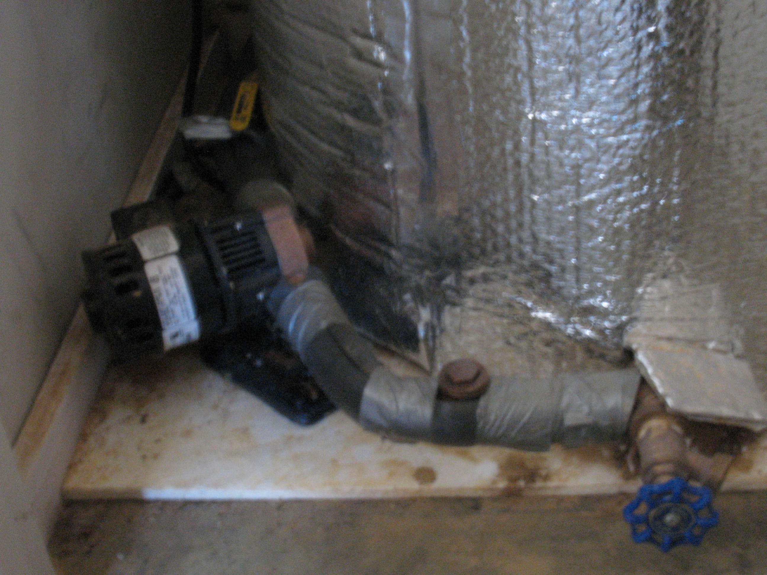

IMG_1213.jpgCentrally located tankless water heater wont help with long distance lines. It still has to run all the water in the line out before hot water can arrive. When I built my new house I looked at those and weighed the pros and cons. We had one in a condo in Peru that was right outside the kitchen on a patio with a 100 # propane tank and we used that tank for 3 months before having to replace it. Electric tankless really soak up the electricity and will require more amperage service to your house than the standard 200 amp box as they will use 100 amps alone but still wont help with the long distances from the source.
You need the individual hot water at the source type but they can be expensive also. What I did was have the builder insulate all the water lines with closed cell foam, install a recirculating pump at the hot water heater and a return header from each faucet. All my lines are underground so I don't have the super long runs of going from faucet to attic and back down like most houses. I turn on the faucet and within 3 seconds I have hot water anywhere in the house. If your lines are in the attic, you could still do this at your house and be cheaper than installing a local 110V heater at each faucet especially since most locations don't have 110V power where you will need it.
