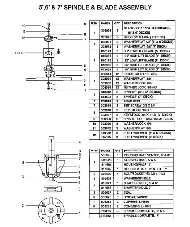

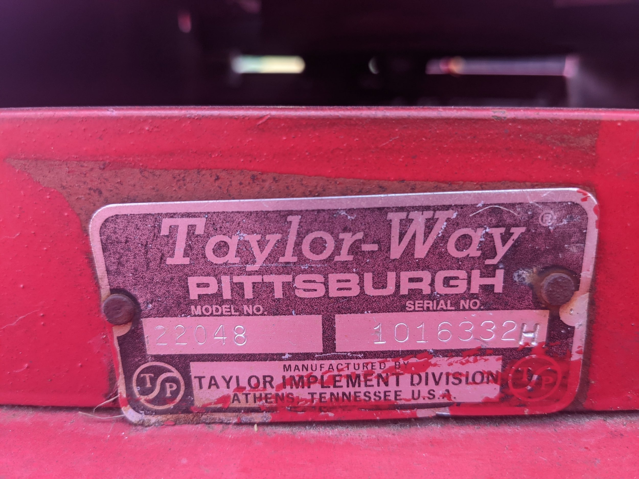

I recently bought a used finish mower (taylorway Pittsburgh 220 48") and one of the spindle bearings went out within a couple hours of mowing. I have replaced them twice. I cannot find what the actual bearing should be I only found an exact one that the previous owner had replaced it with. My question is can I replace the entire spindle (for both blades) with ones that are similar in dimensions? I cannot find any parts for this thing.

Download the pdf manual, it has the parts list, I am going to bet you can cross reference the part numbers
   / Taylorway Pittsburgh 220 finish mower issue
Yeah I searched all morning for the 813413 complete spindle assembly and found two sites, both said out of stock, one was $168 the other $331. Can I just buy a very similar spindle assembly and replace both sides? I would be using both original pulleys. Mounting holes are pretty darn close.
   / Taylorway Pittsburgh 220 finish mower issue #7
Are the bearings bad? If so, find a machine shop to press out the shaft and have them install new bearings. Just make sure you buy quality American made bearings and seals. It doesn't appear to have a grease zerk in the drawing. If there isn't a grease zerk, have the machine shop install one in both spindle housings.
