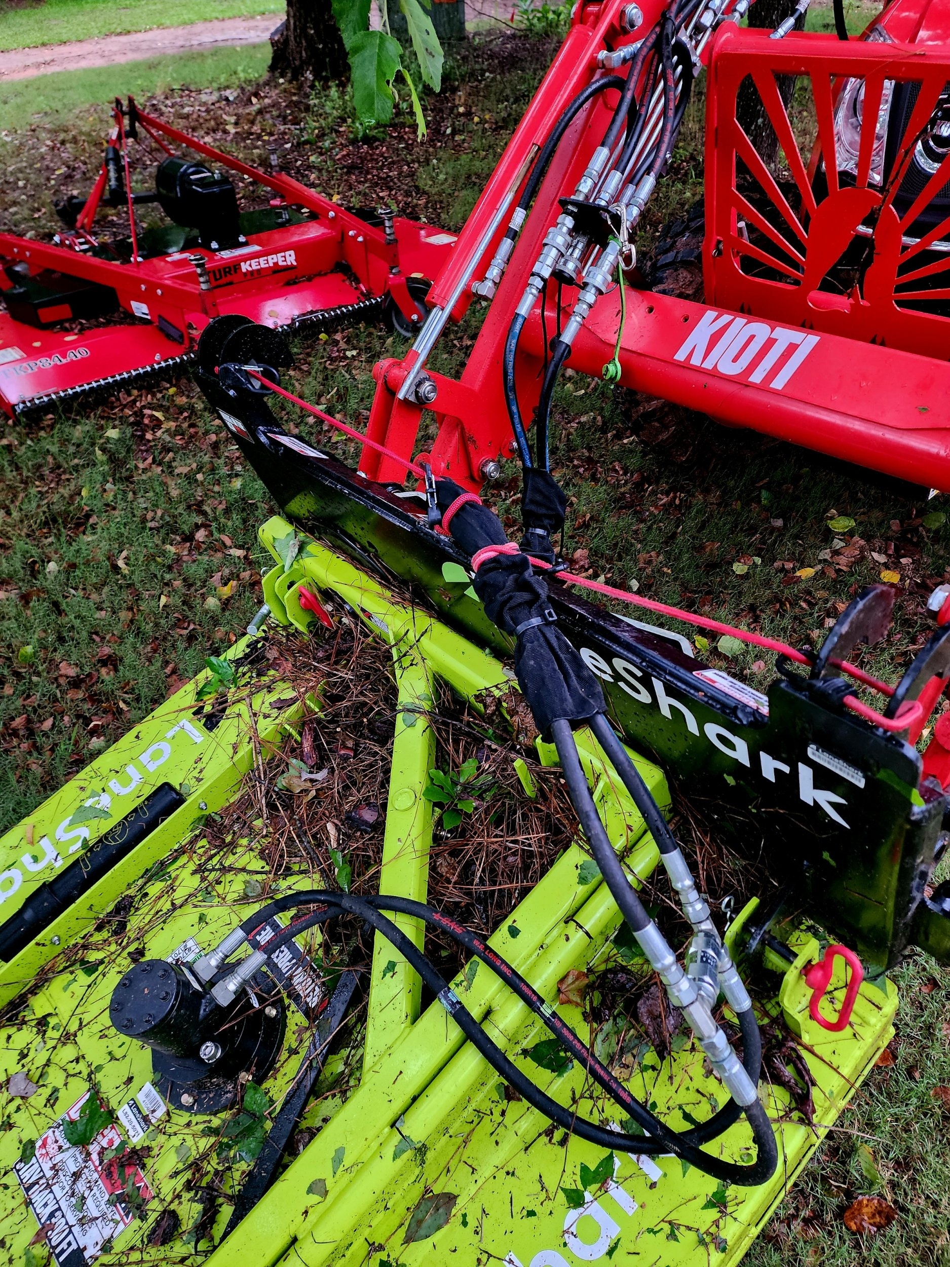

Here are pics of the LaneShark setup, sorry for the mess, just got done doing some brush cutting when it started to rain again this evening.
You'll see the 3rd function lines have 3 lines, the lower right is the dedicated return line used when using the cutter.
The hydraulic flow to the cutter is controlled by a box in the cab, mounted below the joystick.
Not sure how the TB-Max is plumbed, but thought this might help due to similar design

16.5 is total volume, yes and that includes hydrostatic power steering. I have a 3rd function on the rear that I will connect one line to, the other line plumbs straight into the return so no sudden stopping/starting of the blades, just a gentle slow down as pressure dumps off from what was explained to me. I have the same third function control on mine as does AirOpsMgr (thanks for the pics) but just use one side of it with the 2nd dumping into the return when using the TB-Max.
