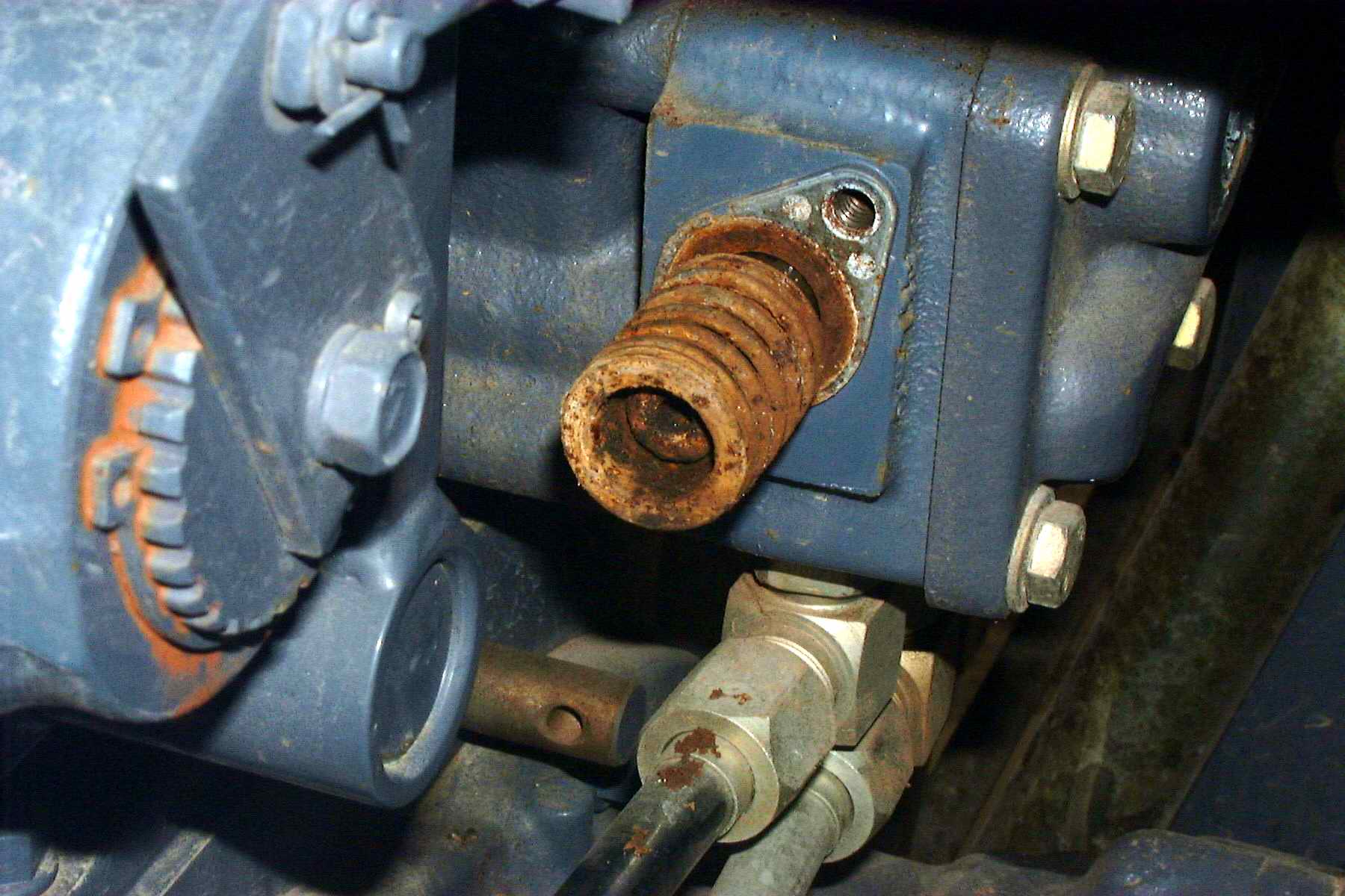

Welcome livesprings. By looking at your remotes, is there a chance that the ones on the right have been used and the ones on the left have always been there but not used? If so, it might be a lubrication issue or perhaps corrosion has found its way into the the valve or lever mechanism.
My tractor is different from yours, but I found the return to center spring mechanism on mine had water leak into it and became stiff and unusable. Here are a couple of pictures. The first shows the cover on the spring and the second shows the cover removed and how badly the spring was rusted. Yours might be similar.

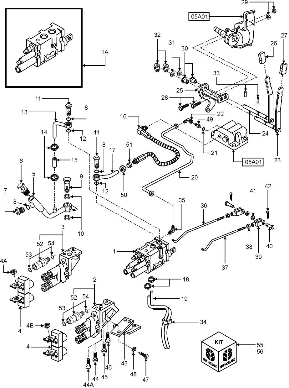

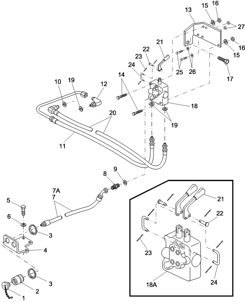

EDIT: Yours is not really all that similar. Your TB100 has remote hydraulics and something called auxiliary hydraulics. Each of these can be a single or double valve. They operate slightly different. I'm no expert, but I can see what they do (sort of) from the parts diagrams on New Holland's website. Go to this website and click on "Search for Parts." Then enter TB100 and follow the prompts to see the diagrams as I've shown them below.
