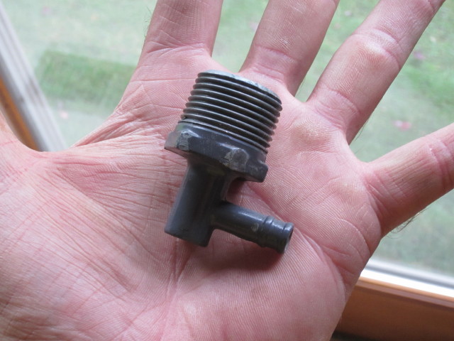

   / TC 33D Coolant Leak #2
Many times they will leak at the zinc threaded bib that screws into the engine block. (picture) I replaced mine with a brass piece and never had a problem. Is your "leak" from the valve that connects to the bib with a hose? It will have the needle drain screw with a locknut. They always seem to leak AFTER you tighten the locknut because the nut pulls the needle valve away from the seat. Try just tightening the center valve and leave the nut loose as that is what worked for me.

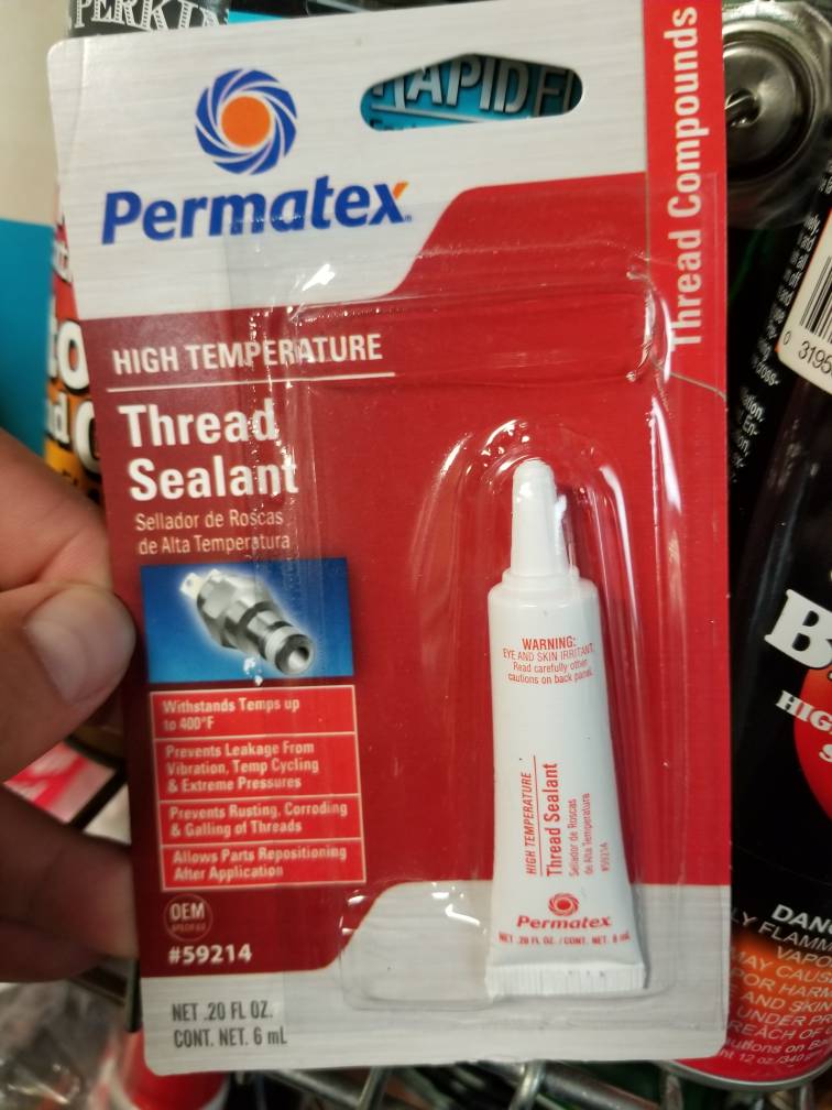

   / TC 33D Coolant Leak #4
Somebody screwed up when that part was substituted for the original. The leak comes from the radiator side of the common drain when the block drain screw is closed. It is guaranteed to leak unless you put thread sealer on the drain bolt and lock it down several threads from fully seated. Alternatively you could screw it all the way in, lock it down and do away with the common drain feature.
Thanks @RickB. I'm going to try the thread sealer today. What a dumb setup.

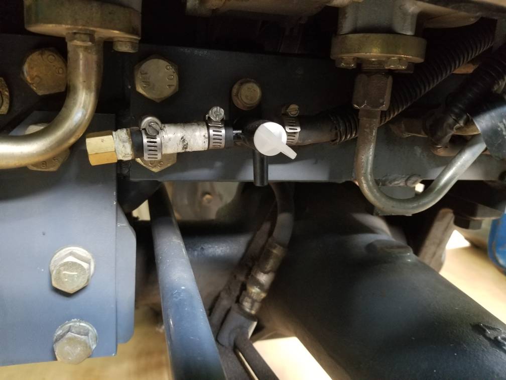

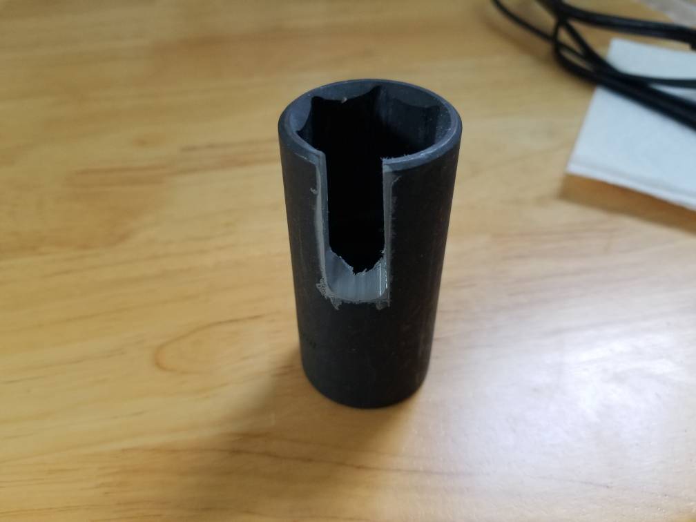

   / TC 33D Coolant Leak #6
I had the same issue with my TC25D. I replaced the block fitting with the new one that has the needle bolt in it. I used teflon tape and mega lock on the threads to the block. I came out the next morning to find the bolt dripping from the rad side. At that point I seperated the drains and capped one side of the drain on the frame. This was good for a few weeks then the block threads started leaking again. I took it apart again and used a loctite thread sealer on the block threads and it has been dry for 8 months now. Hopefully it stays this way. I also made a 27mm socket to take the block fitting in and out.20200711_134815.jpg20200711_103112.jpg20200711_134724.jpg
