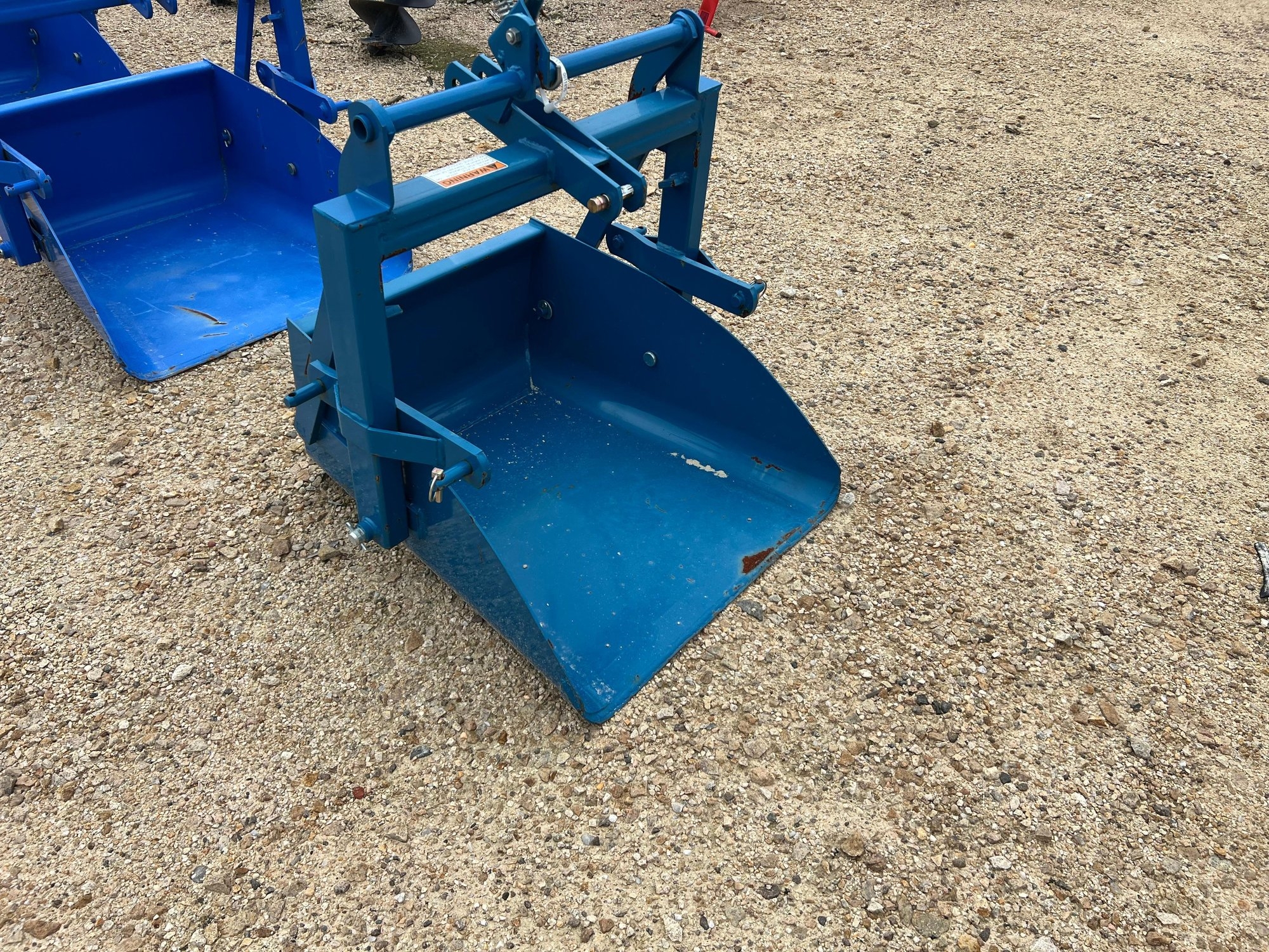

Bought it.
Disc
Spreader
Rear blade
Boom pole
Middle buster
$10,000 even
