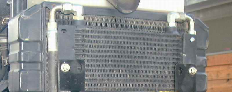

RickB and tractornate, I'm attaching a photo of my transmission cooler on my TC45D. I believe it is the old style, but maybe you can point out the difference with this picture. I've not had any problems with my cooler, but I'll sure keep an eye on it if it's the old style.

   / TC-35D Haudraulic leak
You were absolutely correct! My old dealership swapped the first defective cooler with one from another machine he had. I found this out when I was at a new dealership today. The computer doesnt lie. There is an upgrade on the cooler. I have it on order and this new dealer is attempting to get New Holland to back my warranty as the problem still existed. New cooler is approx. 180 bucks. I hope I will be covered. Thanks
