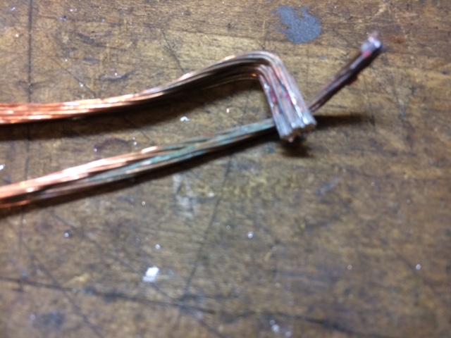

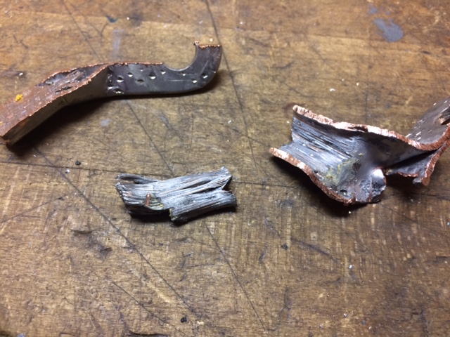

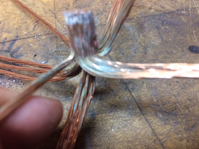

Just to further document things a bit - here are pictures of where I think the problem was.
With everything back running fine, did a little investigating of the bad cable. As previously mentioned, I was suspicious of the end going to the starter. Appeared to be a possible cold solder joint. So cut off the lug, then spit the lug. Also 'unstranded' some of the cable. The interior of the cable exhibits greenish corrosion, along with some red dots. Solder does not look right to my eye. I'm going to guess problem was some contamination that through time deteriorated to where it was a high resistance path. Not exactly my area of expertise - I'm a retired mechanical engineer/manager who did military printed wiring product and system integration - manufacturing engineering basically. If still working I could have gotten some experts to look at it, but will have to settle for my own guess at this point.
Cell phone pictures not the best overall, but you can see the problem I believe.
Might be of use to someone else in the future.

That is exactly what happen to my friend's TC35. He was buying new starters, and we cleaned every connection to the safety interlocks one morning also. He finally traced it to the bad battery cable crimp/solder job from the factory. Go figure.
