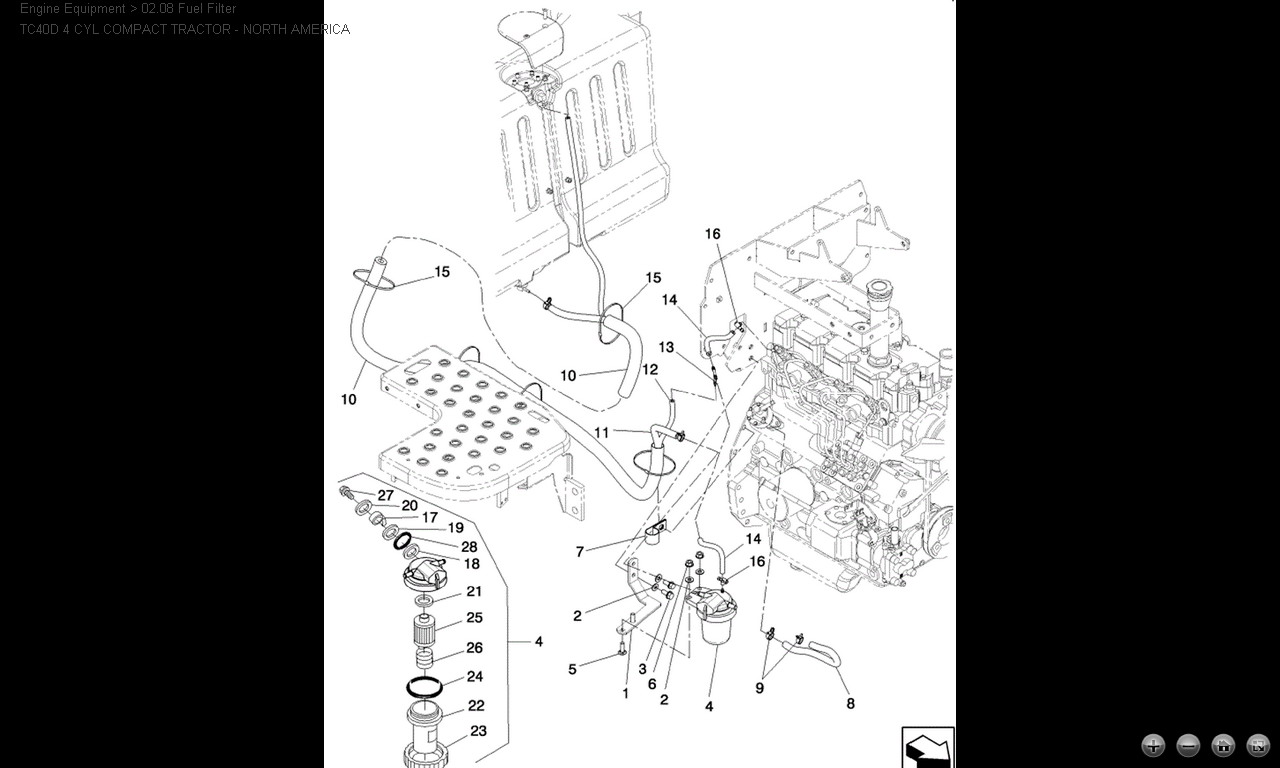

Can you point me to a site with fuel system diagram for a 2001 TC 40D? The owner's manual isn't very good and I can't seem to google one up.
   / TC 40 D stalls under heavy load and will not restart #9
look at messicks.com
   / TC 40 D stalls under heavy load and will not restart #10
Trying to find a fuel system diagram that's complete is a nightmare (meaning it ain't real 'cause it doesn't exist). Even the New Holland Repair Manual has a diagram with the fuel pump and filter in the wrong spot. The diagram below is about the best you can get and it only shows the hose from the filter that goes to the fuel pump. You have to look at the engine block diagram to find the fuel pump and it does not show the interconnecting hoses. The details in places you really need, are something it seems New Holland forgot to include. I think you are better off asking questions here and having them answered rather than spend time looking for the right info in writing. Here's the fuel filter diagram from Messicks.com, but you'll need to look at the website for all the part descriptions.
