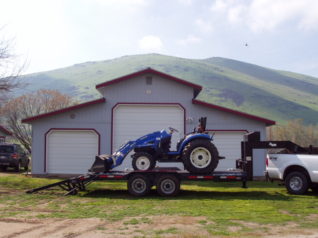

Hello Bill,
The trailer's GVWR is 21,000 lbs less the trailer weight of 4850 lbs equals 16150 lbs of load (tractor, etc.) weight. In the photo, I just got back from a public scale and found out as it sits, the trailer, tractor, 16LA FEL, 1/2 tank of fuel and chains and binders weigh 10360 lbs standing alone on the scale. No rear attachment was taken because I want to at some point add a Woods BH90-X backhoe to the package and that will be the heaviest implement to haul around.

   / TC-40 with calcium/water filled rear tires #7
Wow, that's some beautiful hills out back!
Jim
   / TC-40 with calcium/water filled rear tires #8
Jim
Yes, they are! And, it's a great lookin' barn with a sweet lookin' tractor on a terrific trailer parked in front.:) I know I'm partial to these tractors, but that TC is one beautiful tractor. The sloping hood and 16LA loader are a thing of beauty.:cool: Nickel Plate, that looks like a first class rig to me.
#9
jinman, thanks for the kind words. That hill out back is Colvin mountain 1400' elev. to the west and three or four times a year we sit out in back and watch the cattle drives go across it, several hundred cows and usually a dozen cowboys and their dogs.
If I turned the camera 180 degrees, you would see the snow capped Sierra of Sequoia National Forest. We are going to sell this place when the market (and it will) corrects and go build on a few acres that we own south of Mariposa (south of Yosemite).
I built the 32'x40' shop myself. That center bay has a 12' opening. Drew the plans, framed the walls on the 6" concrete slab and we had a "barn raising party" one weekend. All the walls were up, plumbed and lined and braced off in about three hours. I got to hand it to the country folks. It's real peaceful out here concidering this is California.
   / TC-40 with calcium/water filled rear tires #10
Hello Bill,
Are you sure on that trailer?
Those look like single tires, single axles, which typically rate in the 6000/7000/8000 range (each so 12k, 14k,16k)
I've never seen a single tire axle rate for 10k, always takes duals.
What do the tires rate for?
What do the axles rate for?
