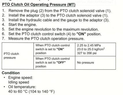

Jim,
Is there a pressure port/cap next to the solenoid that one can verify pressure with PTO not-engaged and then engaged to check against factory specs? is there a regulator block to establish pto hyd pressure? I would not run the tractor till the cause established. Slipping pto clutch will lead to pre-mature failure.

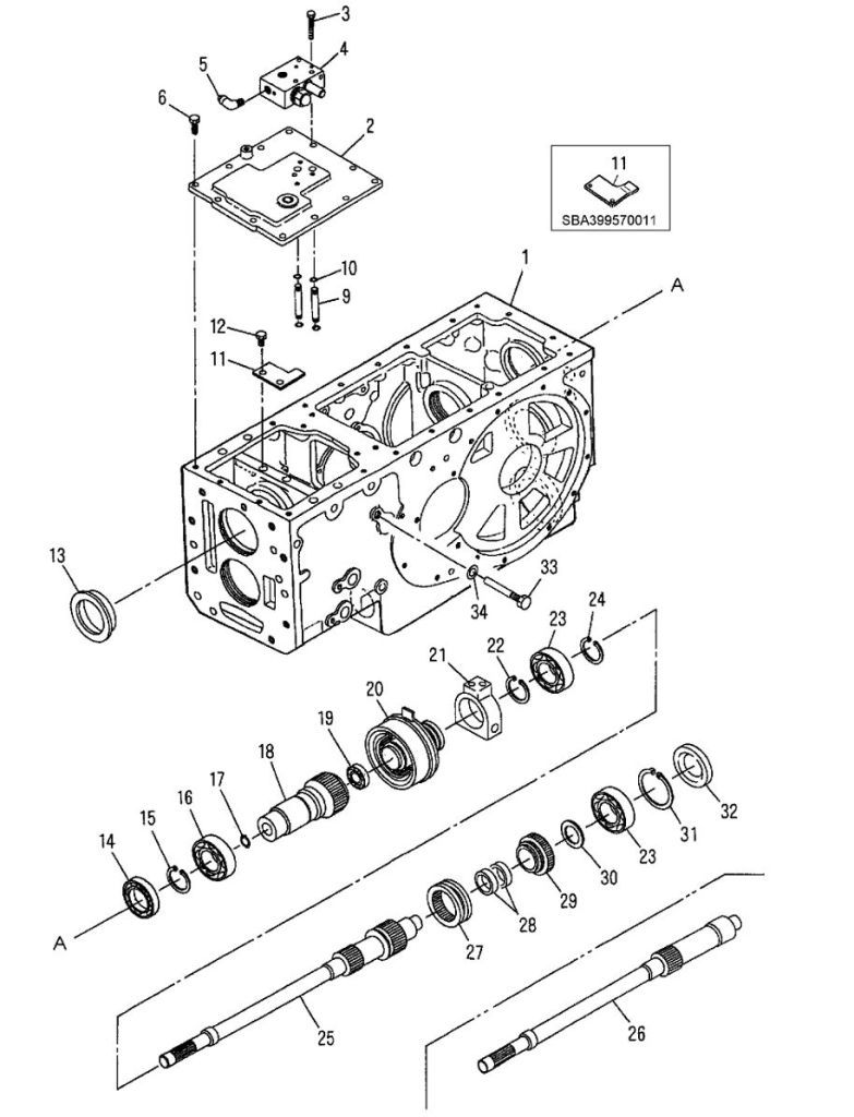

As I said, it's not that simple. I would not have said that if it were a simple hookup and check. There is no solenoid on a New Holland and the PTO valve is below the operator's platform. On the "DA" models, the hole in the operator's platform below the seat has been eliminated, so I'm not sure how you could get to the valve without raising the operator's platform. If he has the opening or cuts one in the platform so he can get to the valve, there is a 6mm hex head plug to remove and a pressure gage installed. The engaged pressure on a TC45DA should be 260 +- 15 psi (engine at 2600 rpm). However, the first thing the OP should do is inspect his lever to make sure it is engaging the PTO valve properly. He can inspect it to see if the lever looks bent or something is binding.

Jim,
Got it. Same set up like what I got withe the exception of having solenoid and it is on the side of transmission and very easy to have access too. As you said there is a good chance the lever is binding , bent or something that does not allow the valve to fully open. The question is we're talking pressure, even valve open at 25% should put the same 260+ with a slightly longer lag time, right? is the pto and power steering on the same circuit? can the pressure regulator malfunctioning causing less pressure when the valve is fully open?

Jim,
I understand exactly two points that you make. I was not suggesting to up the pressure to see if the pto holds. For sure the pressure should be read with the valve off and then on right at the pto piston using the port/plug intended for it. If that shows the main pressure does not meet the factory spec then you'll try to raise it at the source/regulator/relief. What it seems different with my rig is that my pto clutch piston is a closed circuit with on tube to provide hyd oil to the piston with an o-ring. If the piston seal should go bad then with solenoid open you constantly flowing hyd oil in the piston, leaking by oil and end up not achieving the pressure required. it is the same as a 3 point seal is leaking and can have the 3 point up as long as the engine is operating, once engine off and it drops quickly.

Hmm, I see the tc45 is different with two tubes going to the clutch pack.
JC,
   / TC 45 DA Problem #10
JC,
Yes, one is the pressure tube and the other one is the lubrication tube. When the fluid exceeds the setting of the relief valve, it flows into the clutch as lubrication.
