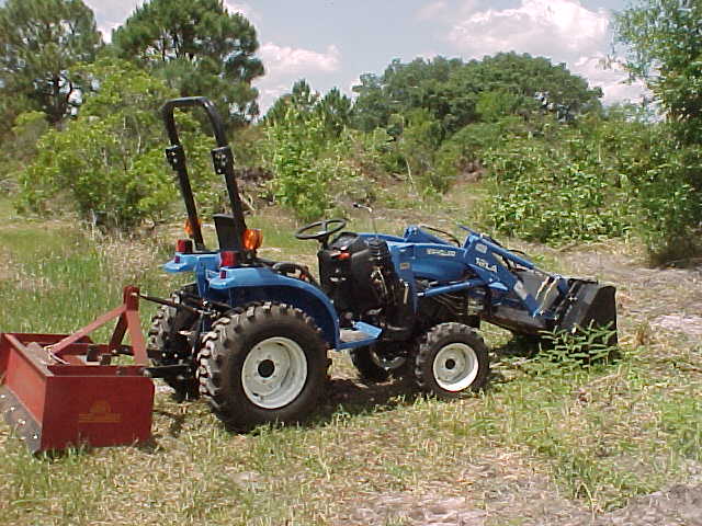

It's been just over a month - TC18 with 12LA loader was delivered 3/28 - and it goes in tomorrow for the 50 hour service - a little late because we worked hard over the weekend and got to 58 hours.
It had a hydraulic leak at the FEL joy stick when delivered, which I tightened, and a bent power steering arm, which was replaced under warranty, even though I might have bent it. Other than that, it has been flawless. I'ved used the brush hog (4' Rhino SE4) enough to approve of it, and picked up a KK 6' landscape rake that I'm still learning to use, but most of the work has been with the 4' box blade and the FEL. I will have a FEL mounted brush rake of one sort or another by next week - I'm hampered without it.
This little tractor has completely met, and exceeded, my expectations. 18 HP is enough for the Class I frame - I can spin the (unloaded) R4 front tires pretty easily, and find myself using the differential lock a lot (remember that Florida sand is pretty loose). The rear R4's are loaded with water.
Neat machine.

Glad you are enjoying it. I remember putting 40 hours on mine in the first month. The "honeymoon" will start to slow down soon. I'll have had it a year in a month. 130 hours so far.

I'll ditto that. I've had mine for about a year also. I was also a little concerned about "only" 18hp when I bought it, but have had no hp problems. I've been amazed at everything I've been able to do with it. (I can't believe all the uses for a FEL!)
My only mechanical concern has been a whirring noise coming from the hydraulic somewhere. It seemed to be worse over the winter when it was cold out. I thought maybe the cold fluid was getting too heavy for the pump until it warmed up, but I still get some noise. I guess I should call the dealer and get it check out. I can't stand the thought of being without it this time of year. /forums/images/graemlins/frown.gif
   / TC18 Update #4
I got the same whirring noise. I found that it was more pronounced when the three point hitch was all the way up. Lower it a tad & it goes away.
I suspect that when the oil is thicker in the winter, the "feedback loop" malfunctions. The Feedback loop is what tells the three point to stop lifting when the position control lever reaches the end of travel.
The manual describes how to adjust the feedback loop. Probably in there somewhere under "position control"
I will be changing to the "thinner" oil F200? (New Holland's winter blend) when I reach my 300 hours. I keep the machine in the garage so it doesn't get super cold.
