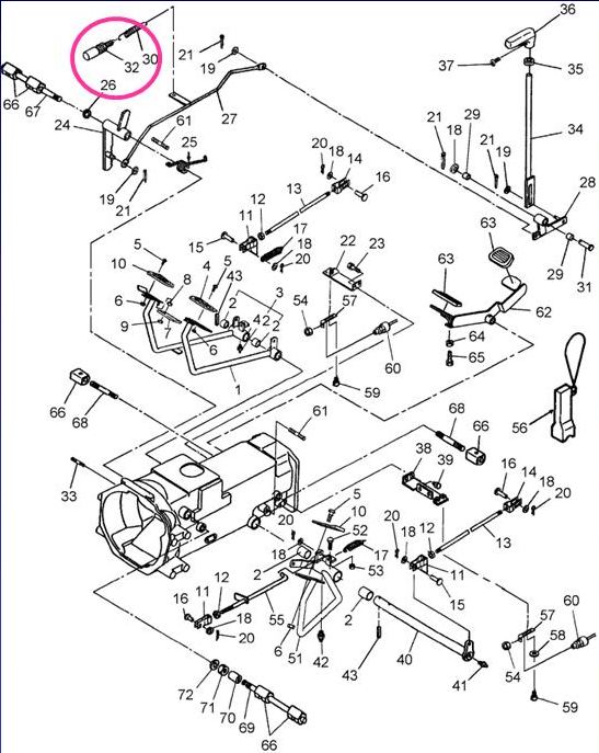

I put it away in the garage in the fall with the parking brake dash light on. Brought it out and it is still on. Go figure. The brake is fully released, everything works, seems like the sensor is stuck.
Where am I looking for this light switch/sensor?
Any help would be great.
Thanks
   / TC24D Parking brake dash light stuck on #2
It will be a switch somewhere near the parking brake handle. It will not be the brake pedal switch. The parking brake light normally closes when the parking brake handle is pulled, so look near the handle mechanism. It may be under the platform.
EDIT: Item 32 in the diagram below is the parking brake switch on your TC24D. I'd look at it.
Thanks for the info. I will check it out this weekend.
