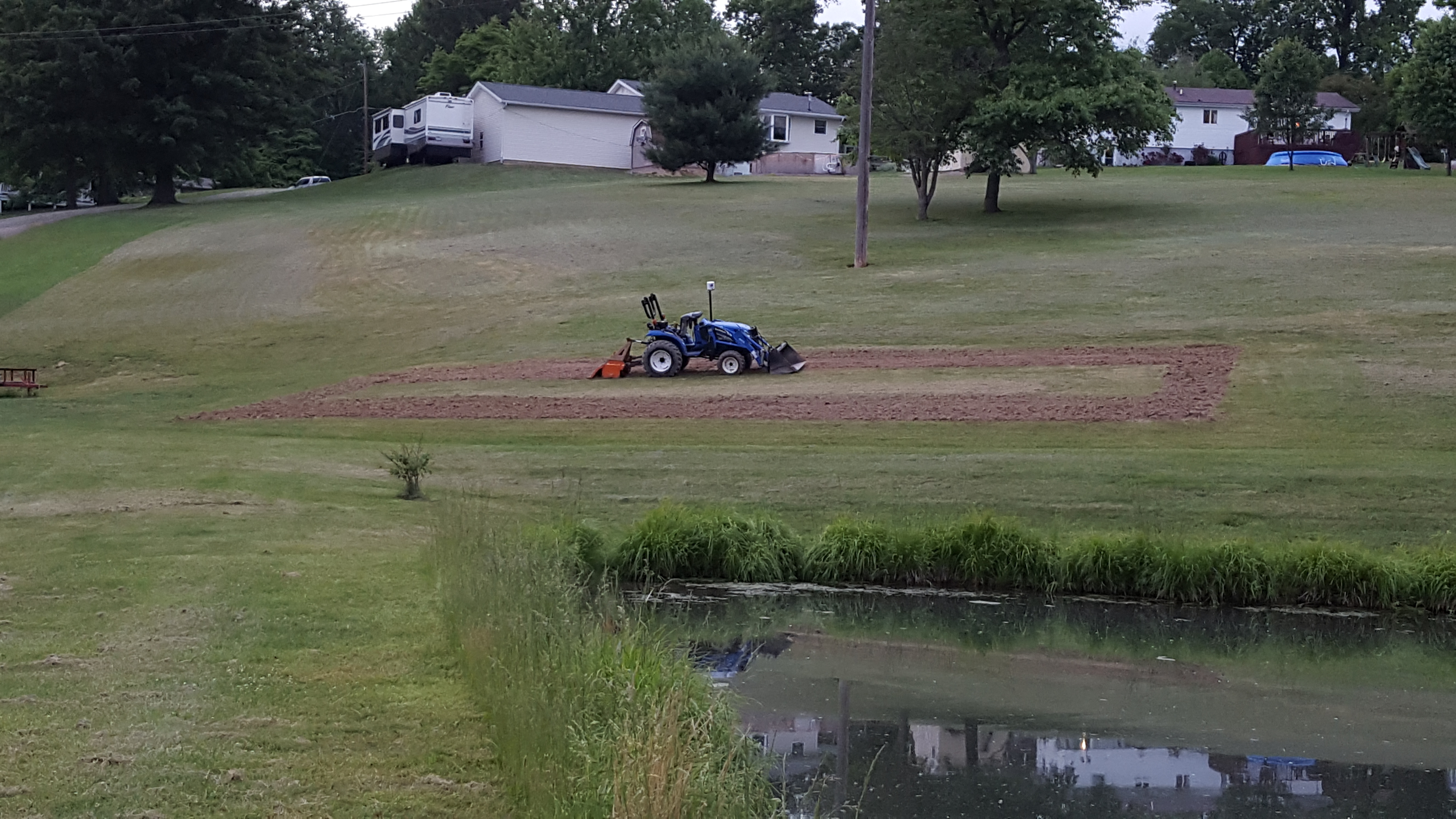

Hello gentlemen.
It has been a long time since I've logged in and posted here.
I have a 2004 TC24DA with a little over 1100 hours and I was in the process of tilling my new garden when all of the sudden she just stopped. Engine quit, no instrument lights, nothing. Attempted to restart and there is absolutely nothing. No instrument panel lights, no headlights, no clicks or noise from the starter, nothing. The only thing that works is the hazard lights. Yes I have already checked the levers and switches, they are all bypassed anyways.
Any ideas?

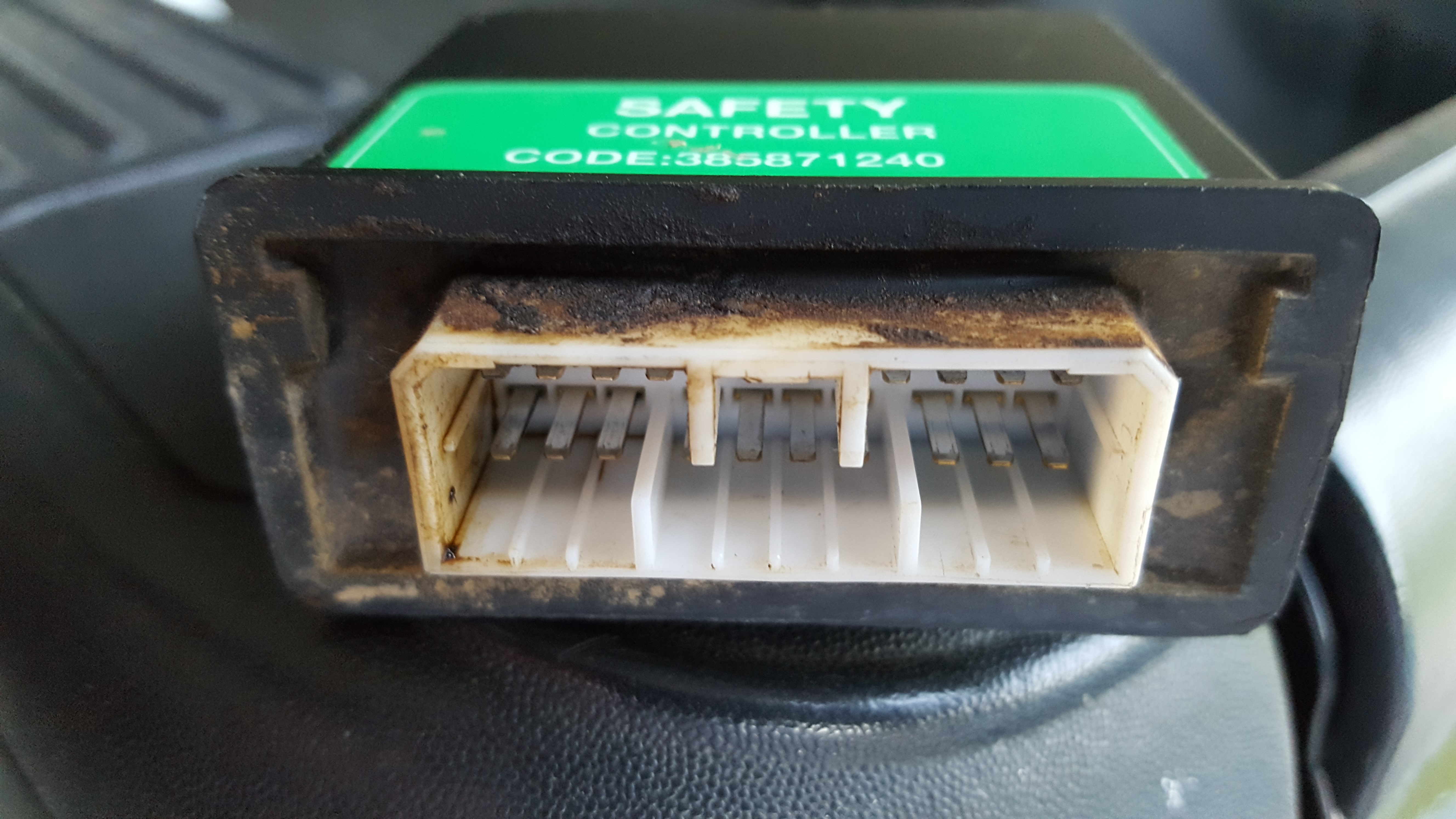

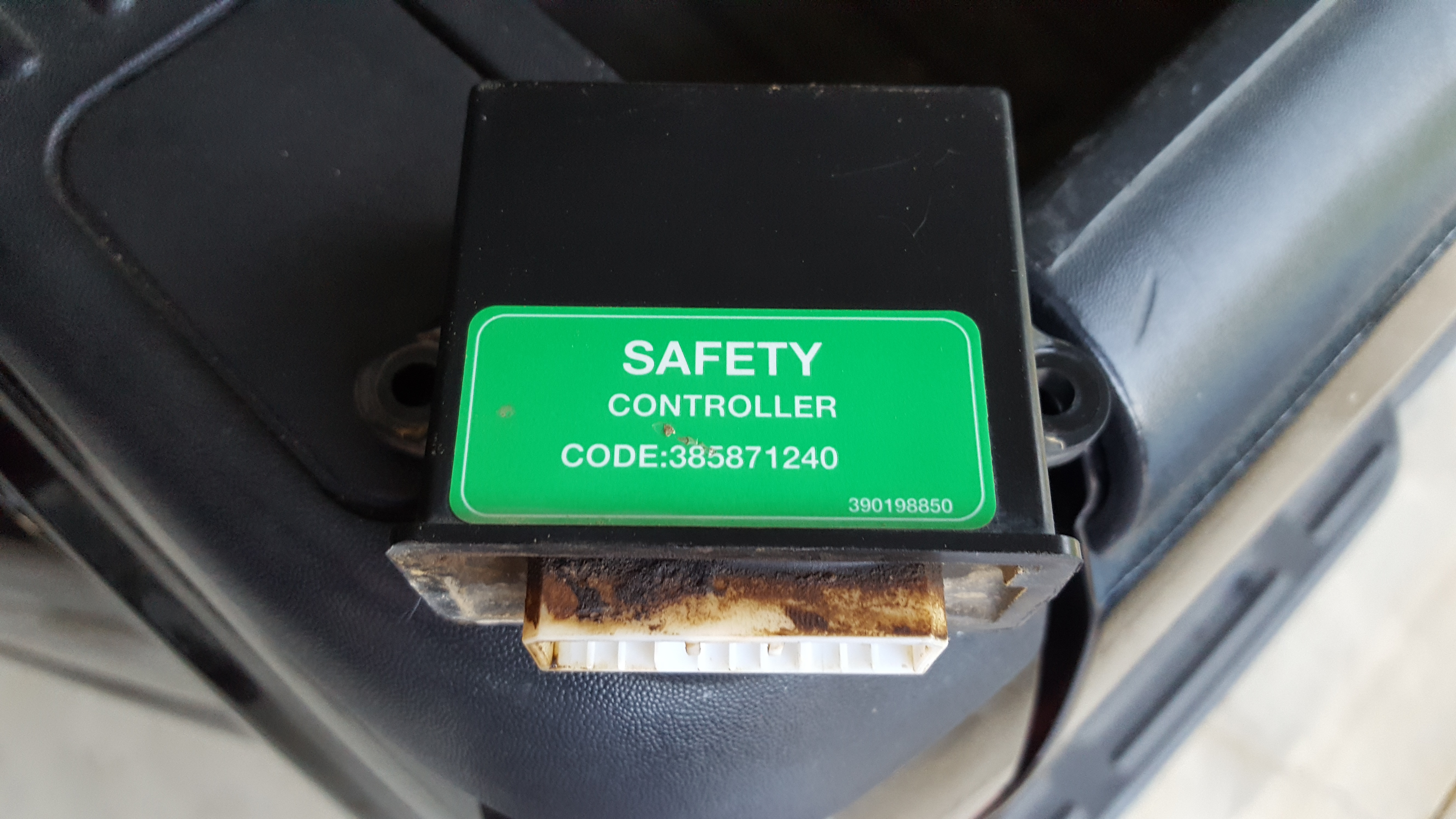

   / TC24DA is dead.
This is fried. $386 price tag.
   / TC24DA is dead. #8
Someone on this forum opened his up and found a poor solder joint. Fixed his problem, dunno about yours of course. Not much to lose but time.
Jim
   / TC24DA is dead.
#9
A new $386 safety controller fixed it!
