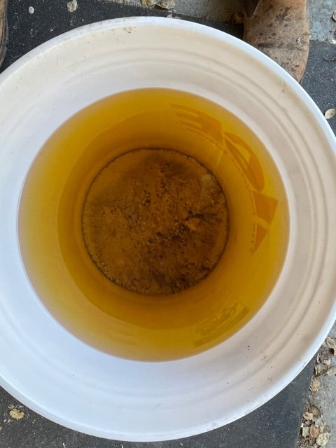

I drained the tank through the fuel filter. The stream was fine. I captured the diesel in a clean pail and got some residue as you can see it the bottom of the pail. Don't know if this is enough to prevent the flow. The fuel filter itself is clean. There were some small particles in the fuel cup.

I'd dump that in a clear cup or bottle to get a better look from the side,
It could have a big layer of water on the bottom.
The color looks off to me too, could just be the picture or container
I just noticed that's a 5 gallon bucket, lol. If you had some kind of clear container to put all of that fuel in... or maybe a few smaller clear containers

If it was flowing good that was not your issue... you would notice it long before you emptied the tank.
From your description it really sounds like a fuel problem... I see you mentioned "I replaced the fuel filter and purged air from the fuel line".... Is there any chance you have air in the lines to the injectors? You can bleed those also by building up pressure in them & then loosening the nut right at the injectors, if you do it slowly you can sometimes see the air bubbles being released. If you try this, do only one line at at a time & make sure you tighten them back up.
