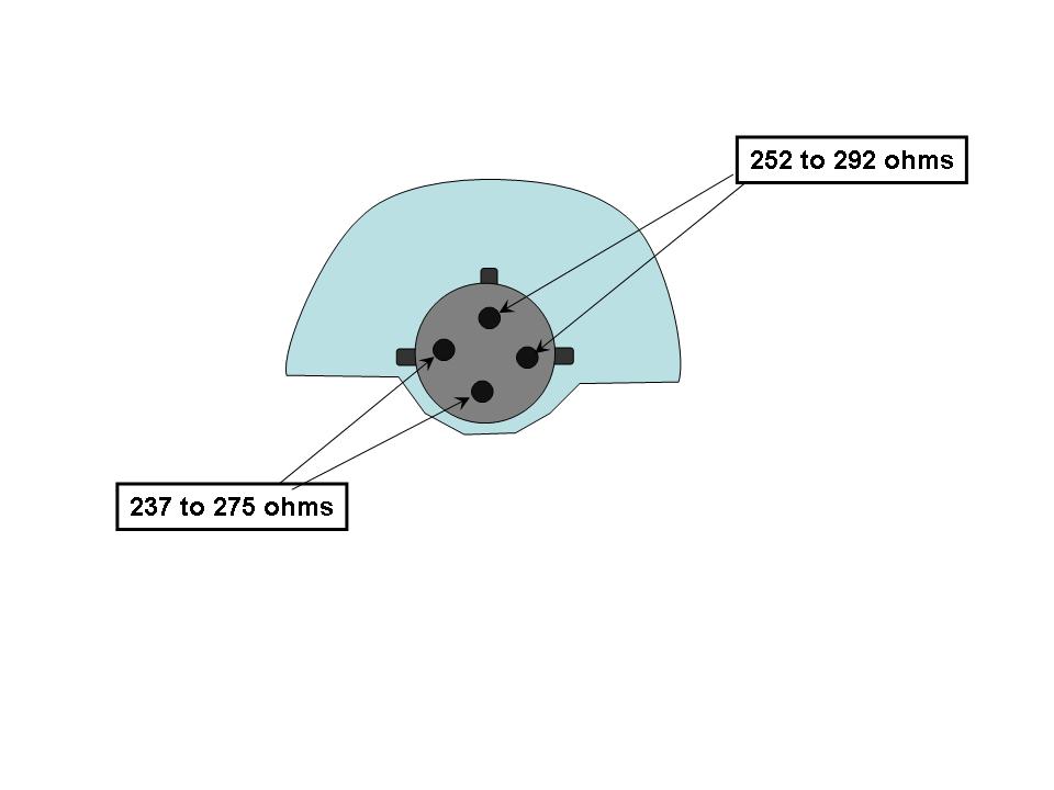

   / TC29D Hour Meter #9
Since you have the tachometer out, flip it over and take these readings with an ohmeter. If it is significantly different or open, then the tach is considered bad. Be sure and orient the tach as shown from the rear.
   / TC29D Hour Meter
Tach was good. I had ordred a new one before I saw your post. Put it in and no luck :(
