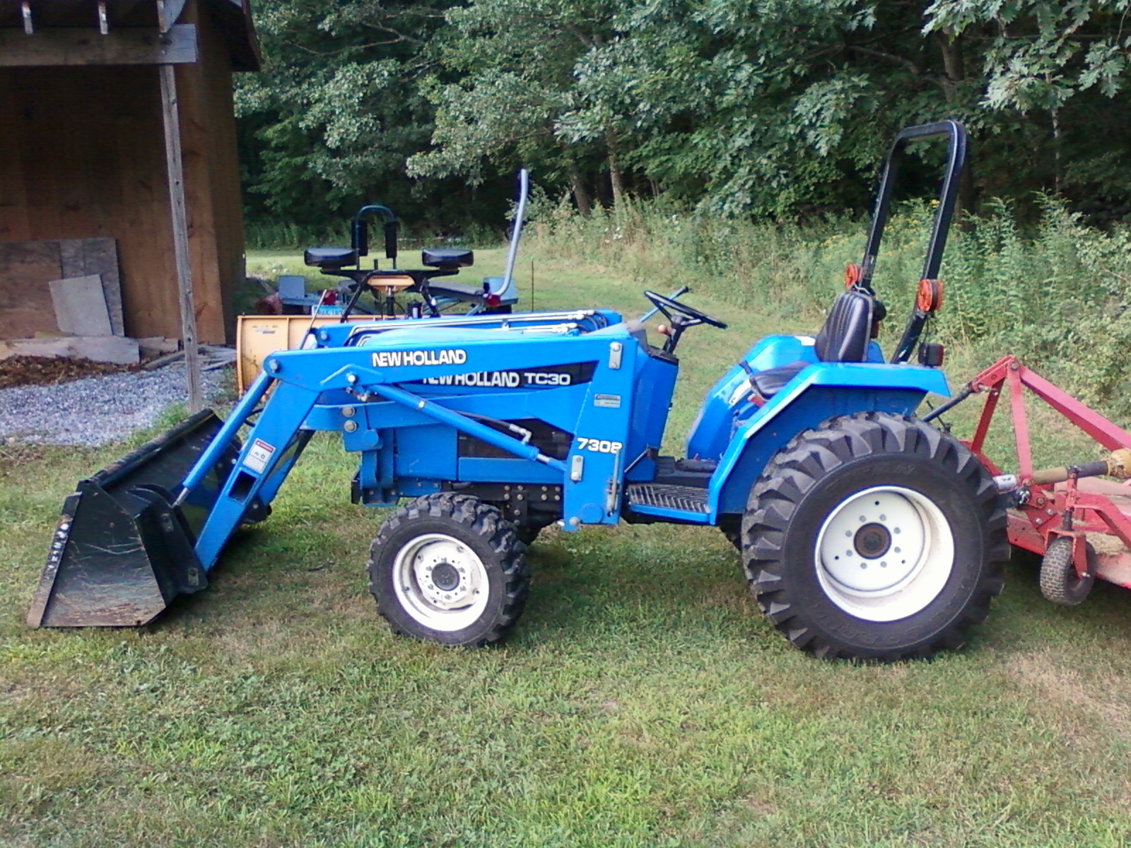

Okay guys,
Just helped my neighbor make a purchase of 2003 TC30 (only 434 hrs!!!). The little guy is in excellent shape (see pic). Question: Can I get a block heater for this machine? And if so, can you recommend a brand and model? Finally, where would attach on the block?
Best to all,
Jed
