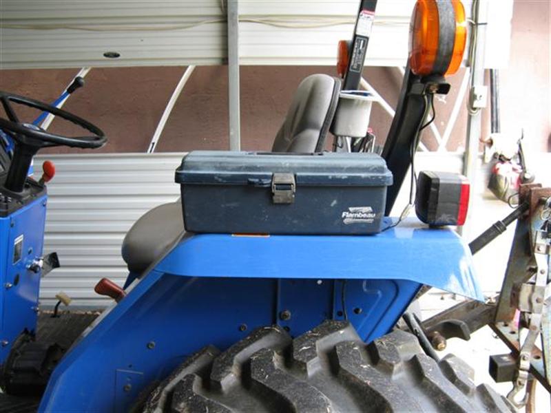

Trying to post a few pic's of my Stuff.

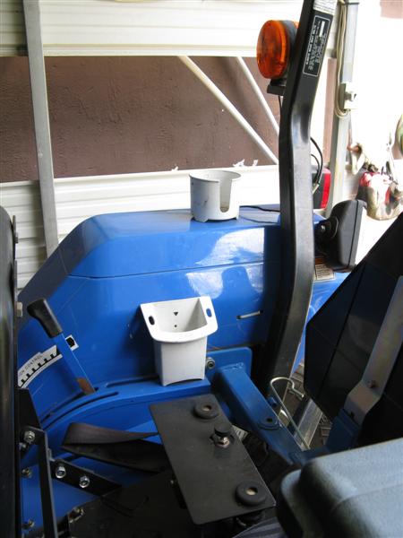

Good job yoder. Do buy a replacement spare plastic part for each of the holders in case they crack/break or UV deteriorate.

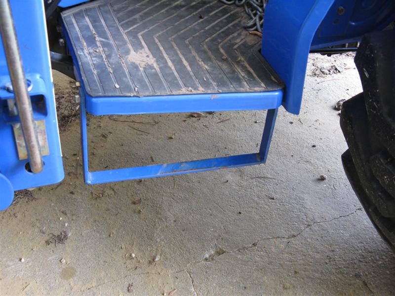

Nice work!! You well sure like the step. Also thanks for the small pictures, us guys with dialup can look at them.

I prefer to call it 'beer holder' ........ but great ideas anyway ! :thumbsup:

This weekend I made a step for my 2000 TC30 similar to yours. I haven't painted it yet. I wondered about the step swinging in when I went to step on it - my arthritis makes me very stiff so I thought I might be shoving it in with my foot when I went to climb up. So I found an unused hole on the foot plate and dropped a rod down to the side corner of the step- works ok.

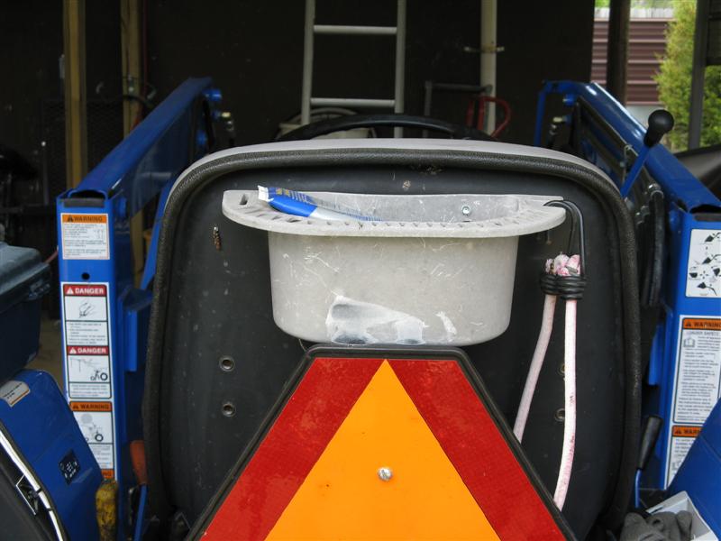

Great to see your post. I like your toolbox on the fender- I was wondering what to do about a tool box, and also your carry all on the back of the seat!

That toolbox is just like any toolbox you can buy at any hardware store. Drill some holes though the bottom and bolt to the fender.
If you go with a plastic one vs a metal one and run into something it should break before bending your fender.

I have a larger metal ( Looks like black diamond plate ) toolbox on the other fender of mine . On the back side of it , closet to the seat , I bought one of those cup holders they use in boat's that swivel in both directions . Works o.k. , usually end up forgetting my drink anyway , it is usually still sitting on the shop steps when I bring the tractor back in .:confused3:
I don't carry a lot of tools in mine , mostly used for various lynch pins , clips , shear bolts , etc.... , think I have a BF hammer , a couple of screw drivers , fence pliers , small bolt type cutters and a couple of wrenches .
Your add on's look good and will most likely make things easier down the road .
