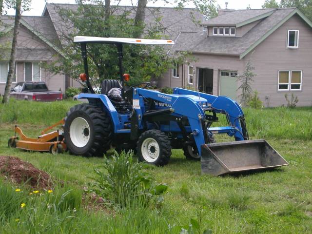

   / TC30 questions #2
I have a TC30 with a Woods RD7200, which is a 6' rear finish mower. I have a 3 acre field that I mow. The TC30 handles it just fine, but in the spring I only get to mowing about once a month and the grass can be 2' high, in which case I do go slow and do not get the same quality cut as I would if I was able to mow on a more consistent basis. Have not used a mid mount mower, so I can't comment on that, but I do like the fact that it is quick to remove the mower from the 3-pt. I also have the Woods 1009 loader, which has a little more lift than the NH loader. It will carry a full load of wet dirt, but it does seem to have to work at it, and you definately need rear ballast. I always leave a box blade on the back, when I am doing loader work. I do not have my tires filled, and have not had any issues with weight or traction, as long as I have my boxblade on. I really like the tractor, good luck
