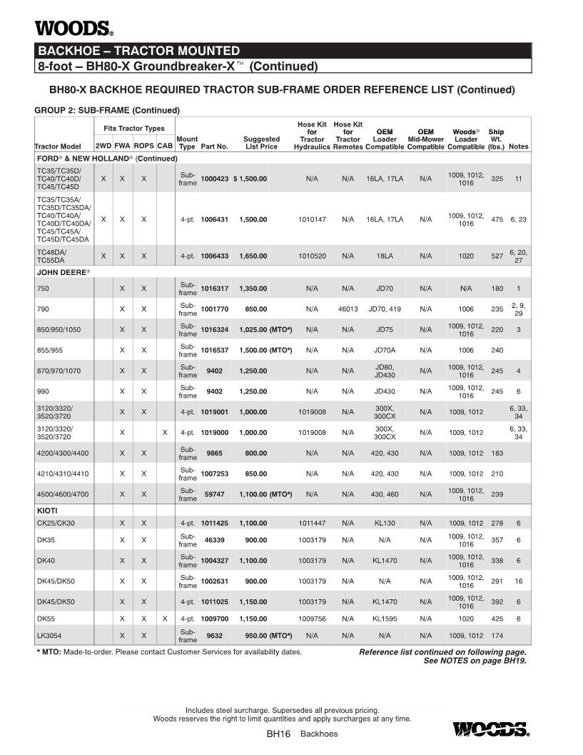

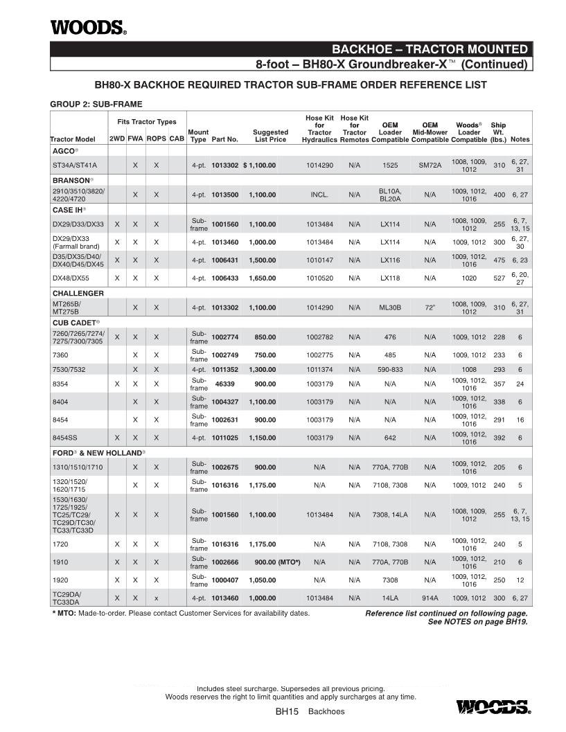

If you are asking about a backhoe subframe, here is Woods reference list for ford tractors. It look like the subframe for the TC30 will also fit the 1530, 1630, 1725, 1925, TC25, TC29, TC30 and TC33. I would imagine other manufacturer's subframes would fit a similar list of tractors.
Here is the link to the subframe manual: http://www.woodsequipment.com/uploadedFiles/Products/Manuals/MAN0058.pdf
