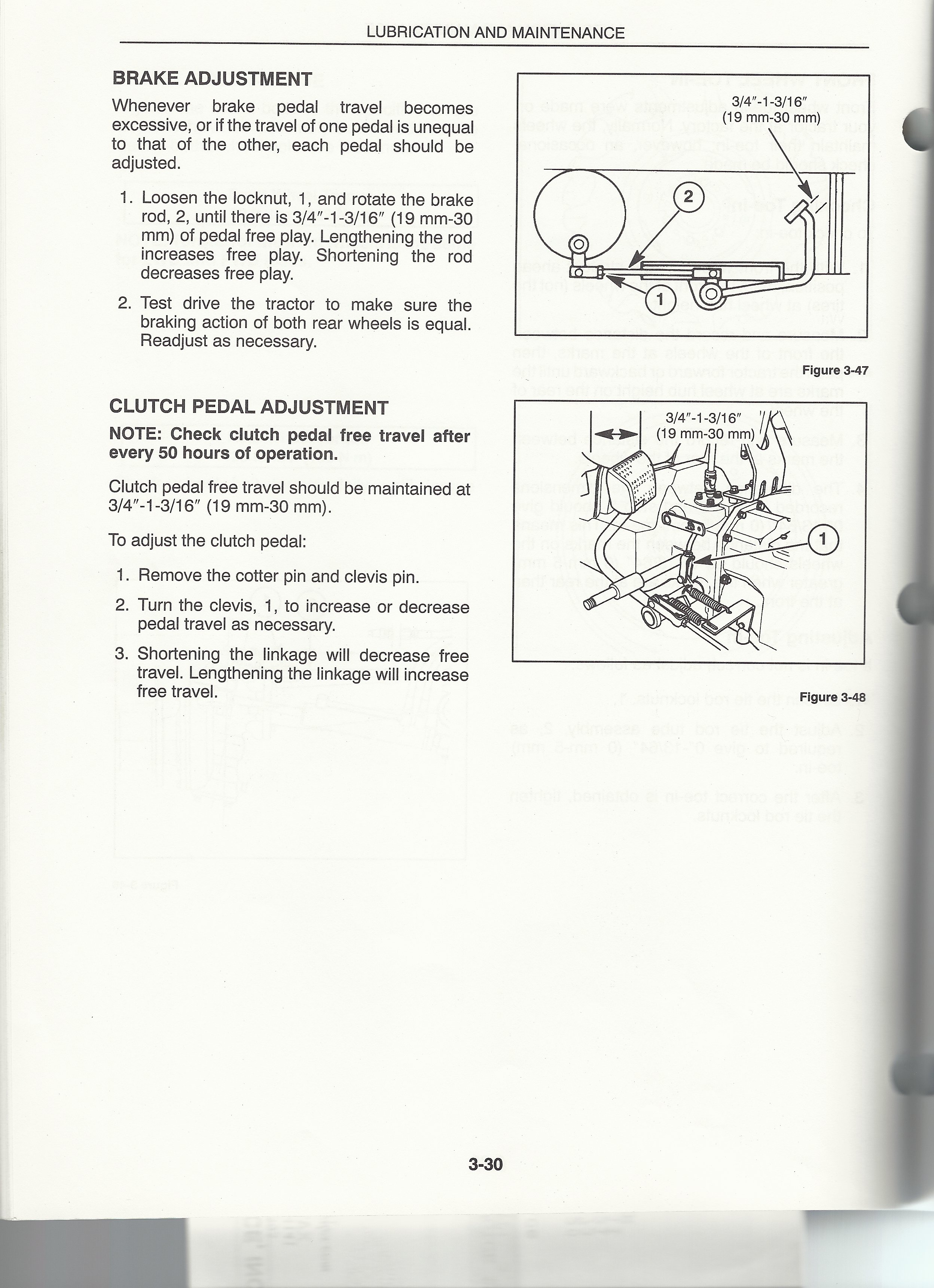

My friend has a tc33d and the pto will not disengage when you step on the clutch. He says the clutch should move a rod that heads towards the back of the tractor but it doesnt. Does anyone know a common cause of this problem. I found a parts diagram online and the part he believes should move with the cluch is the internal shaft the clutch pedal rides on it is conected to a rod that is conected toward the back of the trans or maybe the axle. View attachment 291503
Thats shows the rode and shaft but I dont see how the clutch should engage it.
in diagram clutch is 1 shaft is 3 and rod is 6
any info would be appreciated.

Ok, it sounds like we are dealing with a TC 33 which has the 9X3 manual gear transmission. This tractor has a 2 position clutch, depressing the clutch half way should stop forward motion and depressing all the way, disengages the pto (s). There is the possibilty that the linkage from the pedal to the throw-out bearing pivot shaft is too long (it is adjustable) and the second release position is not being reached. This would be evident if it takes nearly the full depression of the clutch, just to stop forward motion. This would agree with the comment that there is some gear grinding after it is warmed up and you are not obtaining full clutch release for the first position and none at all for the second position. My manual states there should be 3/4" to 1 1/4 inches of pedal free play before you feel engagement of the throw-out bearing. Hopefully, this is the case and a simple adjustment of the linkage will solve the problem. SCAN0071.JPG
   / tc33d pto will not disengage #8
Your friend is correct in that there are 2 clutches, but they are contained in one assembly next to the clutch pedal. You might say the pto clutch is stacked on top of the transmission clutch and pushing the throw-out bearing part way disengages one and all the way disengages both. Again, hopefully it is a matter of adjustmet, but there is still the possibility that the pto clutch is frozen or rusted together and will have to be broken free or disassembled. The 2 position clutch was designed to allow you to engage a mower or tiller prior to forward travel and to shift gears without disengaging the mower or tiller. The parts diagram I looked at does display an inspection hole with a rubber plug near the adjustment linkage. Hope this helps and we have solved the problem.
