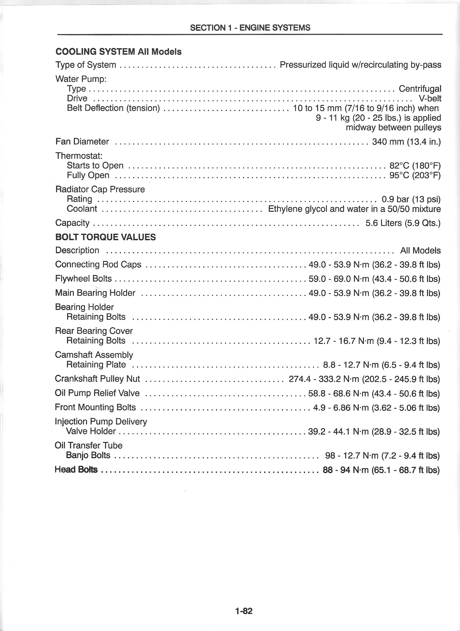

Sep 6, 2013 / Tc33d replacing head gasket #1 J janixon New member Joined Apr 24, 2009 Messages 2 Does anyone have the service manual so that I could get torque setting and bolt sequence for the cylinder head? Thanks in advance

Sep 8, 2013 / Tc33d replacing head gasket #3 T TractorTech Elite Member Joined Jan 26, 2012 Messages 2,831 Location California Tractor Ford 7710, Ford 550, Ford 1910, Ford 4430, KD Forklift, Ford LGT17H, New Holland L255 Skidsteer Sorry for the delay. Had major flooding from the Mountain Fire burn area yesterday and lost power. Anyway, here are the torque specs.

Sep 8, 2013 / Tc33d replacing head gasket #4 pedalstomper78 Gold Member Joined Aug 22, 2010 Messages 448 Location Ohio Tractor Case/IH DX33 When torquing bolts, start from the center and work your way out. Alternate sides and ends and you'll be fine. I have the pattern for it in the manual if you need that.
