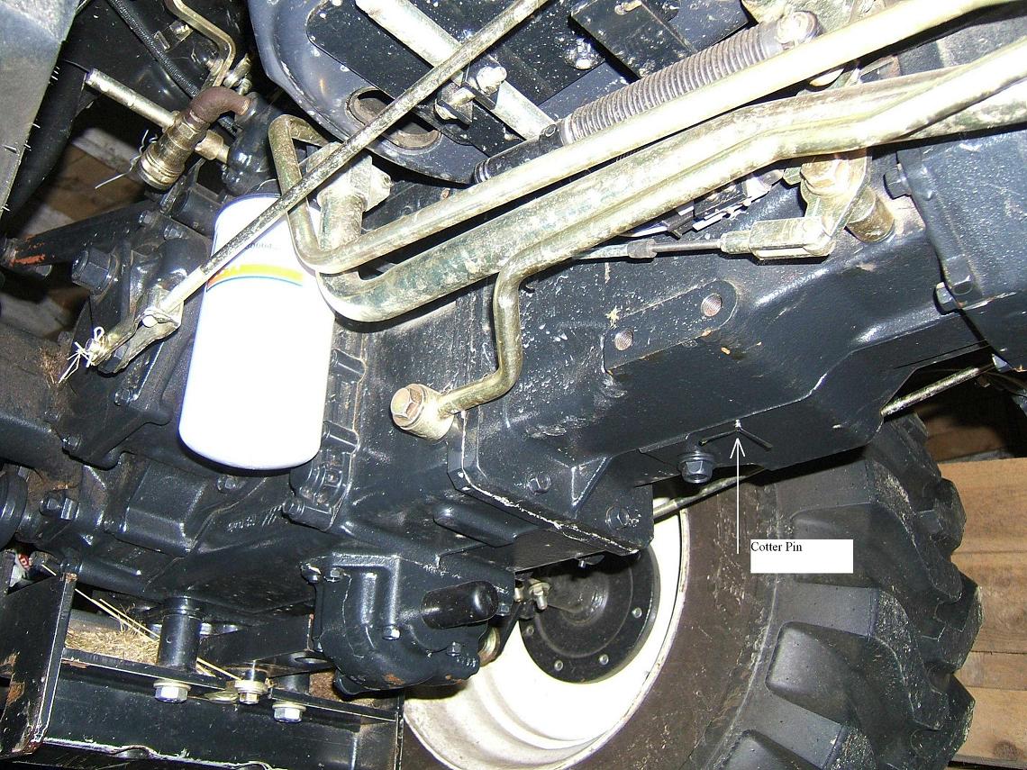

Here is a picture of my cotter pin location.

   / TC33DA Leaking Oil #7
That is a tell tale hole . It is there to tell you that a seal is leaking , the cotter pin just stops it from clogging by way of jigaling (sp?) If the oil is black it is comming from the rear main oil seal at the back of the engine . If it's clear it's comming from the input shaft of the gearbox , and yes it is something to worry about .

When I had fluid leaking there, it was from the HST pump seal. It was replaced by my dealer under warranty, but kept weeping.
   / TC33DA Leaking Oil #10
That particular cotter pin is located in the front transmission case, which houses the HST transmission. So I believe, like Kris said..."When I had fluid leaking there, it was from the HST pump seal. It was replaced by my dealer under warranty, but kept weeping." the HST pump or trans is leaking.
As for your question of how much is too much? If you only have an occasional 1-2" spot, and it doesn't appear to be getting worse, it should be fine as long as you keep an eye on the hydro fluid level. Your dealer may have told you it's no big deal because it will require splitting the tractor to repair. Kris also mentioned his leak was repaired once and it still leaked. I'm guessing here, but...Maybe your dealer has BTDT once or twice already and doesn't want to deal with it??
When did it start leaking? How may hours when you first noticed? The reason I ask is because I have a TC24DA that leaked a 1-2" spot the first day I had it. Brand new, with only a couple hours on it. Each time I used it , it got worse. Shortly after, we got hit with a major snow storm and I spent a few hours plowing my driveway. Parked it in the garage and next AM there was a spot 1-2' (yes feet, not inches) wide. Didn't even make it to 10 hours and I had a minor leak turn major!
Split the tractor and repaired it myself...the input shaft was leaking, which is located in the clutch housing, directly behind the engine. 350 hours later...dry as a bone, no leak whatsoever. Yours is located further back and requires further disassembly to access.
