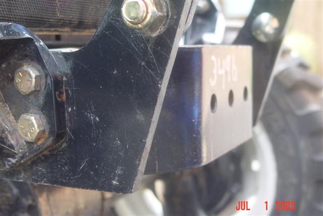

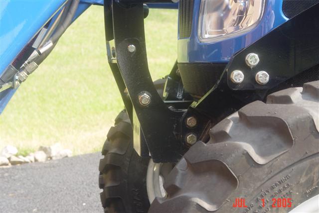

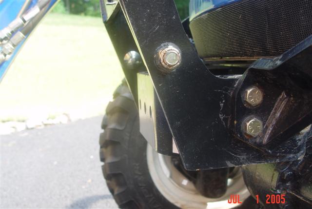

Seacove here are three pictures I just took of my grill guard, you can see how it was cut down.
   / TC33DA - Tires hitting grill guard #7
Number 2
   / TC33DA - Tires hitting grill guard #8
Number 3
