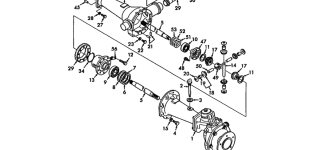

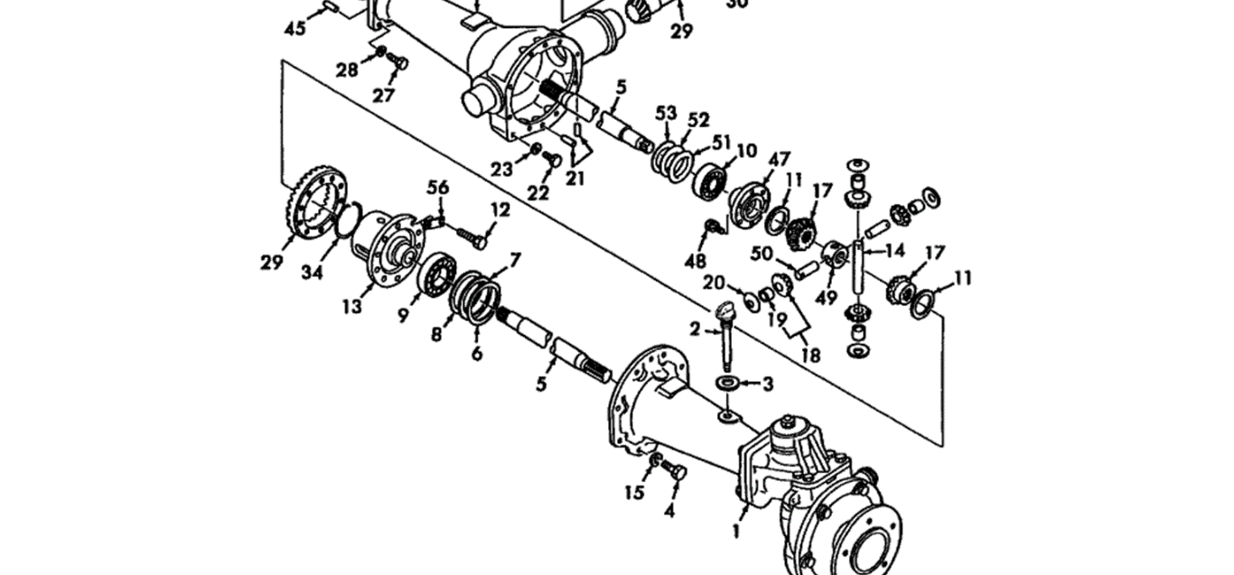

It looks like the driver side housing unbolts from the center section to access the differential, bearings and thrust washers. R&P's are sold as a set so obviously the pinion gear would have to be set as well. The set is $650 from Messicks...WOW!
I've had one final drive apart from #1 in the link photo on down. It doesn't look like both sides need to be dropped, but I've been wrong before. I think I'm going to give it a shot. I've set up R&P's on Dana 60's and Toyota LC diffs. Hey, how bad could it be?
Edit: Ah...there's c-clips on the outer ends of the axles. Finals have to come off.

I'm mulling over the diagrams on Messicks and I was wrong about the c-clips. Think I'll try to yank her apart. Maybe one more cold one first.
