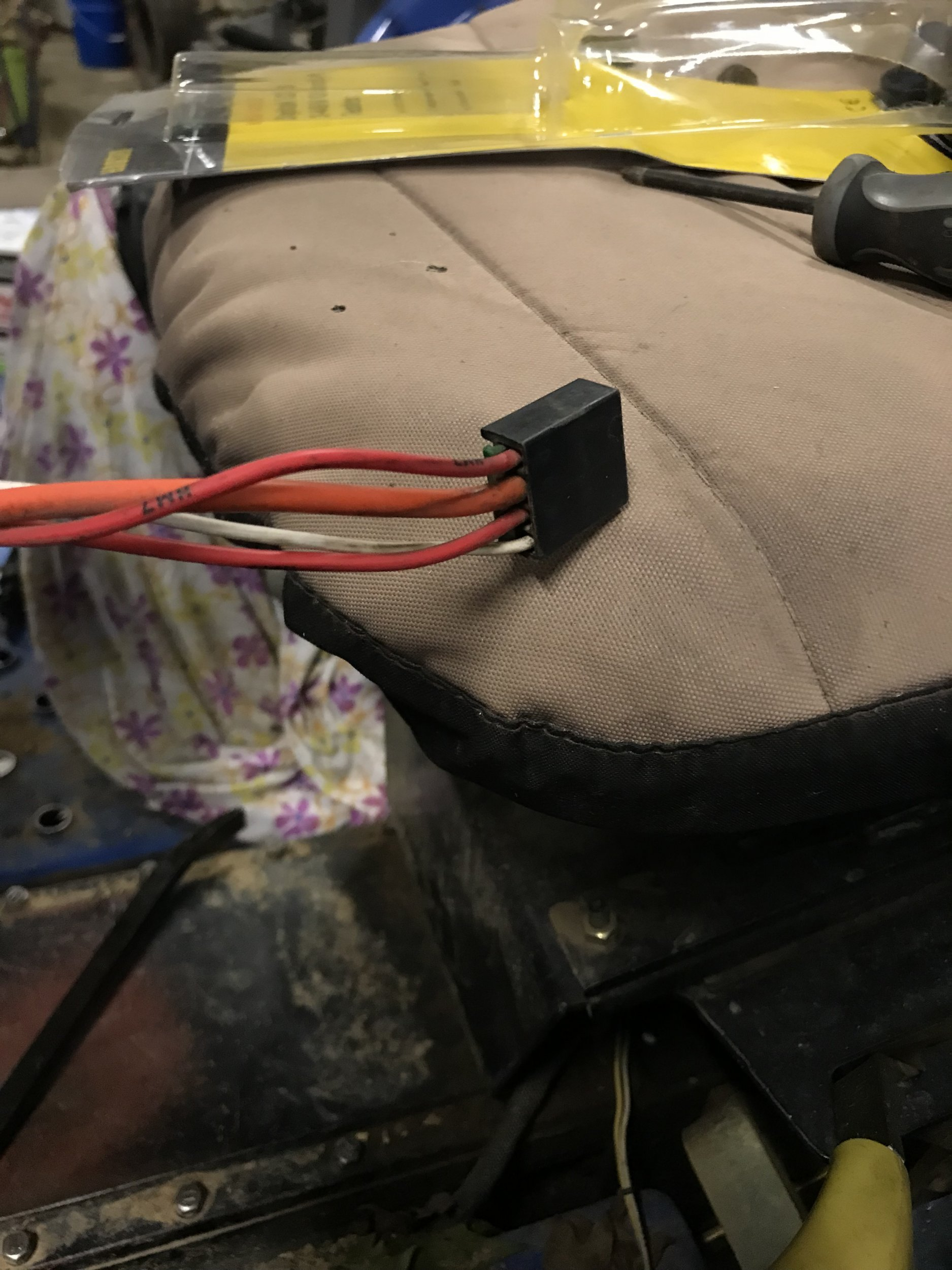

About a year I took my 2002 TC35D to a local Kubota dealer to have some minor work done. The nearest NH dealer is over an hour away, and I figured they could handle it. For the most part, they did. Except that the ignition switch failed while in their possession, so they installed a Kubota switch. It basically works, but it's junk. The biggest problem with it being that the key is not locked into place when on. I have already lost a key in the field. Fortunately, I had a spare key to shut down the machine. The other problem is that it is a 4 position switch (ACC / OFF / RUN / START), and the original had a 3 position (OFF / RUN / START). I would like to go back to an original style switch. -current p/n 86405634
The issues: The OEM switch is set up for a proprietary 4 prong connector that was cut when the Kubota switch was installed. "Why don't you just buy the connector and splice it into the line again?" you ask. The connector p/n is not identified as a standalone piece. It is only a component of the wiring harness which sells for $1000.
Finally, the questions. Any 1 answered will get me moving forward:
-Does anyone have an idea of the part number for the harness end of the switch connector?
-Alternatively, can anyone tell me particular post labels (A,B,C,D) for the OEM switch? They are not labeled on the switch themselves.
-Can anyone identify for me which wire goes to which post?
-Can anyone identify a comparable 3 position, 4 post key switch that would be a suitable alternative? The most common aftermarket switches are only 15 amp and 3 poles that I don't think could handle the load. 4 position switches are more common.
Thanks in advance.

Starting from the top down #1-red, #2-orange, #3-red, #4-white
I had ordered a different ignition switch to replace the one on my TC40. As the ones that New Holland’s has are extremely expensive and don’t hold up well. I had order one from a case tractor. Looking at the old New Holland switch and wiring, I found that the two reds tested hot with the same voltage, these being the top or #1 and #3 line. I found that the white wire or #4 wire is the starter/solenoid wire and uses the top or #1 wire for power, this happens only when the key is turned fully right to engage the starter. The second #3 red wire supplies the power to the orange #2 wire.
The new switch has a BAT, ST, IGN, ACC, GRD posts on the back of the new switch. I found that the white wire hooks to the ST post, orange wire goes to the IGN post and the two red wires to the BAT post. I had to scratch my head about the two separate red lines, other than making it difficult to swap the switch out along with the larger gauge orange wire. It is because of this that I will use both red wires on the same terminals.
I made jumpers to connect the new switch to the old terminal block and tried just one red each time, the tractor started and shut down with either red wire and the glow plug light did come on.

I bought one from Amazon Case 282775A1, which has the typical metal case. The switch mounts with the key hole horizontally and is under 20 bucks. The switch has an accessory position, but nothing is wired to it. have no problems with the switch to date. The unit sees a lot of use. The terminals should be marked on the switch and wire it as i show above
   / TC35D Key Ignition Switch Questions #10
keep in mind that almost any basic switch can be use but, you'll have to cut the new holland plug off and install female crimp terminals on each wire. Both red wires will mount to one terminal, so you'll need a female crimp terminal that has a male spade on it
