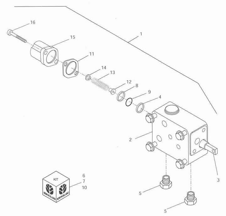

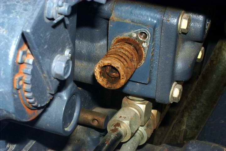

The remote hydraulic lever is probably stiff because the remotes often take on water and they need the return spring cleaned. I've included a picture of what mine looked like. Take the two screws out of the round cover and remove it to see if yours is also gummed up. The dealer should know this, but if not it's easy for you to do and you might use the stiff lever as a bargaining point. I cleaned mine up and it works as good as new. Pack this area with grease and it will help prevent problems after it is cleaned and working again.
