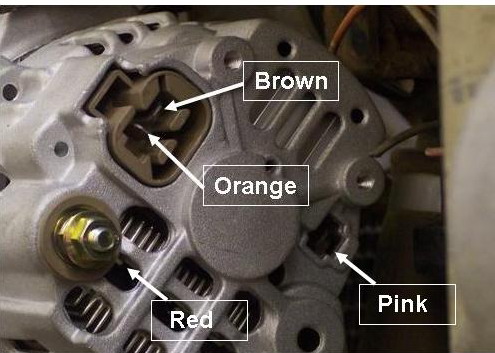

Anyhow, I now have a tach issue, I think it is simply the lead from the alternator, but, don't know where the red wire connects on the alternator, any info?

The tach lead should be a yellow wire and it connects to the alternator just below the battery charging cable on the alternator.
Your wire might not be yellow but that's the last color I remember the tach lead as.

I think mine is pink.

You're probably correct Jim. I'm not sure when the colors changed or if there were other colors used. It depends on the model changes and part # changes. :thumbsup:

Jody, I've sure learned that you can't compare old to new in many instances. I think the photo below is the right alternator. The connection marked "pink" is the one for the tachometer unless NH started using a completely different alternator.
