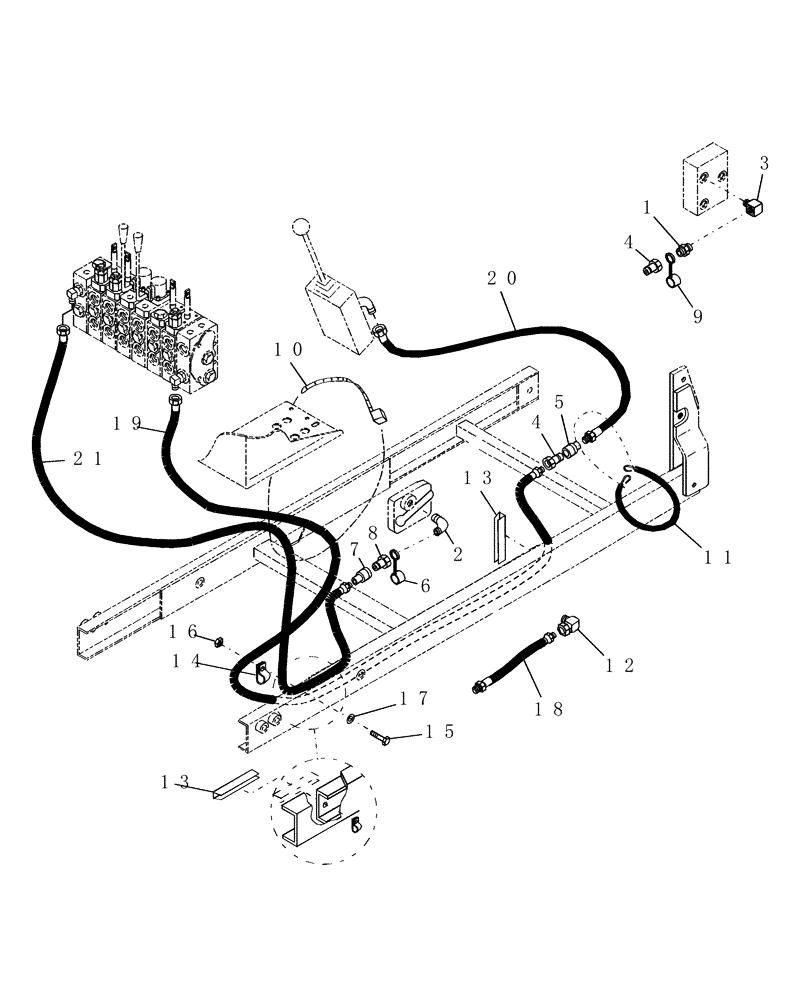

I recently purchased a used NH 758C backhoe for my TC35DA and am having some trouble figuring out the hydraulic connections. My tractor was not originally equipped with a backhoe and does not have any rear remotes.
As I understand it from searching this site the backhoe is connected using the "power beyond" circuit that normally powers the 3 point hitch. I have acquired the necessary hydraulic components from Partspring (see attached parts diagram) and have identified the power beyond port #7 on the Diverter Valve for the pressure side connection. What I cant seem to identify is where the 1/2" hose, item 21, from the Back Hoe connects to the tractor to return hydraulic flow. The service manual I have doesn't address the Backhoe connections and as I understand it there was a service bulletin that describes the installation but I cant find it anywhere.
Does anyone have any experience with this kind of upgrade or if someone has a TC35-45 tractor, could you take a look and maybe take some pictures to guide me.
Thanks in advance,
Len

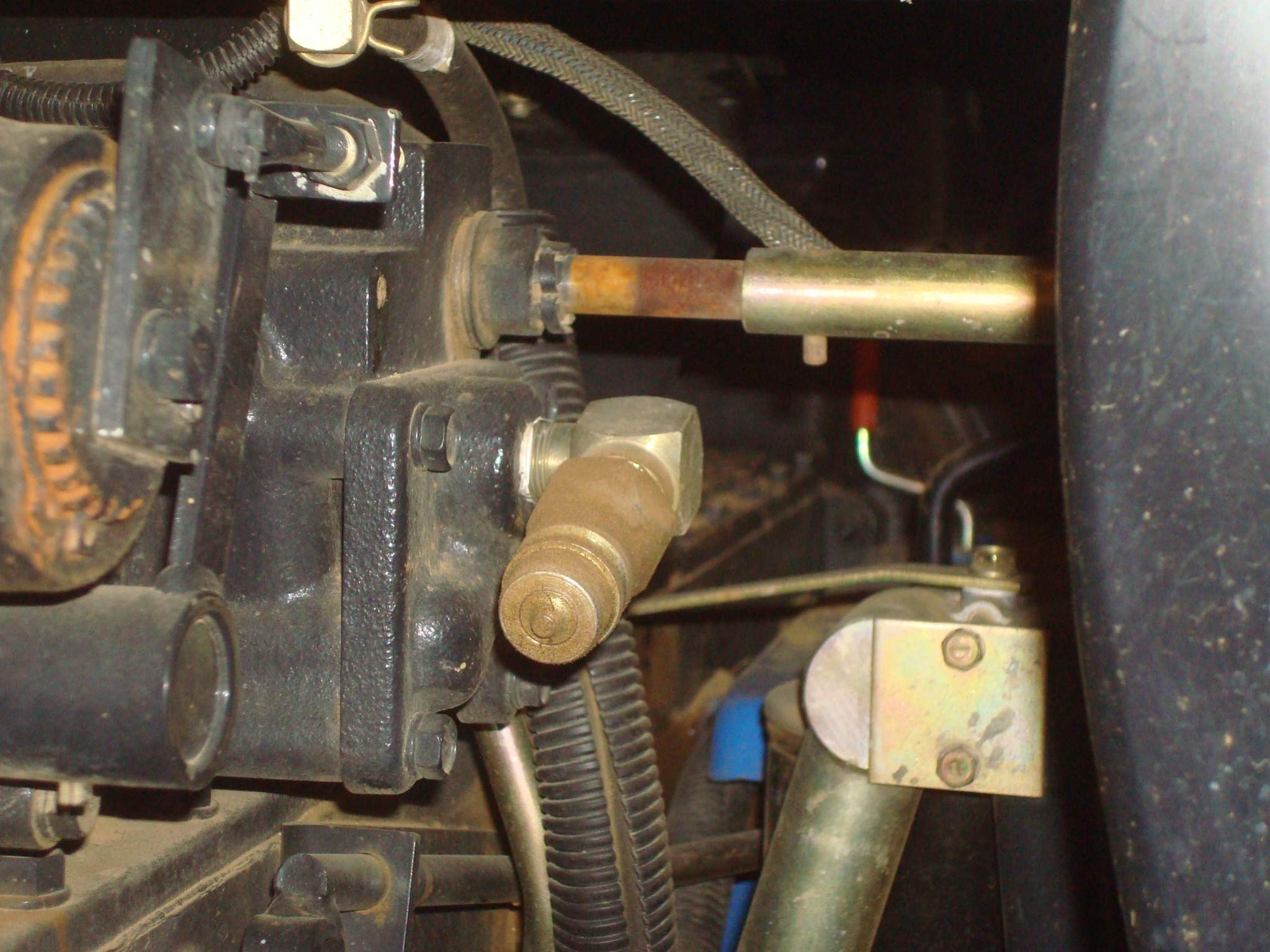

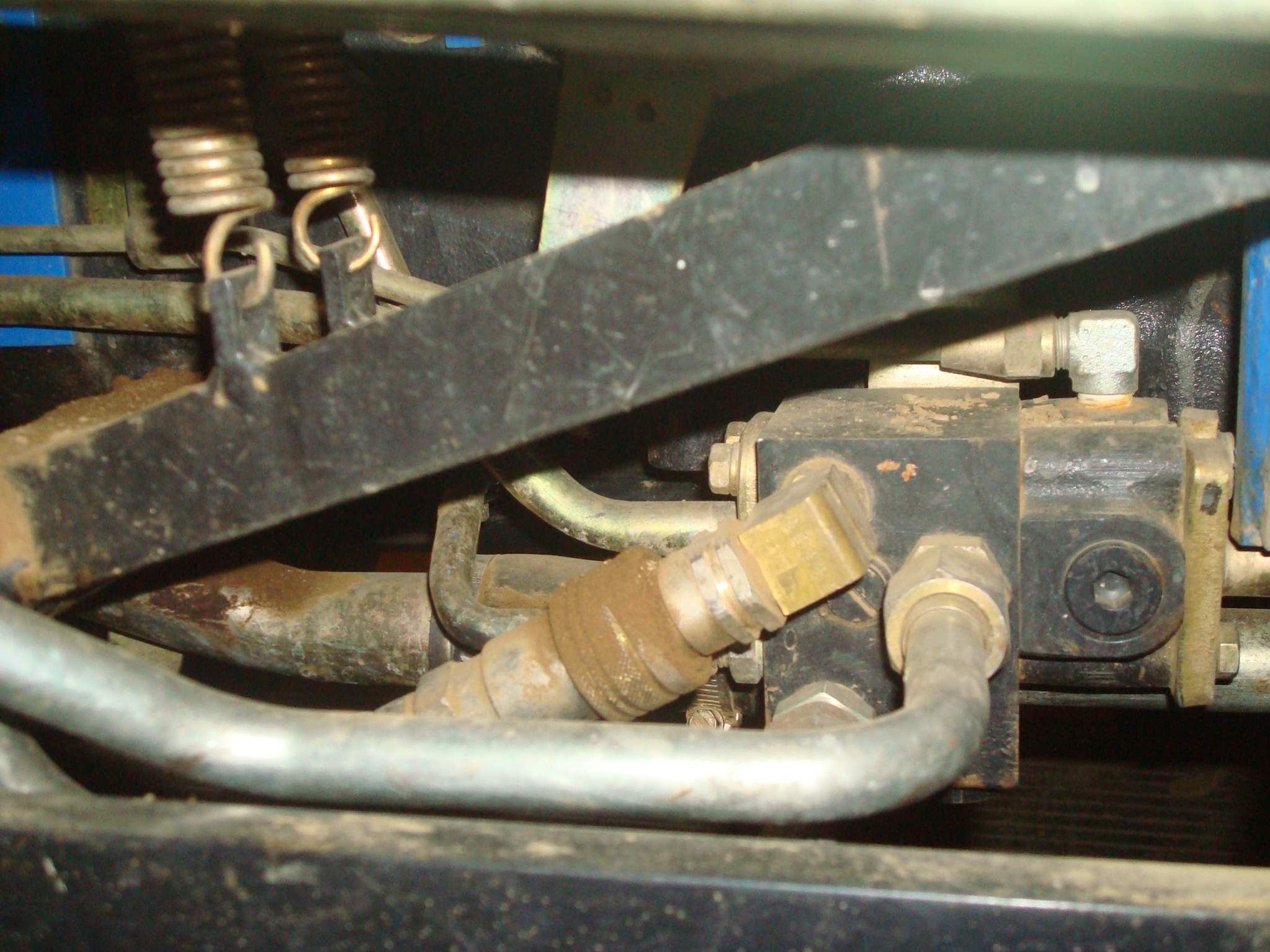

The pics are from my 2003 TC40 gear with a 758C backhoe. Hope this helps. Sorry about the dirty tractor.
This male coupling is where your hose 21 would attach. It's piped to the body of the casting where the 3pt control lever attaches.
This female quick connect is disconnected and the second backhoe hose (#19) leading to the front of the tractor along the subframe rail is connected to it when using the backhoe. When done with the backhoe, put the female connector back where it was.

Dave1949, thank you!
That is exactly what I was looking for, problem solved.
