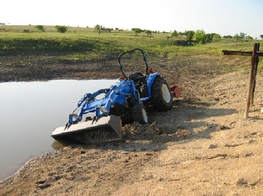

Here's a photo my neighbor took of my stuck tractor.

Well, for your information /forums/images/graemlins/wink.gif the photo was taken before we started to pull it out. As we began to pull, it dug itself in right up to the frame on the right (downhill) side. The left (uphill) tires remained on firm ground, which means that the darn thing was nearly ready to roll right on over into the water. I can't believe how soft that mud was on the right side. We actually chained the left side FEL frame to the nearby dock to keep it from rolling over as we pulled on it. /forums/images/graemlins/shocked.gif
It was a very stressful mess.
