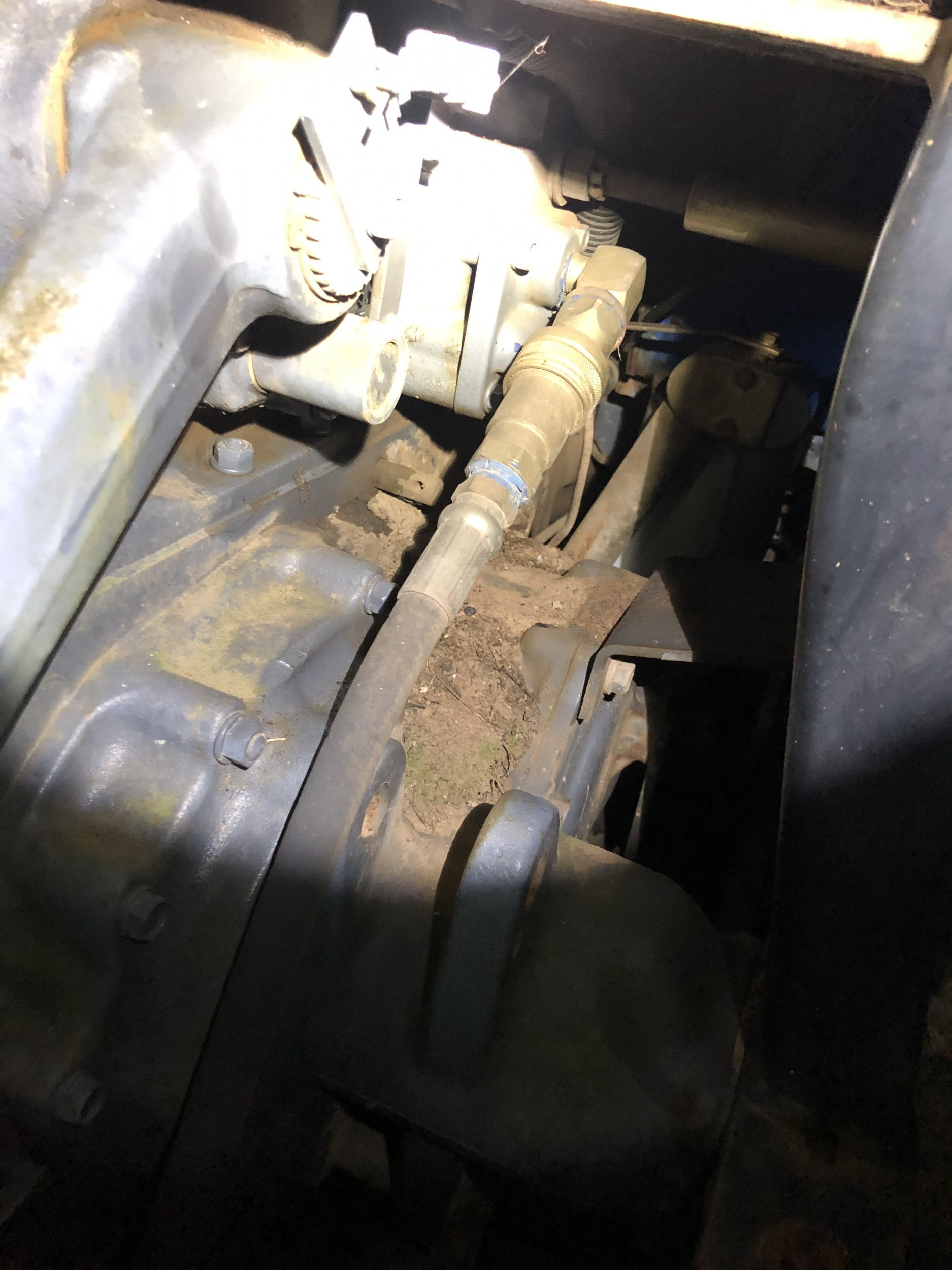

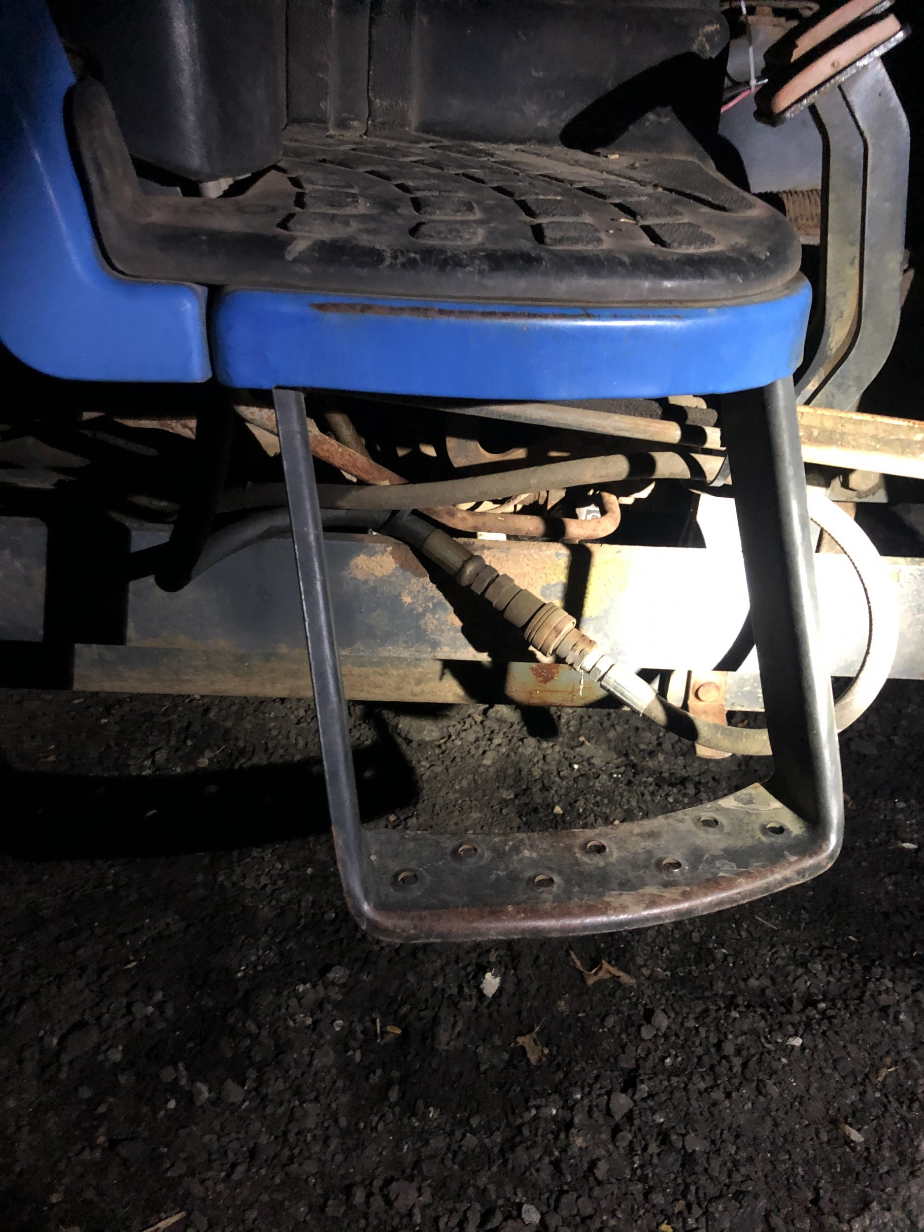

I am new to the forum I have a tc40 that sat for 6 years trying to figure out how to work the 3 point and what the process is to remove the backhoe can’t find any info ?

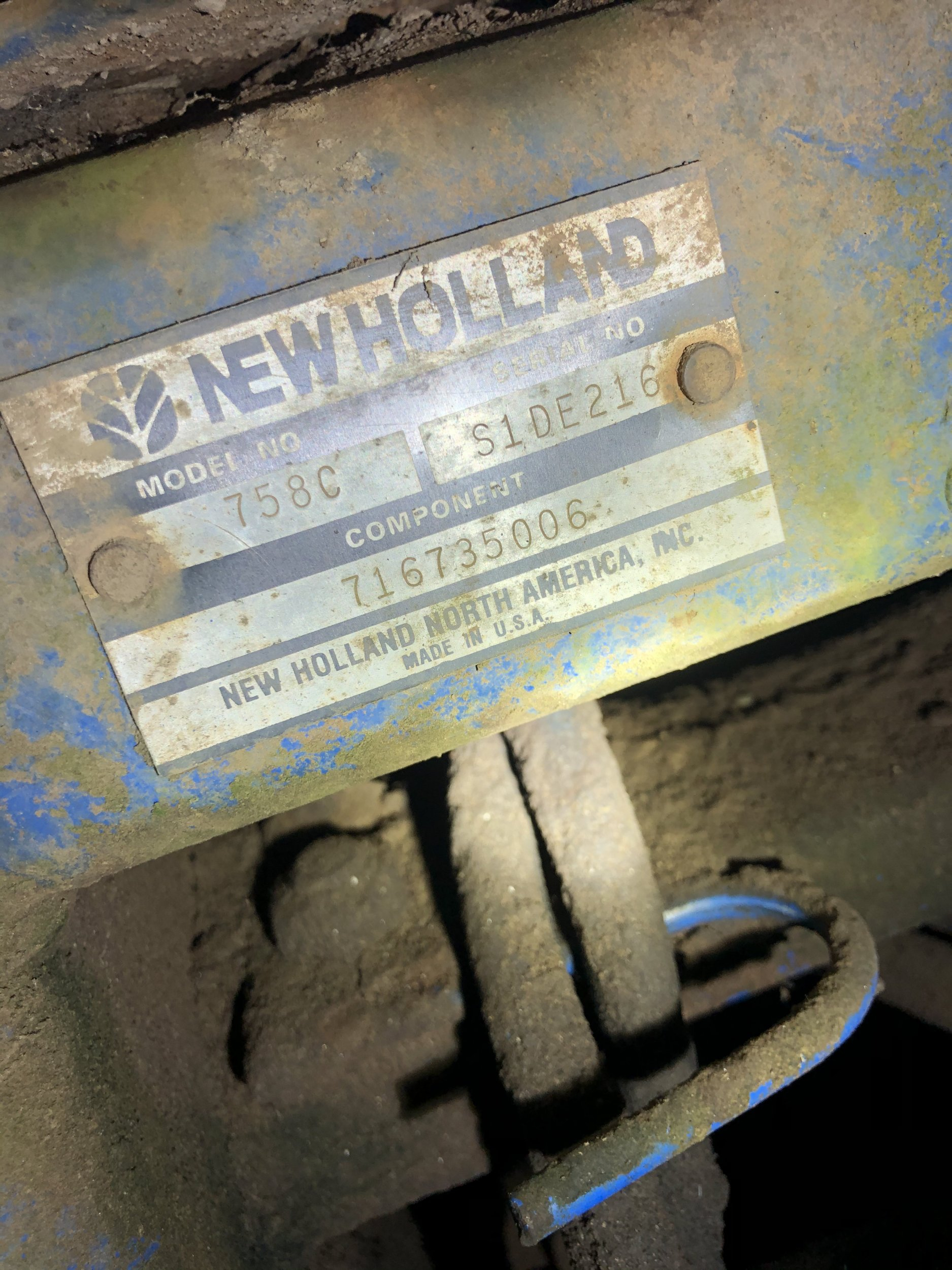

What backhoe do you have? Is it a 3-PT mount or is it a NH backhoe with a full subframe?

What is the model on the backhoe? Can you find a sticker?
758c full subframe I understand how to take it off. Someone said I have to reconnect the hoses after disconnect or it will damage the hydraulics? The front hose isn’t long enough to reach the rear fitting The tractor is hst

Does this help? https://www.rhinoag.com/wp-content/uploads/2017/03/2-6739-Backhoe_Hydraulic_Kit-05-08-07.pdf
The power beyond port simply extends hydraulic capability to other implementS that need their own controls/valves. So when you unhook the power beyond port from the backhoe that must be routed back to the tank return ( ie you are keeping that loop closed). This may be what you are referring to above.
I believe this is what I’m looking for So after I disconnect the backhoe and get a hose made to reach the back port will my 3 point arms raise?
