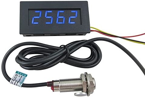

Expect one or two of the inserts to rip out of their place in the cowl. BTDT with my '04 TC33DA. The gauges went wild and we took the whole cluster apart. It did not go back together well or working. Most dash indicator lights work, but I had to run a jumper to the fuel solenoid. Factory WSM ruled out safety switches because it starts with the key and none have been bypassed that I can tell.
Anyway, removing the rt side half required propping the back of the HST pedal up for the front to dip low enough and out of the way. Tachometer reads wild and is no longer reliable. I ordered this so I can determine rpm for PTO use and general info when operating. Amazon.com: DIGITEN 4 Digital LED Tachometer RPM Speed Meter+Hall Proximity Switch Sensor NPN Blue: Home Improvement
