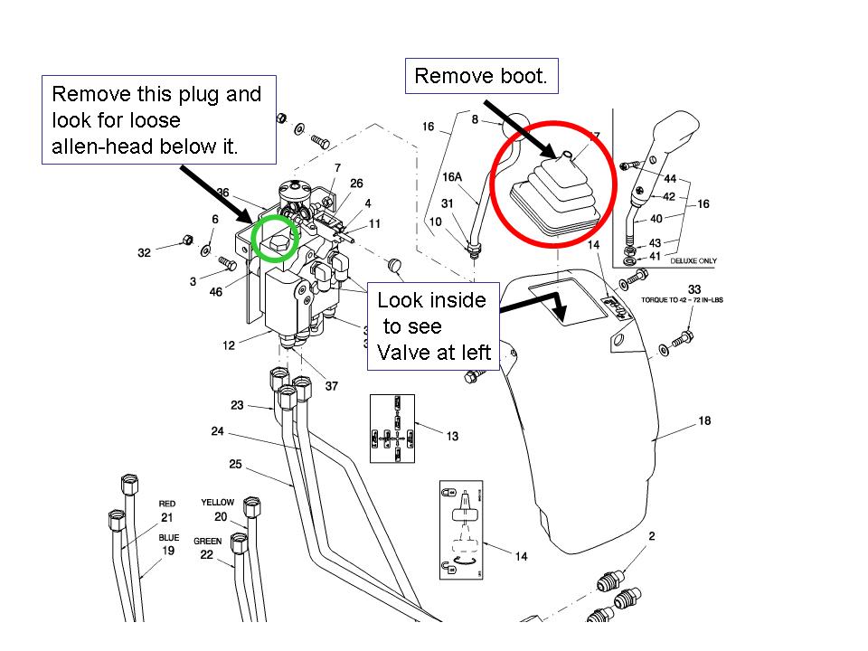

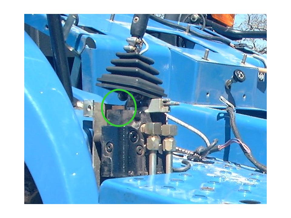

Did your 3PH stop functioning suddenly? Do you have rear remotes and do they work? If neither your rear remotes or 3PH work, you may have a dislodged Power Beyond plug in your joystick valve. The loader is the only thing that works when this plug is dislodged.
The valve under your seat has nothing whatsoever to do with the 3PH raising. It only adjusts how fast the 3PH lowers when you move the lever down.
Here is a photo with a green circle around the hex-head cover that you should remove and check for plug loose. The illustration may also be helpful. As Barry said, you surely need to give more descriptive info and details of what works and what doesn't.

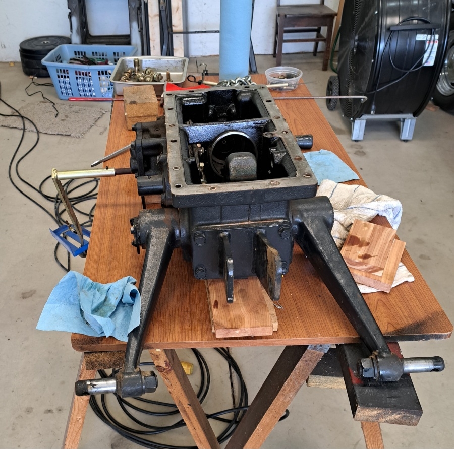

New Holland TC40 3 point just quit working, Loader worked fine.
This is a 10+ year old post, I want to say thanks to post #3! I have been stuck with my 3 point not lifting for 3+ months.
I pulled the 3 pt lift assembly off the tractor, tore down replaced a few o-rings. Reinstalled still didn't work. I was about to spend $850.00
on a valve.. I found this post, the set screw backed out. I am So Happy, problem solved! :)
