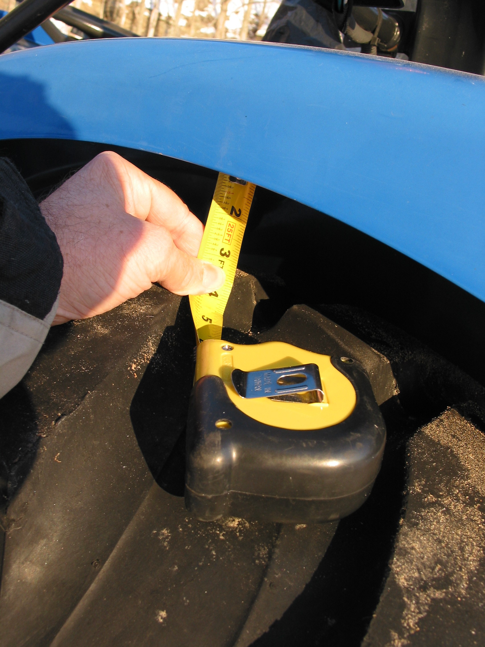

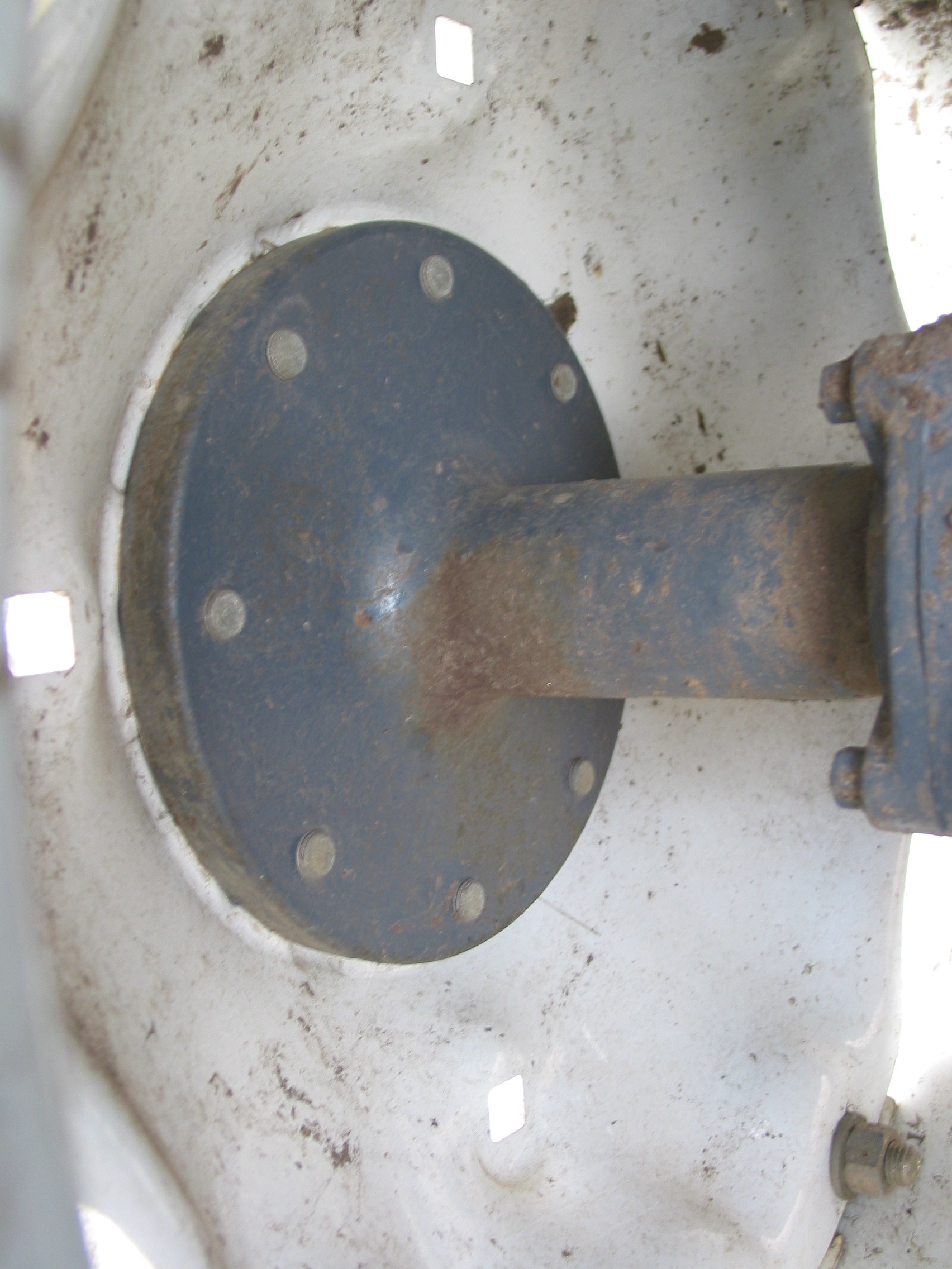

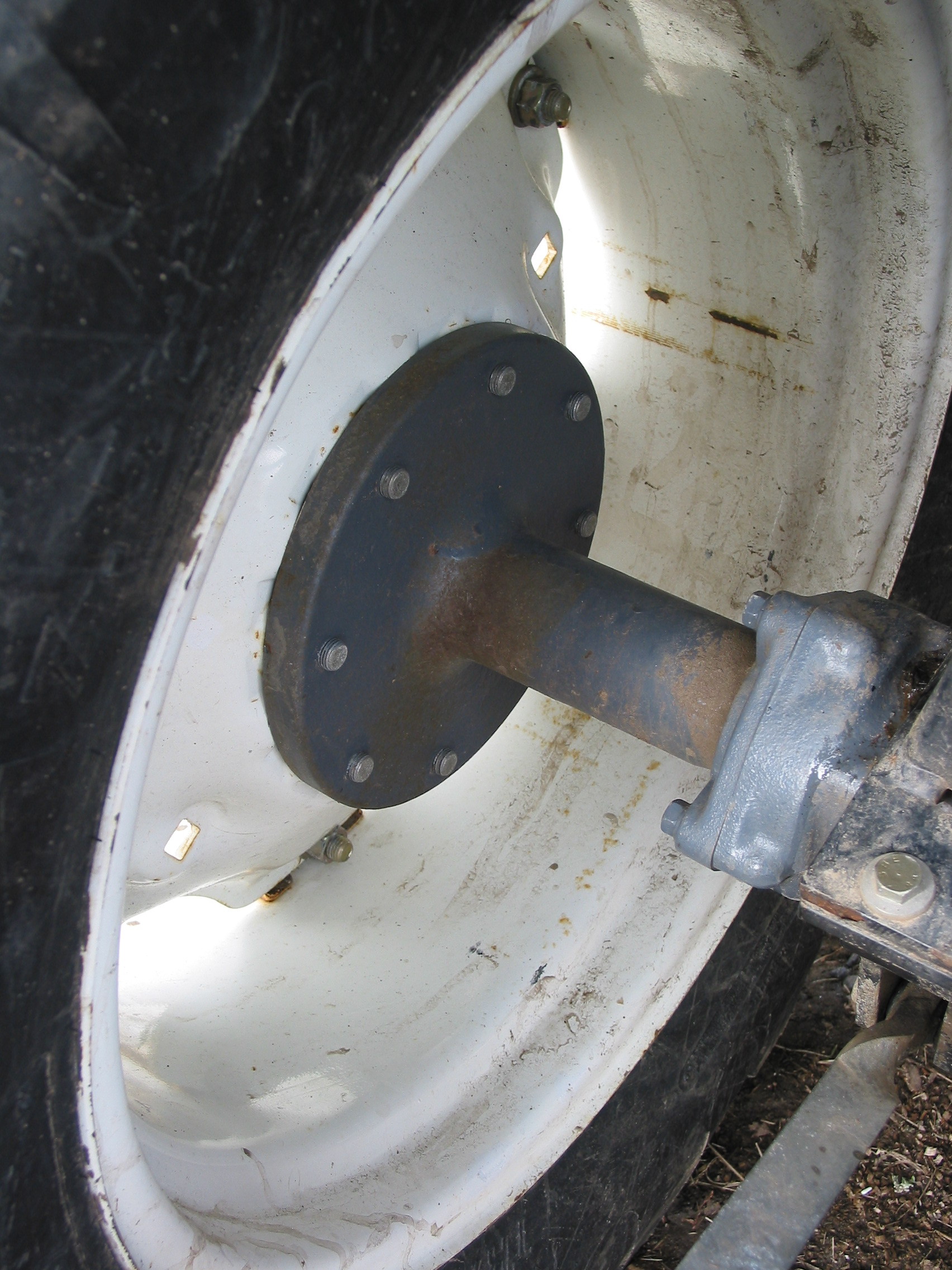

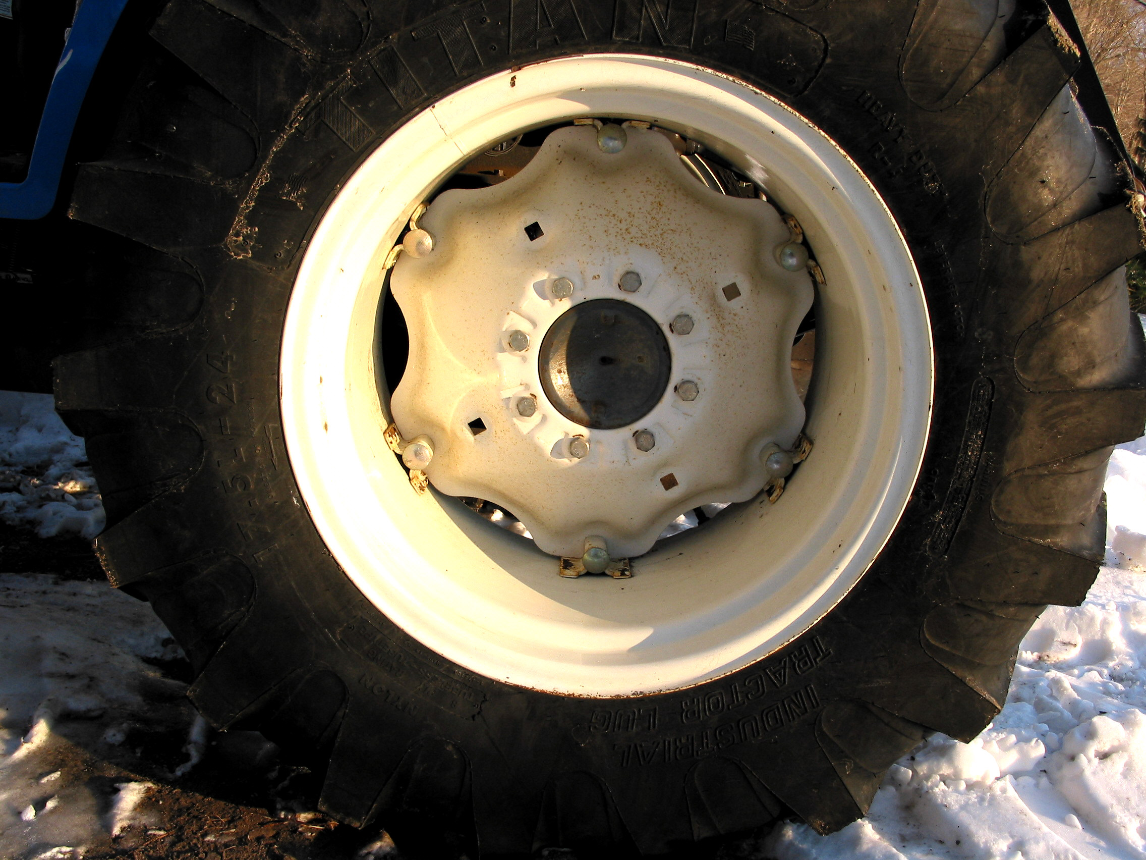

I'm caving in. I just couldn't get a handle on the specific steps to achieve my desired wheel base. Please don't anyone feel bad 'cuz check this out:
I called the service dept. today and they looked at the rear wheel side view pic' I e-mailed and they said I'd need to remove the wheel and the dish and "play around with it" meaning of course flip 600 lb. wheels around and play games with torque wrenches and different positions until I get the right wheel base or bust my legs.
So I'm gonna trailer it over there next week and let the pros do it with big wheel dollies, impact wrenches and big torque wrenches.
I really wanted to learn something; but, I"ll be lucky to get to watch so it's pic's before and after and I'll share 'em here.
Thanks everyone!
Chris
   / TC40D Rear Tire Positions
#11
So, I had it done at the shop and it took 'em less than an hour and was under $50. They did feel a little bad about the clearance issue (chains hit sway bar and broke off a folding plate @ chain end) from their last "fix". I; however, can't figure the difference between what they did with the rims and dishing and just changing them to dished in and they couldn't explain what they did. But I now have 78" wheel base, not the 84.5" the manual cites for R4s dished in,and I can still slide onto my trailer very carefully:thumbsup:
What I can't do is tell anyone how it was done:(. Sure hope they torqued the bolts!
Attached pixs of before and after. Hope you can make sense of 'em
Thanks,
Chris
