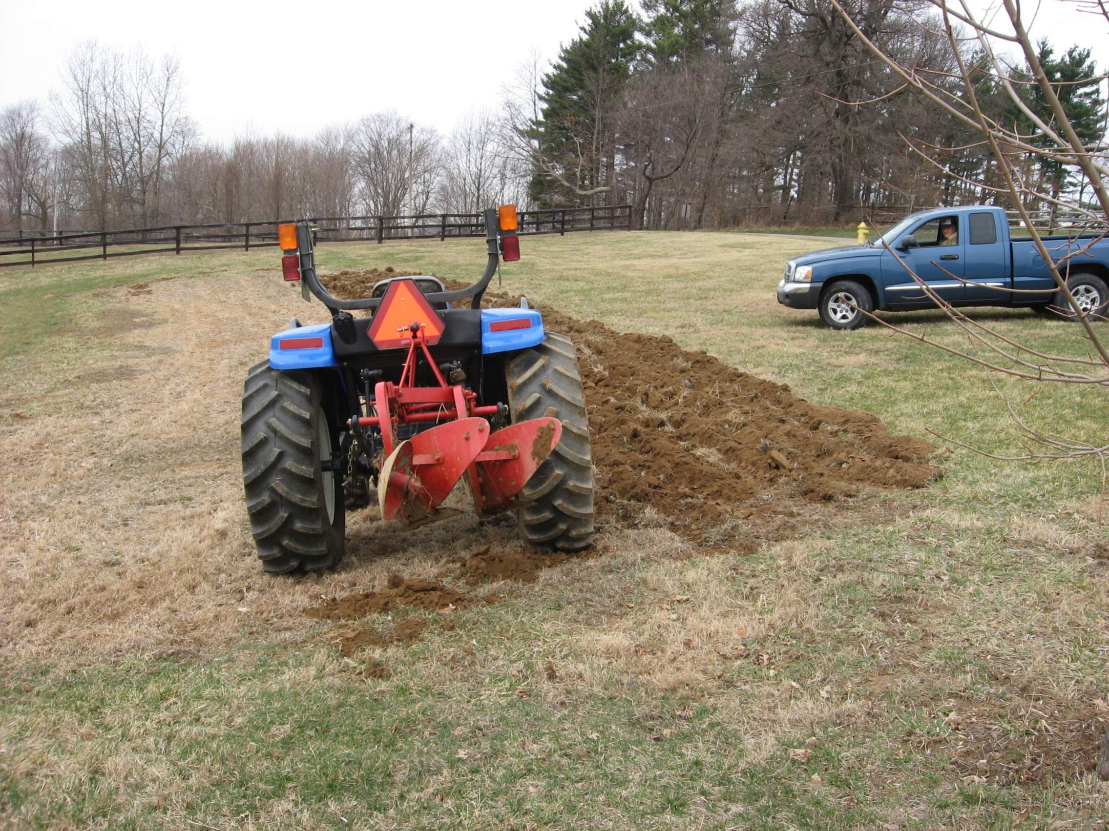

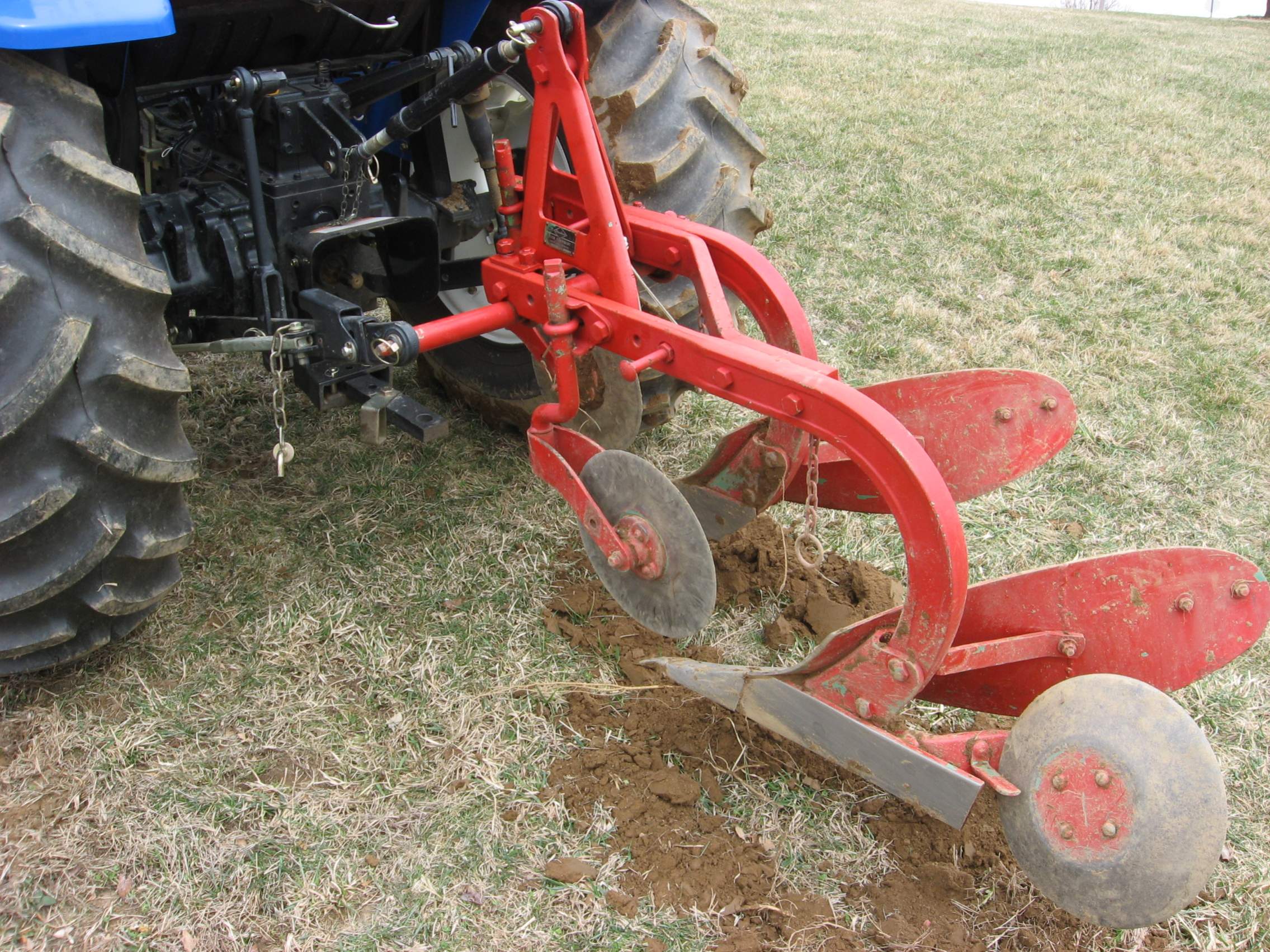

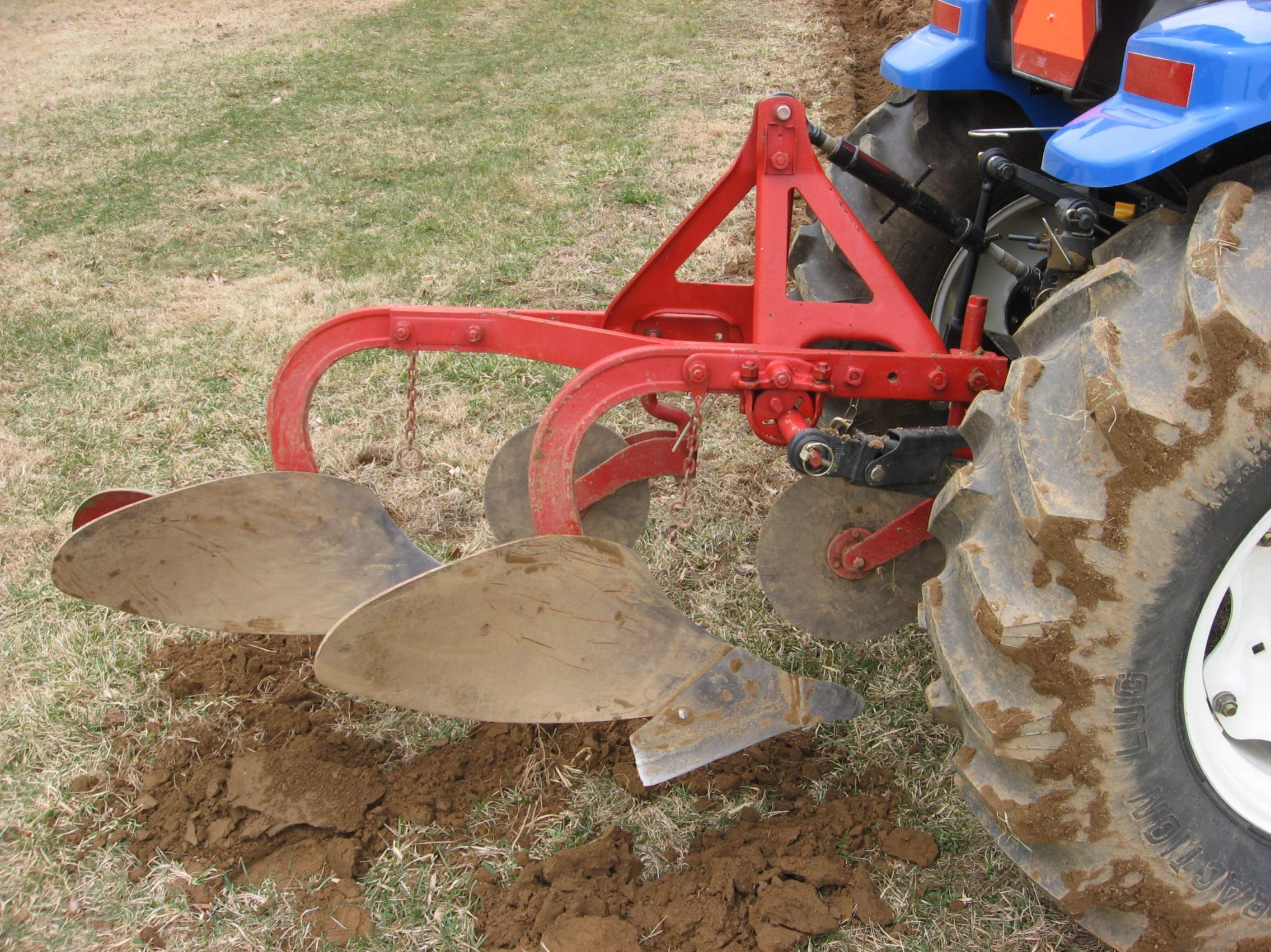

Plowed the garden several weeks back. I have an old Dearborn 10-8 12" 2 bottom plow and many told me this plow would not work well with this tractor but it did just fine. After experimenting with different plow angles the first row or two, the furrows came out great. Every so often a dirt furrow would not flip over completely but the hillside is somewhat steeper than portrayed in the photos and I think If if I add those moldboard extender tabs that will help the situation.
BTW: I normally keep the ROPS up but I keep the tractor in the basement under the house in the winter and had to lower it for door clearance.

Looks like your plow works just fine, nice place you have. What are the chains with the rings on hanging from the plow for?

The chains are for the missing jointer arms that scrape the coulters. I chained up the right front coulter so it would not hit the tire.

If you look at my shares real close you can see where someone had welded on new points at some time. On another board somone said a company makes generic points you can have welded on but I have not seen them.
New shares are available for my plow but they are very expensive. $90 each for cast iron and $200 + for steel. I figure the shares I have will last the rest of my life.

I don't understand why someone would say the plow would not work well with that tractor. It seems you have more than enough power. I'd bet that tractor could pull a 3-bottom, especially with the Ag tires. What did you do after plowing to smooth out the soil? Anything? Plowing is normally just the first step. Discing or tilling will leave you with the perfect seedbed.

A couple local (and internet) "old timers" swore it would not work because the tractor's wheelbase was too wide for "that old 12' plow"- "Those old 12" plows are worthless" that sort of thing. All I did was hook it up, level it up and went at it. Did some fine tuning after the first pass and it worked great.
I just used a Toro 5 hp rototiller to smooth up the seedbed. The garden has been plowed 6-7 times before so the ground was pretty soft. I waited a couple weeks and a few rains after plowing and it went fine.

I don't see anything wrong with the wheelbase of your tractor. In fact, if anything, I think you could go even wider. The right moldboard/share looks as if it covers some of the right wheel, which tells me the wheels could be further out or possibly you could slide the plow slightly to the left on the lower bar, and accomplish a little more efficient plowing.
I see you said you did some leveling, but it looks like it is TOO level. In other words, when sitting on level ground (not in the furrow) the plow should be very unlevel, that is the right side of the plow should be much higher (6-8") or more than the left, so that when you are in the furrow, it truly is running level. If you already know this, or the picture is just giving me the wrong impression, please ignore.
