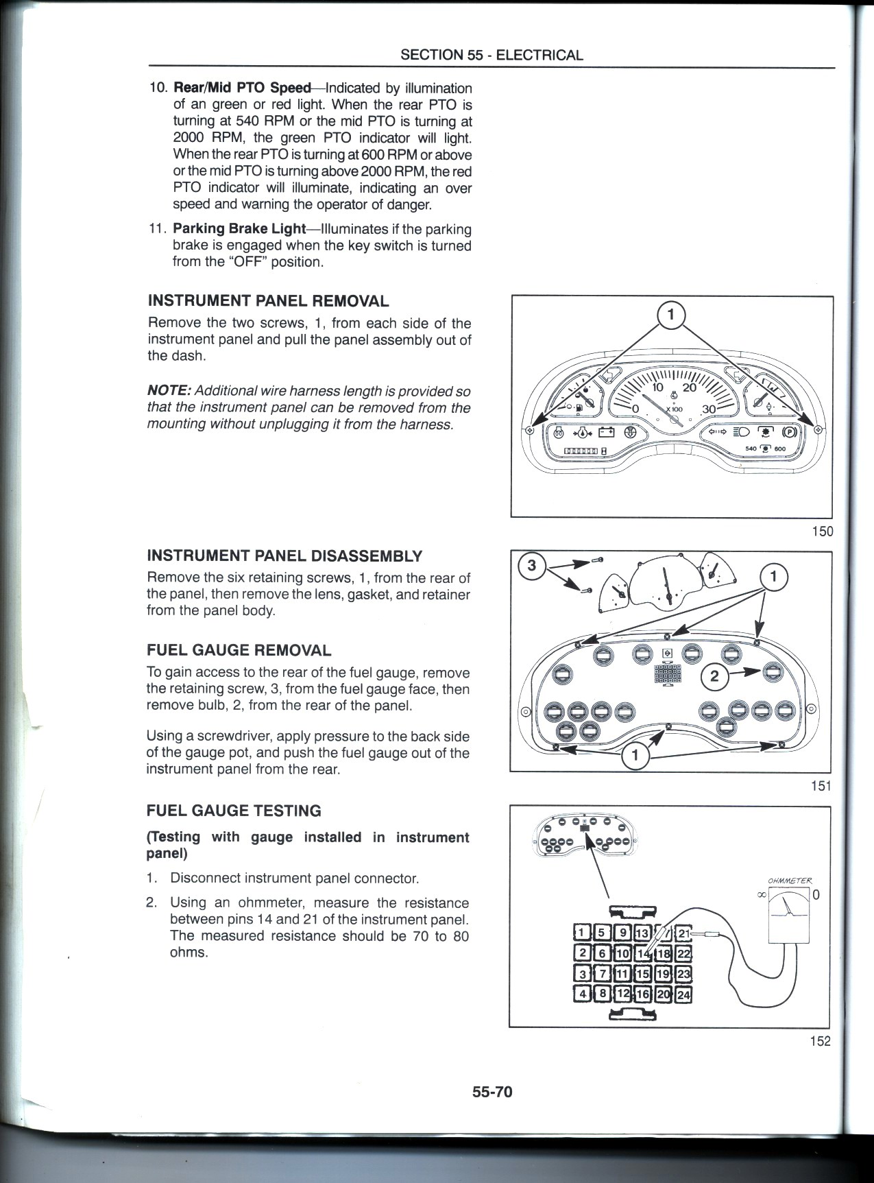

Fuel tank full, fuel gauge reads 0. Fuel gauge reads full if you put the 2 wires together at sender. Then gauge will read fuel until you start engine, rev it up and down a few times, then gauge reads 0. Have 6.5 volts at sender when reads full (not 12 volts) then reads 3.2 volts when gauges reads 0. Disconnected wires and ohms, checks OK. After I short wires at sender gauge reads full, tap on gauge doesn't move until you start engine and rev up then reads 0. Can anybody give me any help. Dealer says I have everything that they would have done except change out gauge, but they say it should be OK from when the wires or shorted out at sender and gauge gos to full.
   / TC45D FUEL GAUGE PROBLEM #2
New Holland's Repair Manual says that that the fuel sending unit in the tank is a variable resistor. When the tank is empty, it should read 245 to 249 ohms. When the tank is full, it should read 32 to 34 ohms. If you want to make a test jig, stop by Radio Shack and buy a variable resistor that goes from zero to 500 ohms or zero to 1000 ohms. (Zero to 250 ohms would be perfect, but they may not have one of those in stock.) Set the resistor to 35 ohms and then remove the plug to the tank float and jumper the resistor to pins A and B into the wire connector going to the gage. Turn the key on and the gage should go to full and stay there. If it goes to full and slowly drops down to zero, then you know the gage is faulty. I think there is a chance that you have a dirty or loose connector. It's a remote possibility, but I'd take out the instrument panel and disconnect/reconnect the connector to make sure it is clean.
BTW: You can also use your VOM to check the resistance of the float. If you hook it to the wires going into the tank with the connector removed, you should be able to watch the resistance decrease as you fill the tank. It may not be completely linear, but you can estimate that the resistance should be about 140 ohms when the tank is half full (249-34=215, 215/2=107.5, 107.5+34=141.5).
If you decide to remove the gage from the instrument panel, check out this thread where I replaced my temperature gage. Also, if you want to do a test of the gage after it is removed, post back and I'll give you instructions for making resistance checks. It's a simple check once the gage is removed.

Here are the repair manual pages with the troubleshooting info.
Oh yes, one more thing. . . If you rev the engine and the gage goes to zero, does the gage go back up when you lower engine rpm? How about if you shut the engine off and then turn the key to ON? Have you looked for AC voltage on the wire? Perhaps an isolation circuit or poor ground in the tachometer circuit is causing AC voltage to be applied to your DC signal to the sending unit. If you are measuring a voltage drop to the sending unit, it would tend to indicate a problem with the bridge circuit for the fuel gage. Are you familiar with how a Wheatstone Bridge works? The sending unit would imbalance one leg of the bridge around the meter and cause current to flow through the meter movement. The fuel gage is not a true Wheatstone Bridge, but the principle is closely related. Here is a link to a description of a fuel gage that is probably more accurate than my description.

Thanks Jim. Just was able to check out the gauge last night. The two terminals that should have between 302 and 352, read in between there then I moved the gauge with the meter still on it and it went to 0. It appers to have a bad connection in the gauge so I should replace it. The other two terminals checked with in the range OK. Thanks again for the great help. Rich
