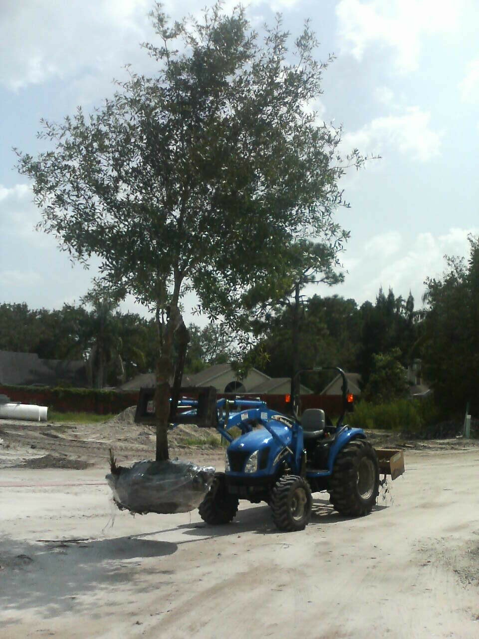

After months of research, I chose the TC45DA with 16LA loader for use at my construction company. After 400 hours of use in many different situations, we are very pleased with our purchase.
The 45hp pairs perfectly with the 16LA loader. When using it for dirt work, it has ample power to dig, lift & move dirt (as opposed to some models we tested which struggled in these situations.) With the loader I highly recommend getting quick attach. The salesman talked me into it & I am glad he did.
The only negative features I can speak of would be the annoying transmission whine & nobs & plastic pieces falling off. Minor things on a well built tractor.
The only down time we have had resulted from not regularly changing the fuel filter. We change ours out every 50 hours now, because we do a lot bush-hogging.
Overall the tractor is very comfortable to operate & performs great in extreme situations. If you are researching tractors in this HP range, look no further. The TC45DA is a beast that is up to any task!
*Check out this pic of the NH moving trees!
-Dave

What kind of attachment is it that is carrying the tree. I've seen the grapple type things that go sideways like that but can't see the pic well enough to see if that is one of them.
   / TC45DA - 1 year later #5
Looks like a boom pole with a strap/lifting sling to me

Nice picture! At first I thought it was a tractor sitting under a tree. That would be a sight to see if you moved it very far.
   / TC45DA - 1 year later #8
Who are you sneaking up on. When I was a sniper we used to put twigs in our helmets, but looks like you take the prize - who would ever see you sneaking up on them behind that tree.:D

That is a quick attach tree boom. We moved about 40 trees that day with a mini ex & the new holland. The boom extends out another 3' which makes popping trees out of the ground that much easier. It also keeps the base away from the grill of the tractor.
