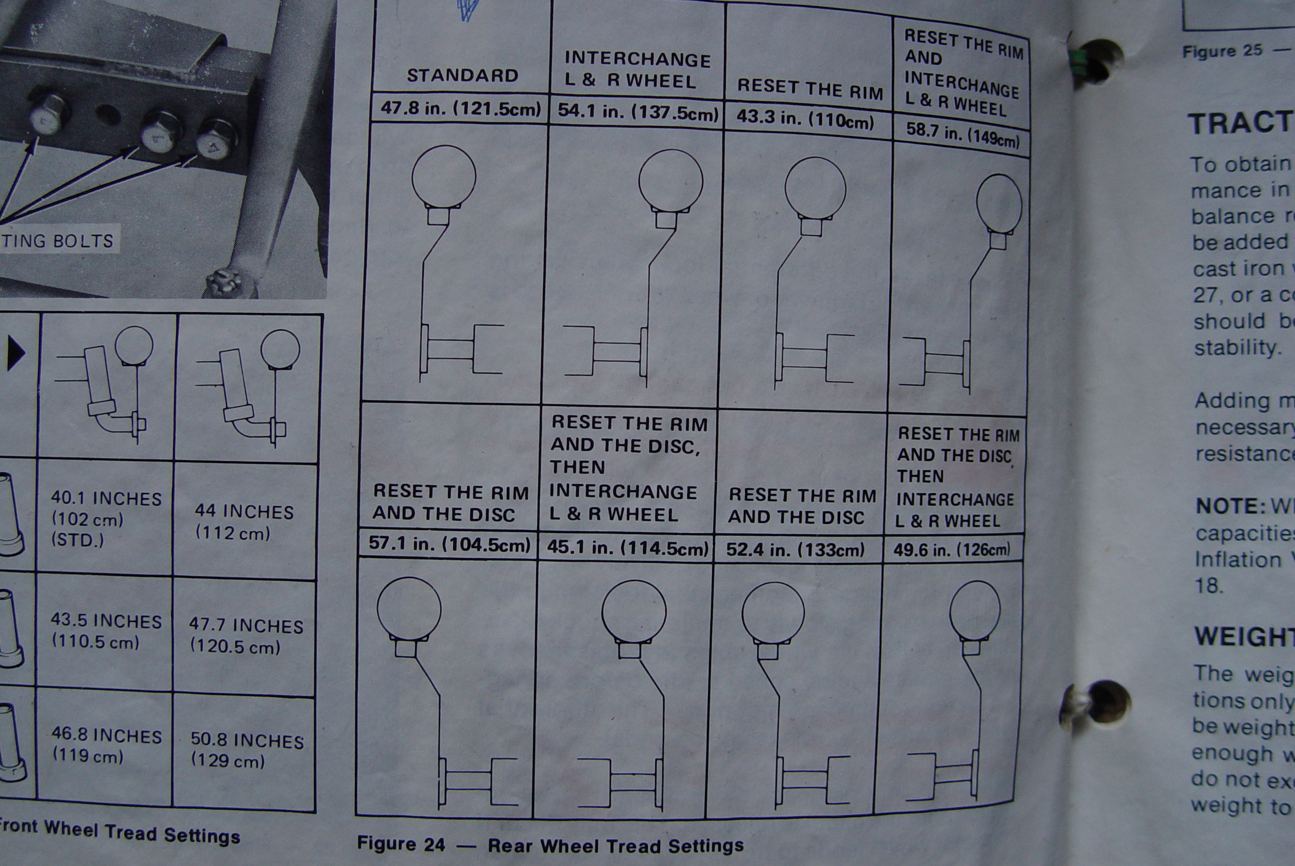

Doesn't your manual have a diagram showing all the possible rim and dish settings with dimensions? It is probably at the very back of the manual.
   / TC45DA/DX45 Reducing Wheel Spacing
#12
I'll look tonight. I have been out of town but will be working on it tonight.
   / TC45DA/DX45 Reducing Wheel Spacing #13
My DX55 manual has a page or so with the specs similar to what Greenland South posted above. But then there is an additional page following those specs, which shows diagrams of each 'rim-to-dish' configuration so it is clear. I'll bet yours has the same diagram.
#14
That's what I'm hoping for. I've never adjusted the dish on a wheel so I'm hoping it gives some instructions on that as well.
#15
Well my manual doesn't have any diagrams or explanation on how to configure the wheels for different widths. Just the same page that was posted earlier. So there are 4 different settings, I'm just not sure how to obtain them. Can anyone shine some light on it?
   / TC45DA/DX45 Reducing Wheel Spacing #16
   / TC45DA/DX45 Reducing Wheel Spacing #17

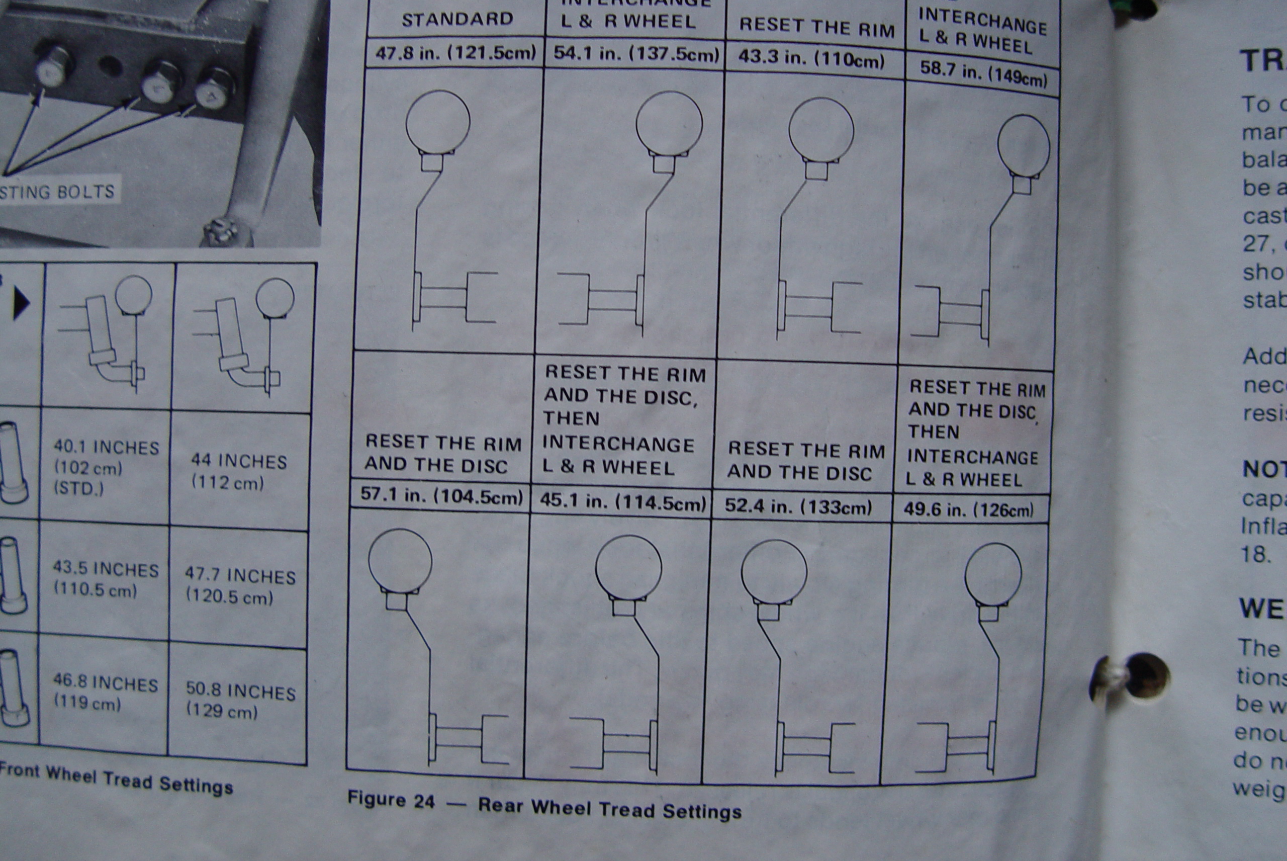

View attachment 512467View attachment 512468 Click on picture to enlarge. This is from a Ford 1700 but it is the same for all Fords only the end measurements will change for each different model. There are 2 pictures but they are the same from my 1700 manual. There are 8 different width here.
From your picture it looks like your current setting is the one on the Bottom Left or top right, depending on which side of the offset to the rim that your wheels are currently bolted to.
Notice where the hub is bolted to the rim, it is offset, not in the exact center of the rim. So depending on which side of that offset offset you bolt to makes a difference. You need to gain at least 6 inches or more to get under 72 inch width.
